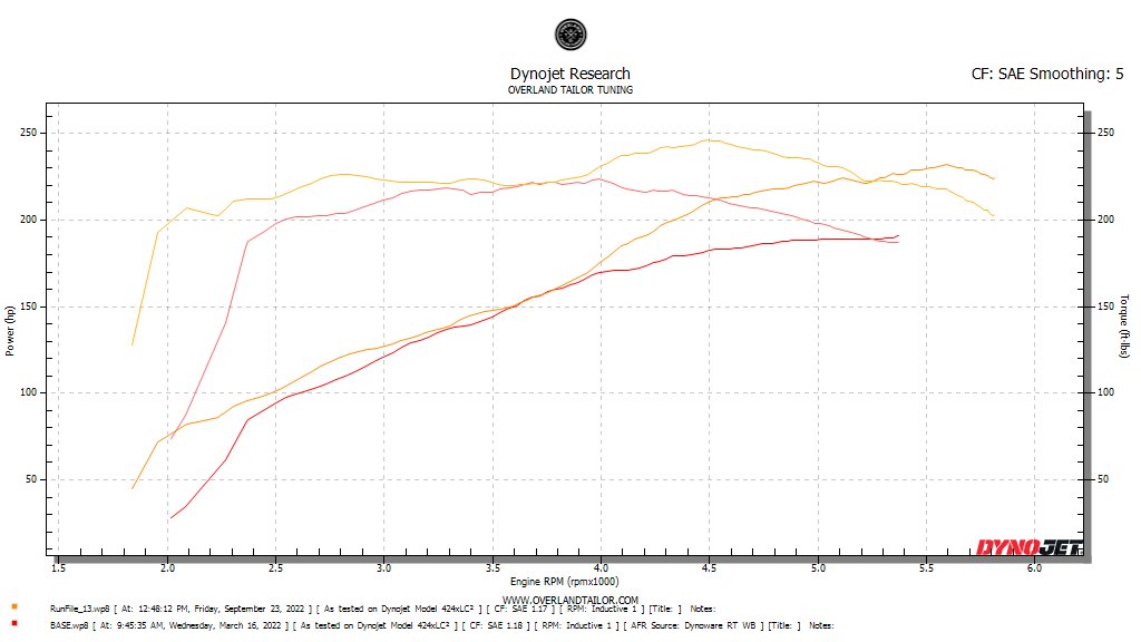

    Stock 2020 4Runner (Dual VVTi) vs Stock 2014 Tacoma (Single VVTi)

    Wasn't trying to answer that question, because I don't have the answer. But it's something I too contemplated when I had my '15. I was always curious about the output, figured someone else might be too and figured my time and money to dyno the vehicles could save someone else the trouble.

    I never really knew what the 4.0 4Runner dual-VVT could do as compared to it's almost-twin in the Tacoma. The diagram answered the question for me: If I'm reading the lines correctly: More power and low-end torque earlier in the rpm curve and a quick climb to the top, and end up close to each other at the finish wind-up rpm's.
    So: worth doing if it was a was a direct swap, not so much since it's not. Thank you for posting it! :thumbsup:
