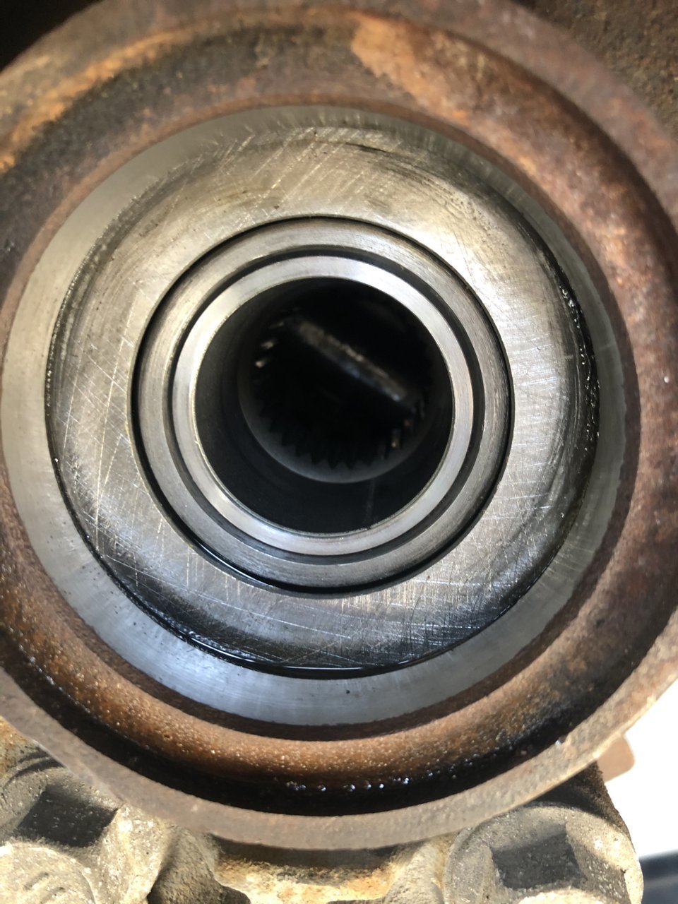

    recently did ECGS bushing
    have done it before successfully
    but have a front end noise that may or may not be related. Naturally, I’m second guessing myself.
    tempted to pull everything apart to have a look. But also no because that’s a lot of work and I trust myself.

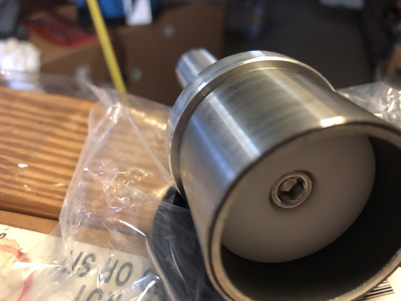

    that being said, is their install tool foolproof? Instructions state drive seal to flush. I did that, until the sound gave off a characteristic change letting you know it’s done and flush.
    on top of that, it appears the diameter of the tool is wider so that it would do exactly that. Drive the narrower bushing until it is flush and then basically stop being able to go no more. Making it basically not possible to put it too deep when using their tool.
    just trying to confirm this.
    otherwise re:noise diag, going to flip the front flange of the halfshaft 90deg see if that changes anything, and double tech torque on some bolts in the area to make sure there’s no resonant frequency noise.

  9. Mar 23, 2024 at 2:02 AM
    #89
    bkhlrTaco's
    bkhlrTaco's “expletive deleted”
    Jun 16, 2023
    #426934
    6,416
    Brian
    Eau Claire, WI
    2016 OR AC MGM
    I think it'll only go in so far anyway before it hits the lip inside the diff.
    Mine wasn't quite as far back as yours but it was mostly flush and couldn't go back anymore.
    As was mentioned you can hear the sound change, or the feel on the install tool, when it's bottomed.

    Yes, the tool is foolproof.
    The lip on the tool will bottom out on the differential.

    got it. I wonder if anyone knows what happens if you hypothetically hammer the tool too hard. I wouldn’t say I did.
    like what is that second ring around the ECGS? Moveable or non movable? I have an extra LSD I’ll look at and see if I can see.
    basically in high gear immediately off throttle for a second or two, I get kind of a whine noise
    Almost like what you hear all the time in a race or rally car with straight cut gears
    And a bit of vibration
    working on diagnosing it
    Could be normal. Could be something else.
    I’m going to start with flipping my front propshaft connection 90 degrees on the witness pattern to the diff flange and re evaluate. As well as fully torque to spec the front diff mounting bolts at the brackets to the truck end. As I got them gutentight but not actual torqued to spec (not much room in there) just to be roadworthy.
    hopefully it’s just that. If it’s loose enough to create a resonant frequency through the truck especially with solid mounts.
    if there ends up being a problem with the front diff (just had it regeared) not the end of the world. Rear diff main drive unit would be worse.
    once all that’s done to rule it out of the equation might swing by the regear guy and ask what he thinks and if it might have anything to do with front diff. Besides regear it’s otherwise stock open diff unit with unknown history. So while bearings, ring, pinion were replaced, there’s still stuff inside that’s original.

    The outer ring with the lip on, is harder than the inner ring.
    It's basically there for you to "hammer" / tap" on it, and to add rigidity to the bushing.
    The inner ring is bronze impregnated IIRC.
    I suppose you "could" hammer on it too hard.
    But the only way to do that is if the bushing was misaligned and getting stuck while going in.
    You'd likely know it, as that lip is fairly thin, and you see it peening out.
    The noise you describe sounds like gear wine to me.
    In some cases, whine can be normal. But not typically in passenger automobile.
    I don't think your noise is being caused by the ECGS Bushing. I'd say you got it in just fine.
    If the axle slid into the differential easy, you are fine. :thumbsup:
    When I say "slid in", I mean it went into the bushing easy.
    Not that the axle "locked in" easy. Sometimes it can take a bit of persuasion to get the axle in. (Even more so if you haven't done it a few times)
    Lube up the axle, slide it in and out a couple time to get the seal and bushing lubed.
    I then "just" get the axle started in, and SHOVE IT IN. The momentum of the axle usually "pops" the C-clip in:thumbsup:
