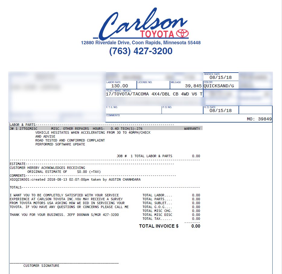

    I thought the post from Ruggybuggy meant that a NEW or revised TSB was out that covered the MT.
  2. Aug 16, 2018 at 7:20 AM
    #762
    tonered
    tonered [OP] bartheloni
    Sep 25, 2017
    #231055
    31,314
    tony
    Lynnwood, WA
    He was saying that tongue-in-cheek. It is the improved TSB, just incorrectly limited to the AT.

    Technically yes, it is for the MT, but in the TSB its listed for AT only. That's why so many folks here are having trouble getting their dealers to flash it.

    After driving for a day, WOW, this is what a manual truck should drive like! No bucking, no surging, no nose-dives, no bullshit!
  6. Aug 16, 2018 at 7:47 AM
    #766
    Zoop
    Zoop Well-Known Member
    Oct 27, 2016
    #200797
    470
    Some have been asking us to post service invoices to try and back them up at their dealer, here you go! @Rujack
