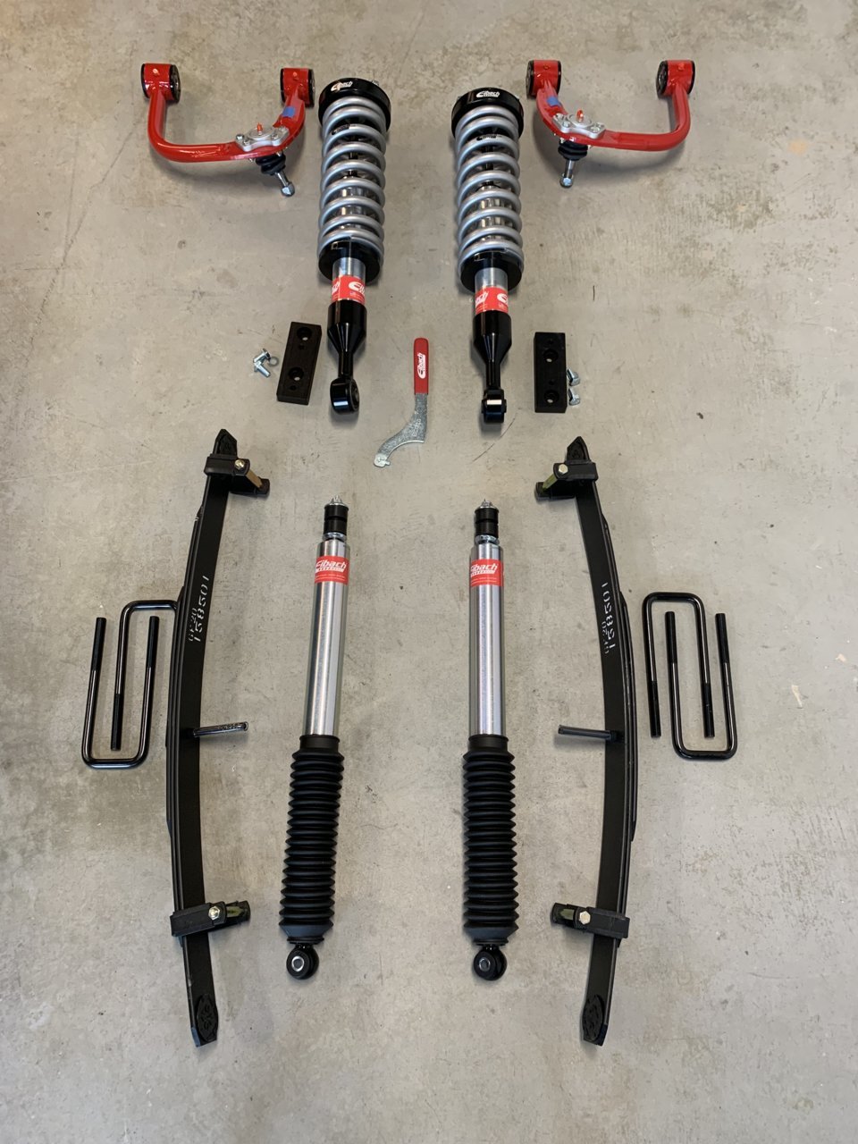

    Finally got my 2.0 Coilovers today!
    All complete and ready for install!

    I've ran the stage 1 eibach kits and Bilsteins 5100s and MUCH preferred Eibach over the Bilsteins.
    I'm hoping the stage 2 coilovers are even better than stage 1... I actually have a full set of stage 1 in my garage now... But decided to run stage 2 this time and ordered them, front and rears, last week from Eibach.
    Looks great.
    I'm going to do similar.... But also do a front diff drop and the ECGS bushing at the time of lift install as well...

    Cool. Why are you doing the diff drop and bushings? Just to be safe or do you know it needs it?

    IIRC you don't need to do a diff drop or even ECGS most the time if you aren't surpassing 23+

    Diff drop is to correct CV angles, even an inch of lift changes the angle... You can likely go a long time without having issues if you don't offroad often, but it will create increased wear. Angles are important.
    The ECGS is a fix to a common issue with lifted Tacomas and happens quite a bit actually. Check this thread, it includes a poll...
    https://www.tacomaworld.com/threads/needle-bearing-failure-with-lift-how-many.486735/
    Can you get away with not doing these things? Sure... But I'd personally rather not chance it and have everything done while it's all pulled apart anyways.
