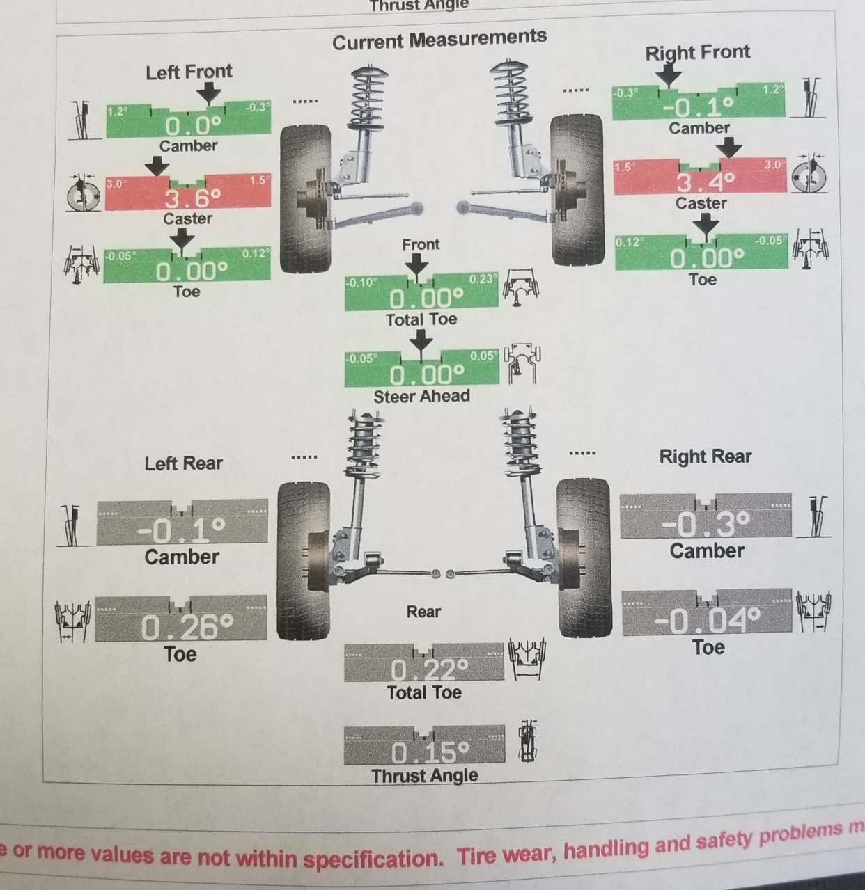

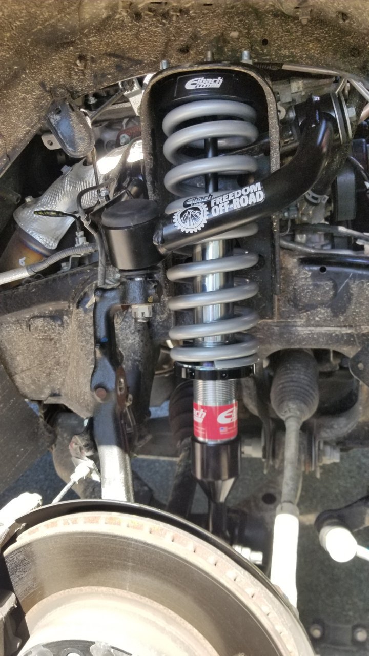

    I am using the Freedom Off-Road UCA with the Eibach 2.0. Was able to get the allignment numbers I wanted pretty easily. Rides great, no rubbing on CMC around town, but can tell if the tire got stuffed on the trail, it would probably rub.
    I'm running 285/70/17 with a 17x8 -10 wheel.
    Also. The coil overs have a 1/4" spacer on passenger side and a 3/8" on drivers side. I'm around 2.5" up front.
    The UCAs use factory style bushings and non specialized ball joints. Was going to go SPC, but so many failure issues with new design.
