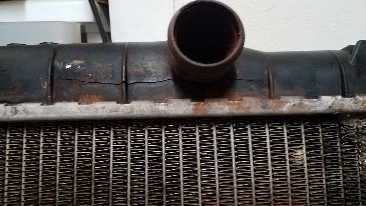

    So, my radiator popped on me on the way home from work this week.
    Good thing I had already recieved the new radiator I was planning on installing.

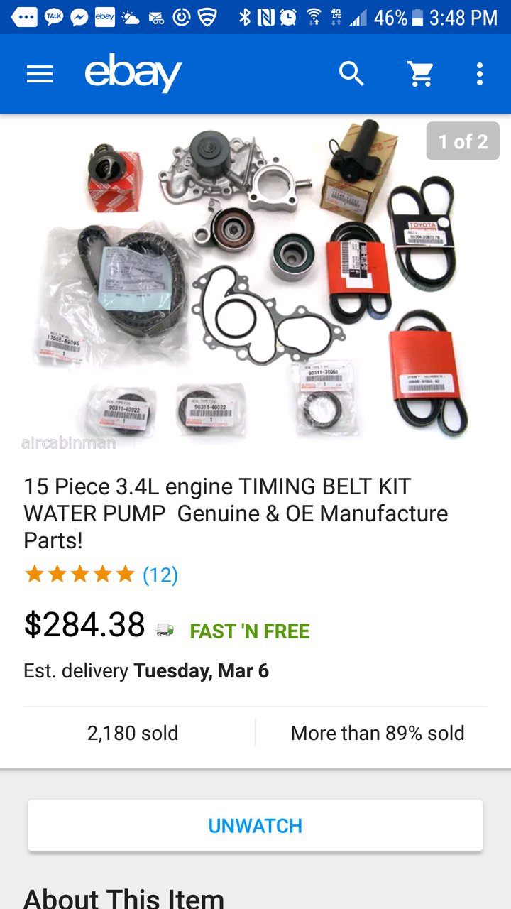

    So I ordered the parts from Aircabinman for the Timing belt/Waterpump etc... I was planning on doing it but my truck moved the plans up.
    Also ordered the Fan Support Bracket and Fan Clutch from Rock Auto. Figured while I had them off, to do the other work, I might as well replace them.
    I posted a write up of some of the things I encountered, and maybe some humble suggestions in a thread here.

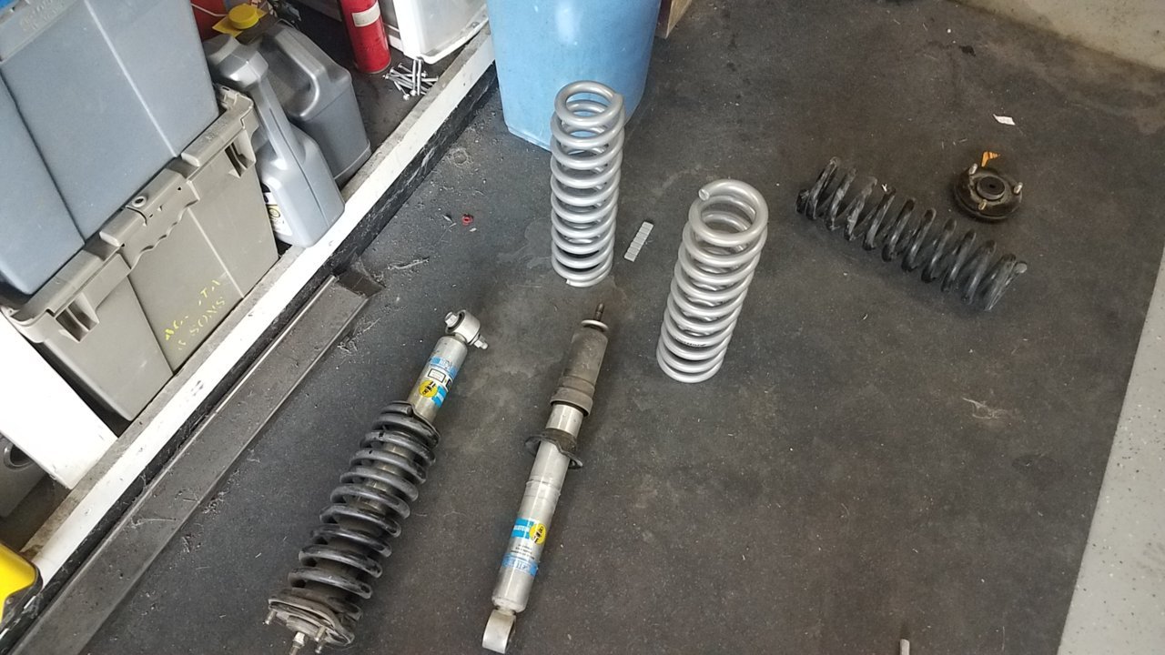

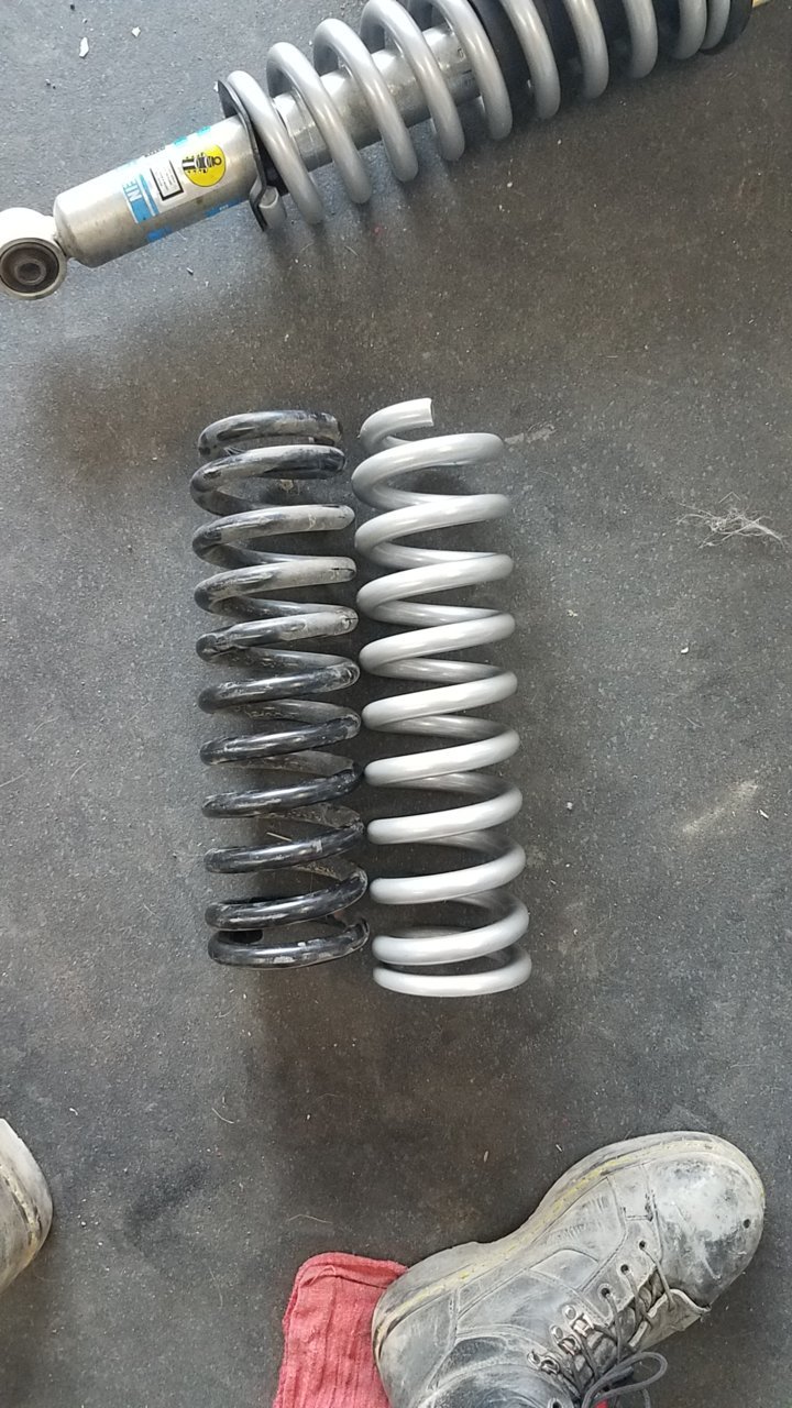

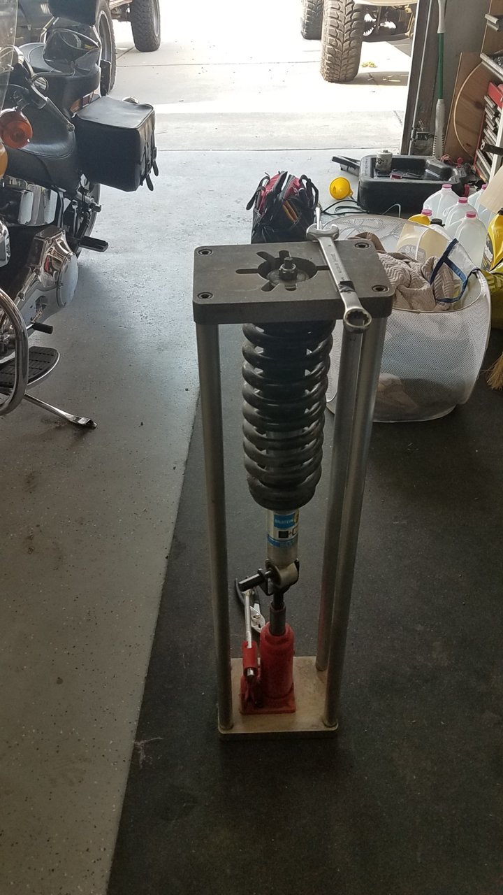

    So... the wheel and tires showed up when they were supposed to. But the front coils didn't. After some scrambling, looking for something that will work for the weekend, I was able to get a set of Bilsteins with 620# coils on them from @FirstTimeFirstGen. That way I could get the lift done, fit the wheels/tires and get ready for the 209 TacomaWorld day trip on Sunday.
    For hour round trip drive to Sacramento put me a bit behind schedule. Swapping the Bilsteins out wasn't going to be a problem. But the rear lift involved removal and complete disassembly of the leaf packs to add a 5 lug leaf... to make a poor man's progressive leaf pack. Luckily @foxrcing07 and @CalTacoma09 were gracious enough to lend a hand and help work on my truck past midnight to get it lifted.
    Here's how it turned out. (pic from the next morning)
    unstpible, TrentonTDG, 970btu and 3 others like this.

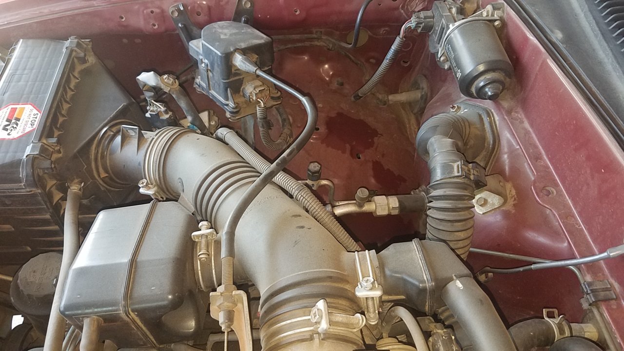

    Sunday I replaced the rear diff fluid and ran a breather to the high point under the hood. (I'll also splice in to the hose for the front diff when I do the 4x swap).
