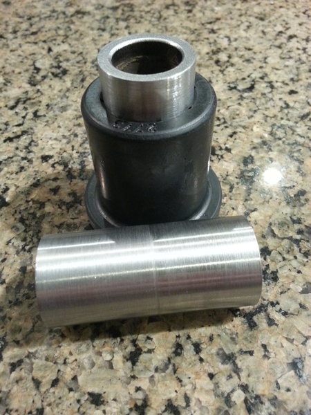

    Pop rivets and JB Weld.
    Thanks for taking the time to document everything with pictures!
    Just a heads up for anyone doing this with MOOG bushings currently installed:
    The smaller bushings inner metal sleeves are too large in diameter to fit through the ES polyurethane bushing. I had to turn them down on my lathe to make them fit properly (1.181" OD). Also the washers don't need to be ground off to be removed. Just use a punch or cold chisel and tap around the edge to wiggle it loose.
