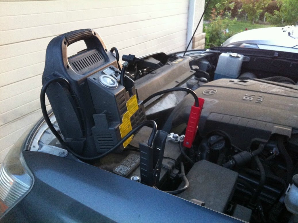

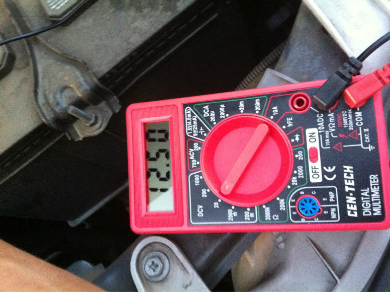

    I cleaned the terminals really good with a brush and I also cleaned the metal round clam wires that fit the batter terminals
    ok so I got a volt meter and tested the battery and it read 12.5 as shown
    and then I started the engine and this is the sound I get. I have a video at this link
    http://www.flickr.com/photos/94890460@N05/8644748384/in/photostream/
    and then I hooked up the jump starter
    and this is how the engine sounds. another video here
    http://www.flickr.com/photos/94890460@N05/8643650067/in/photostream/
    My troubling question is that if that volt meter shows 12.5 then the battery should be good. and if the battery is good then why doesnt it start the truck. but when I use the jump starter it starts the truck.

    12.5 under no load doesn't tell you anything.
    You need to measure under load. A battery might read 13.0 under no load, but under load it might dump to 9 or even lower if it has a bad cell.
    Gets hot in Fresno, heat is a battery killer.
    3 years is a short life, but I would not expect more than 4-5.

    deffenity the sound of a low battery on the 1st vid, battery might hold 12.5, but has bad cells and when you hit the key, not enuff ass = no start, load test at napa or autozone would tell you more than likely your battery is no good, hard to tell by the one pic, but appears the side closet to the fender has leaked acid....

    12.5 DOES tell you something but if you're battery is charged and the terminals are clean and you're still having the same problem then... (however had you had very low voltage then you'd need a charge and that's what that tells you -- and possibly that something is drawing it down. Without voltage it doesn't matter how many AMPs your battery can give theres no pressure and you'd need to charge it before you could do anything else)
    Seems like a shorted cell to me, check battery voltage while having someone crank it. Shouldn't fall below 9.6 more or less but I bet it drops to almost nothing.
