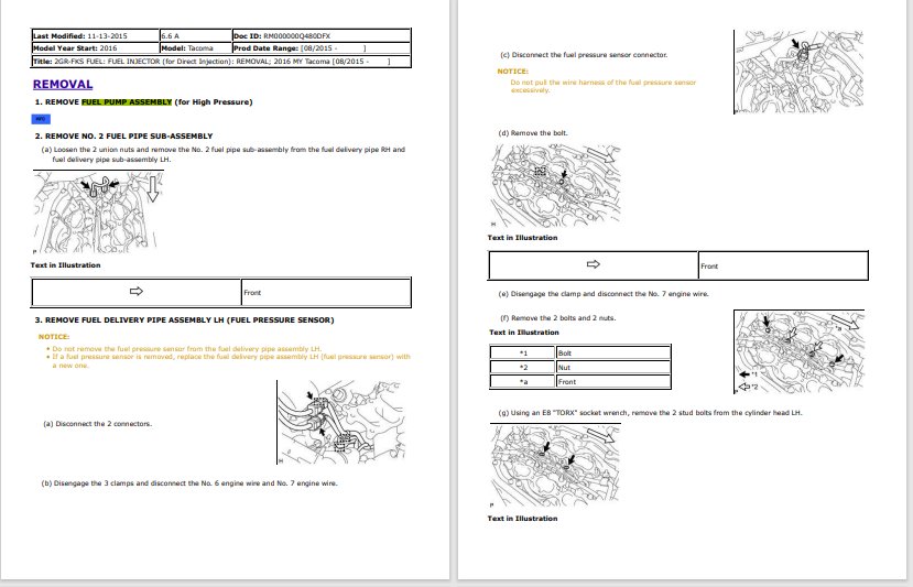

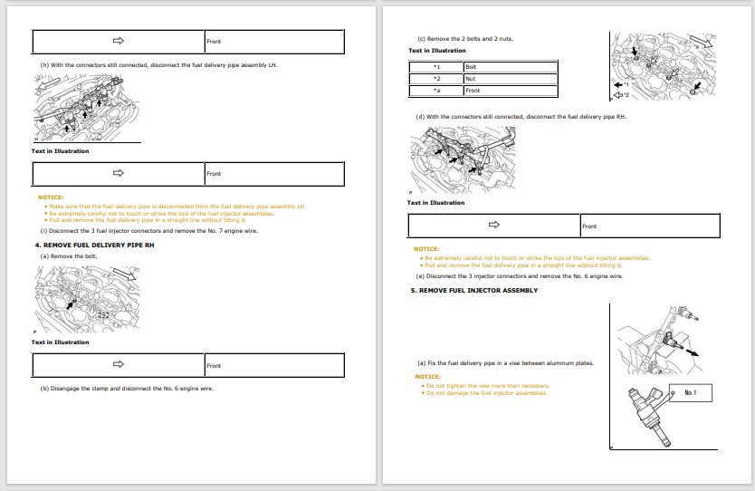

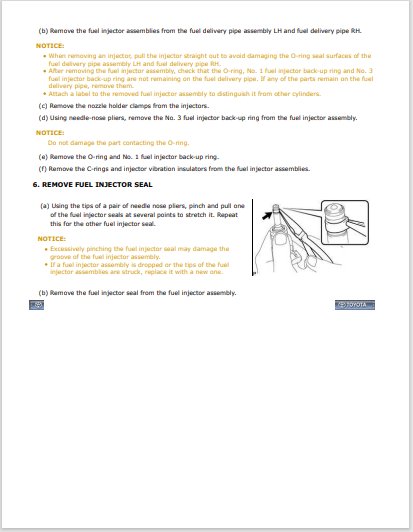

    Do you have information on removing the direct injector? The psi makes me nervous.

    Make sure you get a proper diag first before pulling injectors. I would get a scanner with Toyota Active tests to test injectors. You see misfires in Direct Mode. If the injector is faulty, you should see misfires in Both Mode (above idle and 75% of engine load). Unless the tune altered the injection mode.
    Removing does not seem to be hard, but installation does require special tools to put the seal on injector. And avoid cleaning the tip of the injector.
