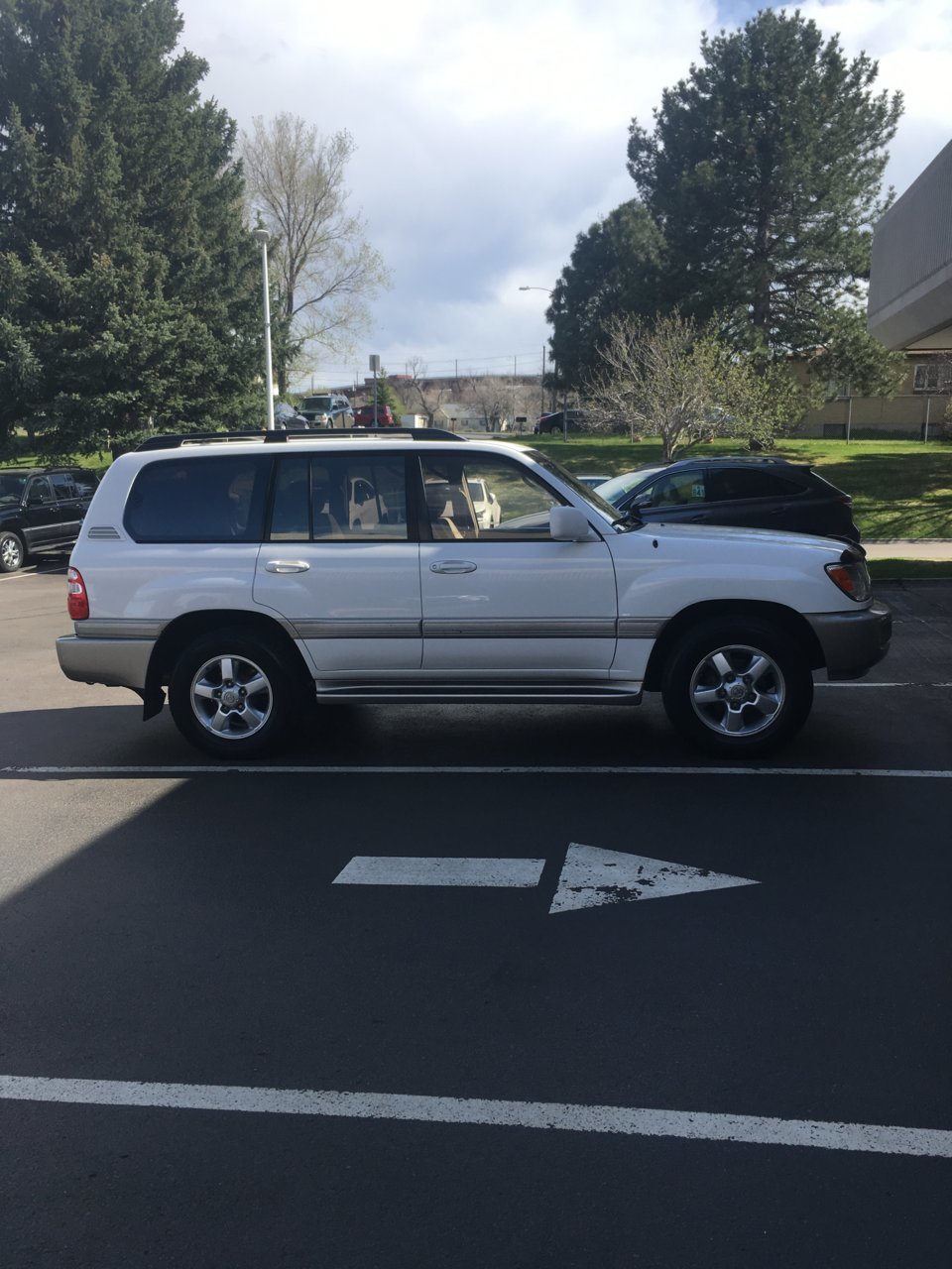

    Nope, no build thread yet. Just this pic from the day I picked it up. So far I’ve removed the running boards and replaced the dreaded heater tee’s.

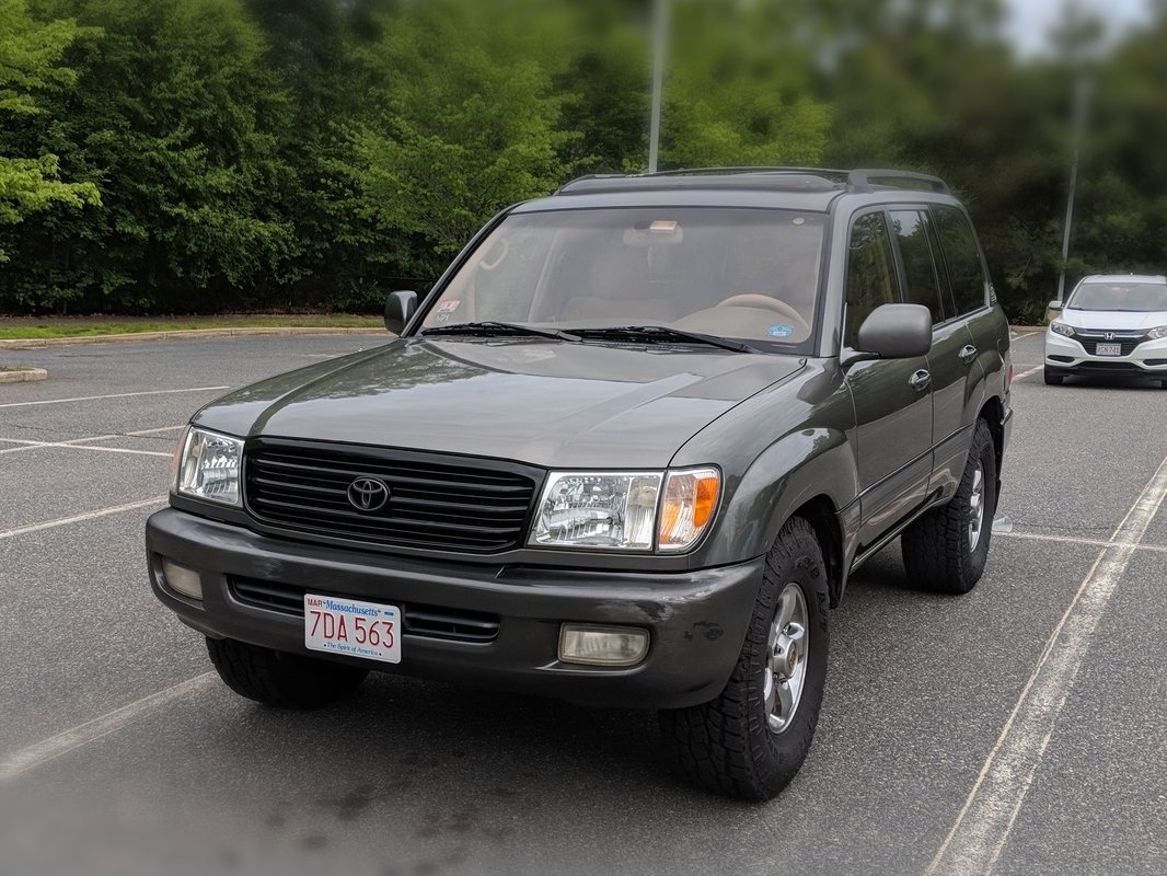

    Thanks, working currently on the transformation from a grocery getter to what a friend calls my ,"Man Van" and hopefully a very capable overland rig!:thumbsup:

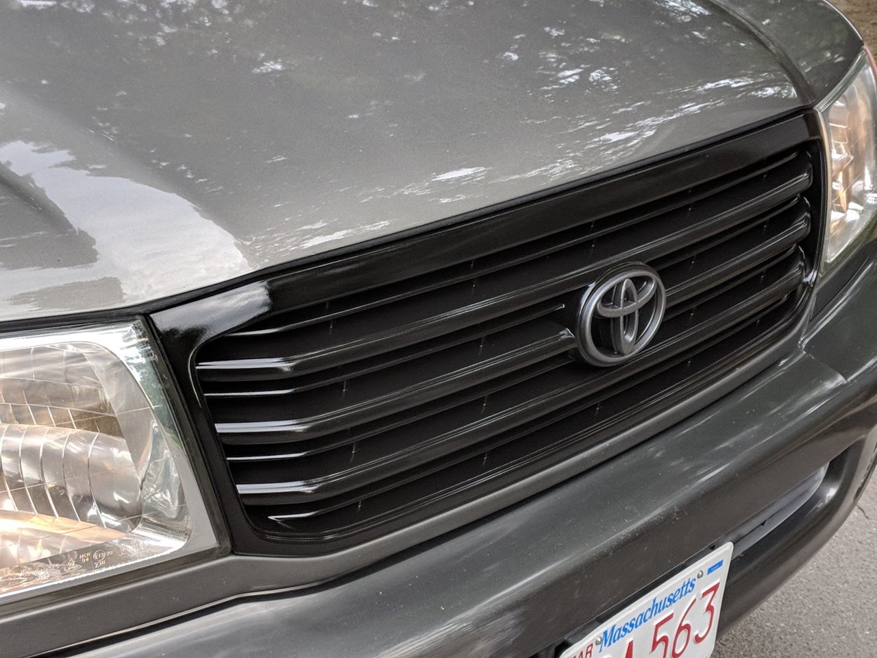

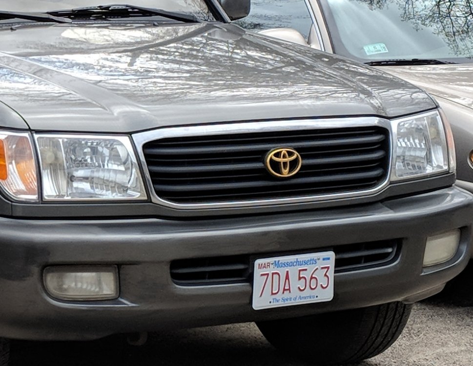

    Gave the grill a new paint job last night. The faded black and gold emblem just wasn't cutting it anymore.
    Before
    After
    I know the front bumper needs some attention, that will come soon enough.

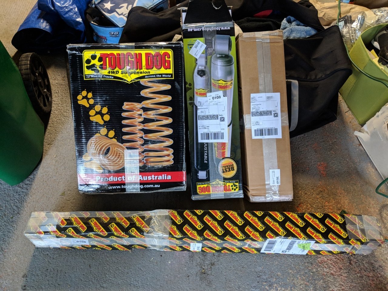

    Some parts arrived at my door yesterday!:D New shocks, springs, torsen bars, and diff drop.
    And then the battery died. I'm not sure if it's an issue with the alternator, or battery or what. I was able to use my trickle charger to get going again, but not really sure where the real issue is. My guess is the alternator. It's sounding different the last couple weeks almost like the engine is working harder. It can't play the radio without wearing down the battery significantly when the car is off....any suggestions?

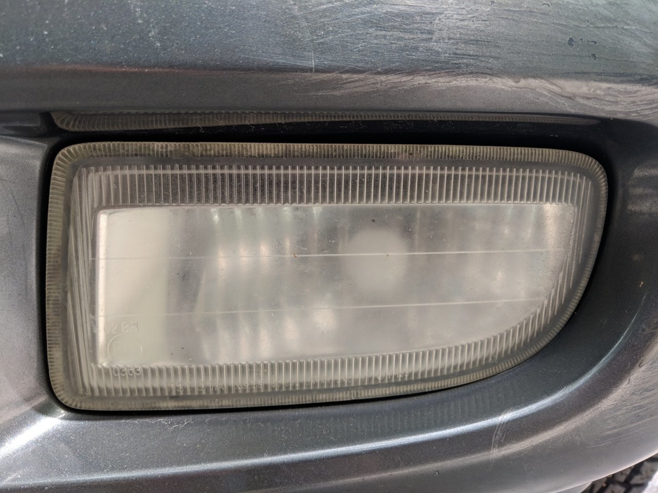

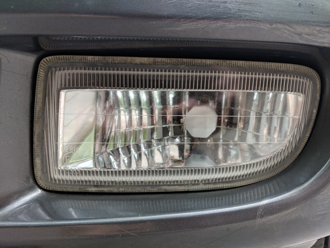

    5 minute fog light fix to clean the hazy yellowing that was going on. Used Meguires Ultimate Compound, and a drill mounted foam buffing pad. Worked way better than expected, they look brand new again!

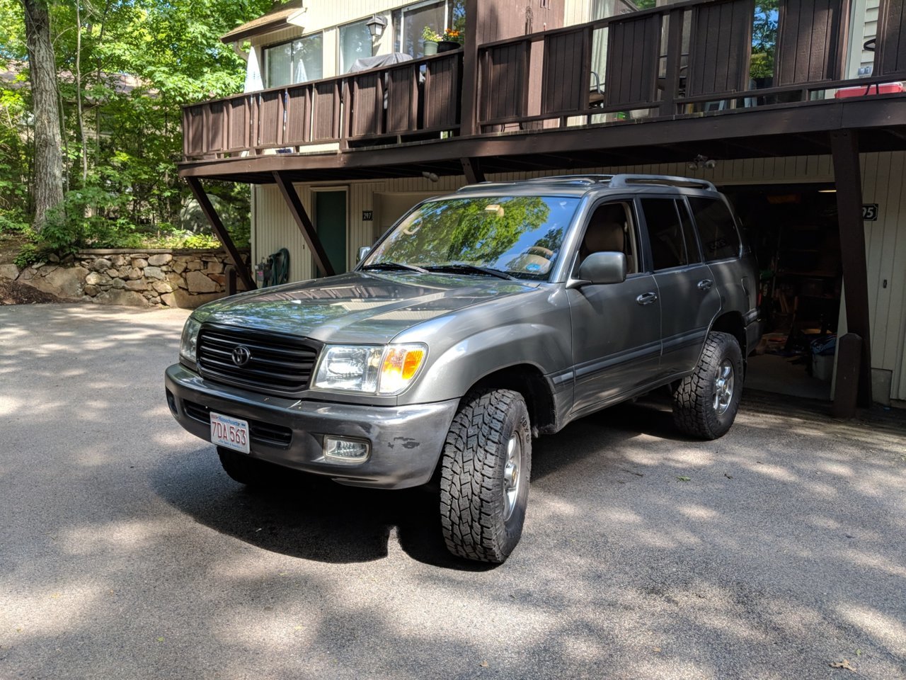

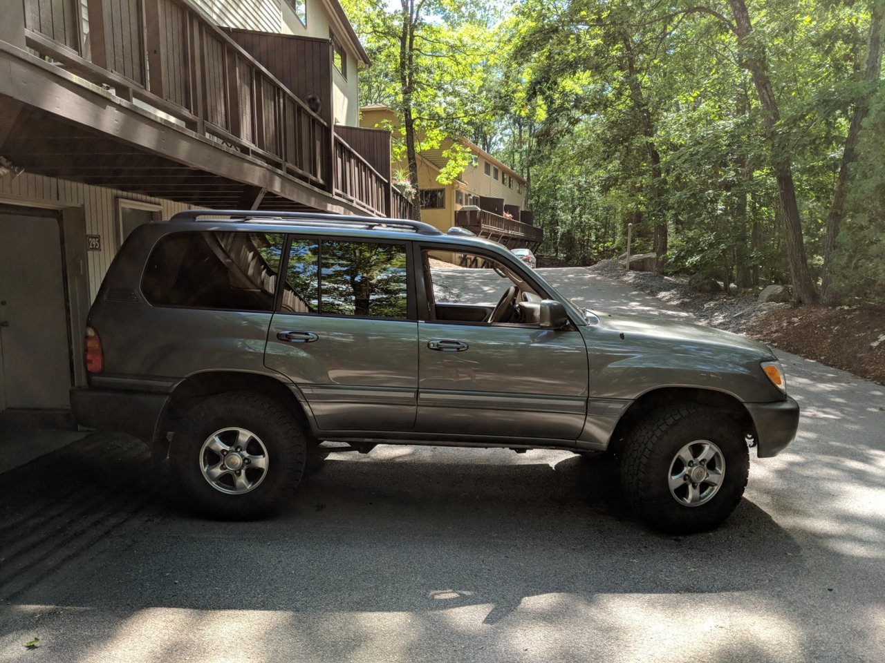

    Lift installed, but i need to make some adjustments to the Torsion bars up front, current drives like crap and sort of feels like this...needs to come down about .5-3/4 of an inch and should be alright, but then have to realign again.
    Looks higher in front than it really is, front tire is sitting in a little rut.

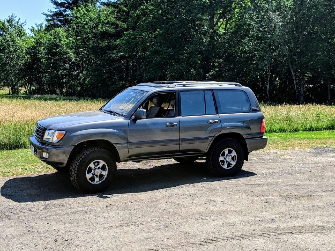

    Lowered the Torsion bars about 3/4 of an inch today and brought it for an alignment. Made a world of difference, the ride is fantastic now! Slightly stiffer than when it was stock but not by much. So happy with the results, but not so much after looking at my bank account after getting all the work done lately. Hopefully I can get some good miles on her before something else rears its head.
