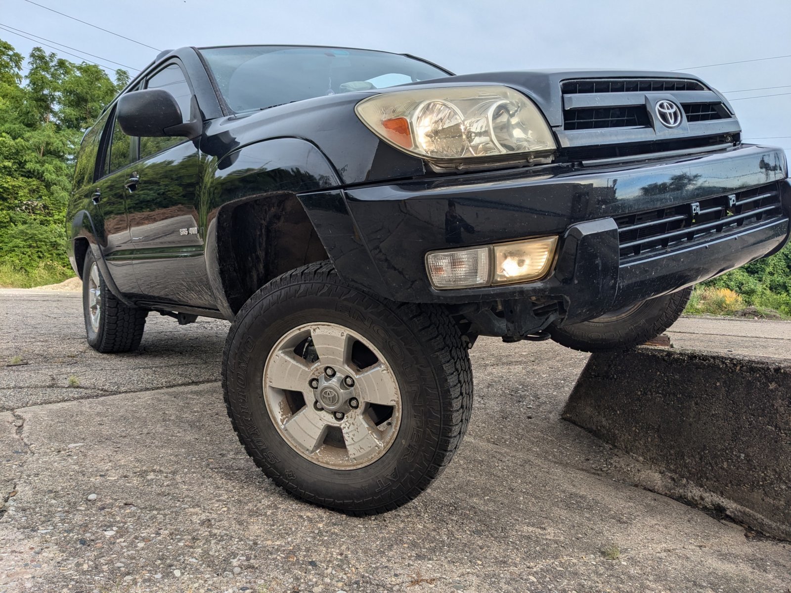

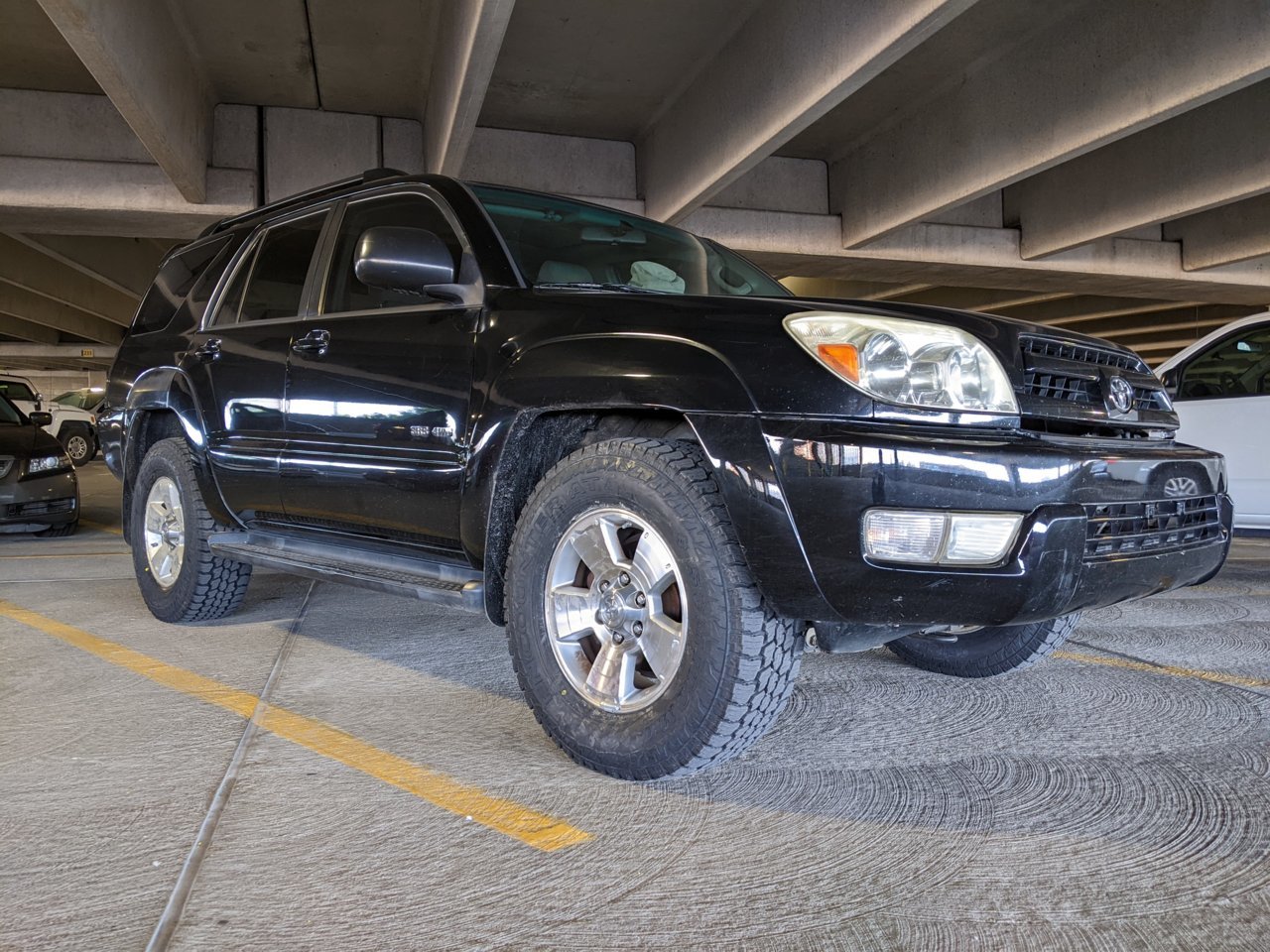

    This will be a build thread/repair log for my new-to-me T4R. Vehicle Deets: 4.7L V8 AWD/4WD, 262k miles. Beige fabric interior in decent shape for the age.
    Current state:
    As purchased, 8/4/2023
    Stuff it desperately needs to be safe to start going places that aren't just work:
    Tires (done, Sumitomo Encounter AT in 265/70R17)
    Fluids, mainly brake fluid(done, OH MY GOD IT STOPS), but it will need diffs/tcase/trans to ensure that stuff isn't ancient, plus coolant, oil.
    Suspension vibe and noise diagnosis/repair (diagnosed, needs sway bar links, ball joints, shocks)
    Halogen bulbs.
    Repairs I'd like to make for my own sanity/light free dash:
    TPMS fix
    Emissions fix (fixed upstream sensor, now get P0420/P0430 code. Next steps: capacitor/resistor mod, minicats)
    Stuff it needs to be ok to start wheeling with my friends:
    sidestep removal (done)
    GMRS and CB Radio
    diff breather extension (done)
    Drift stitch and fully affix the front bumper
    onboard air, or at least a compressor
    skid plates front to rear, probably coastal offroad
    rock sliders, probably 4x Innovations
    OME 885/895 springs(done!) and 90000(done)/60004 shocks
    Long term ideas I want to write down for future thought when the money comes:
    Steel wheels, probably Pro Comp 51 or 97's
    rad rubber splash guards? Mine are falling off.
    Rear bumper w/tire swingout and jerry can storage if I can find one that doesn't kill the tow capacity. I might need to DIY this to ensure it's beefy enough while staying reasonably high clearance.
    front bumper (Hidden? hybrid? grill tube? Full tube?) and winch. I might go hidden winch/recovery plate instead of front bumper, but that doesn't help approach angle and frankly isn't as cool looking.
    Torsens/lockers front and rear
    Long Range fuel tank?
    Here's a little SEO for those asking these questions so hopefully people find answers:
    Do I need UCA's for OME 885? Yes, no, and maybe. In my V8 SR5 4WD I was able to align the truck to factory specs with the factory UCA after installing the 885 springs and 90021 shocks. The 265/70R17 rubs the UCA and frame at full lock on the stock SR5 Wheels. Spacers or aftermarket wheels should fix that. If you have a V6, you might be too light to align it because it'll sit higher. If you have different wheels/tires, it may or may not rub.
    Does a 265/70R17 tire rub on a stock 4th gen 2005 SR5 4runner? Yes it does. The truck rubs the upper control arm and frame when reversing and turning out of parking spots. I suspect the factory +30 offset wheels are the reason. I will be replacing these wheels with something closer to a 0 offset and using wheel spacers to test those fitments.

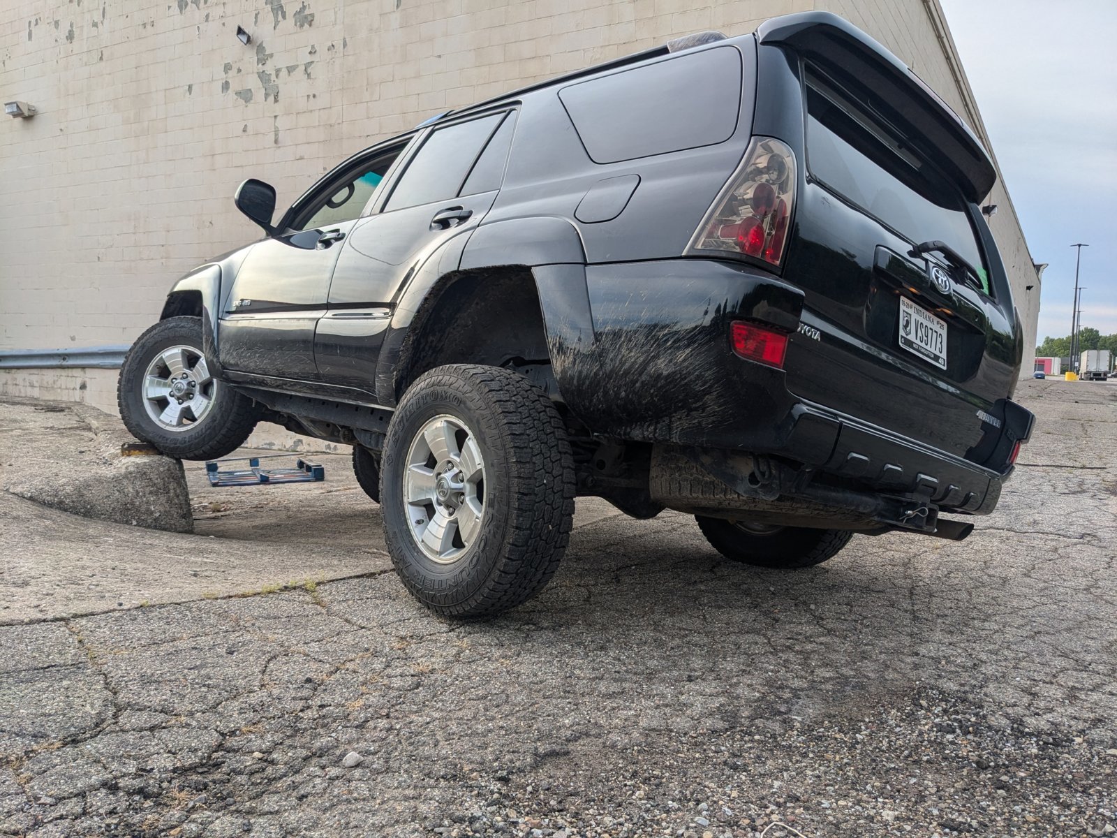

    Sumitomo Encounter AT 10 mile review: they ride well, aren't loud, and look cool. 265/70R17 rubs the mud flap very very lightly at partial lock at low speed, which is easy to tolerate

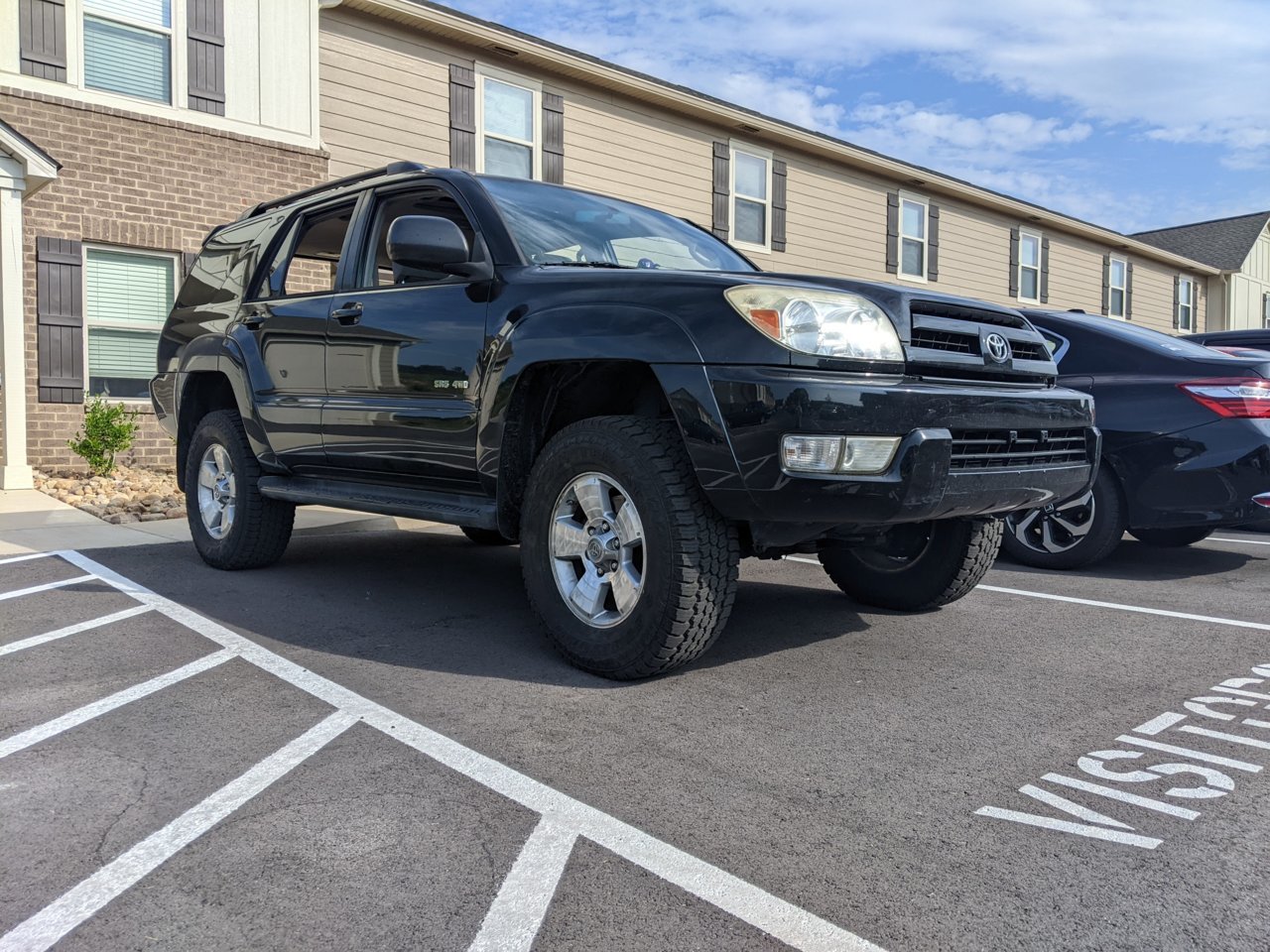

    My buddy convinced me to throw the new springs in and get it aligned this weekend. So I guess I lifted it with OME 885/895's.
    It's way taller. So much taller.

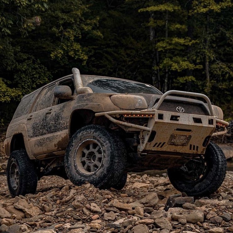

    Uploading an inspiration pic from HCWatson997 over on T4R.org. Main inspirations are the diy minimalist snorkel and the hybrid style coastal offroad bumper.

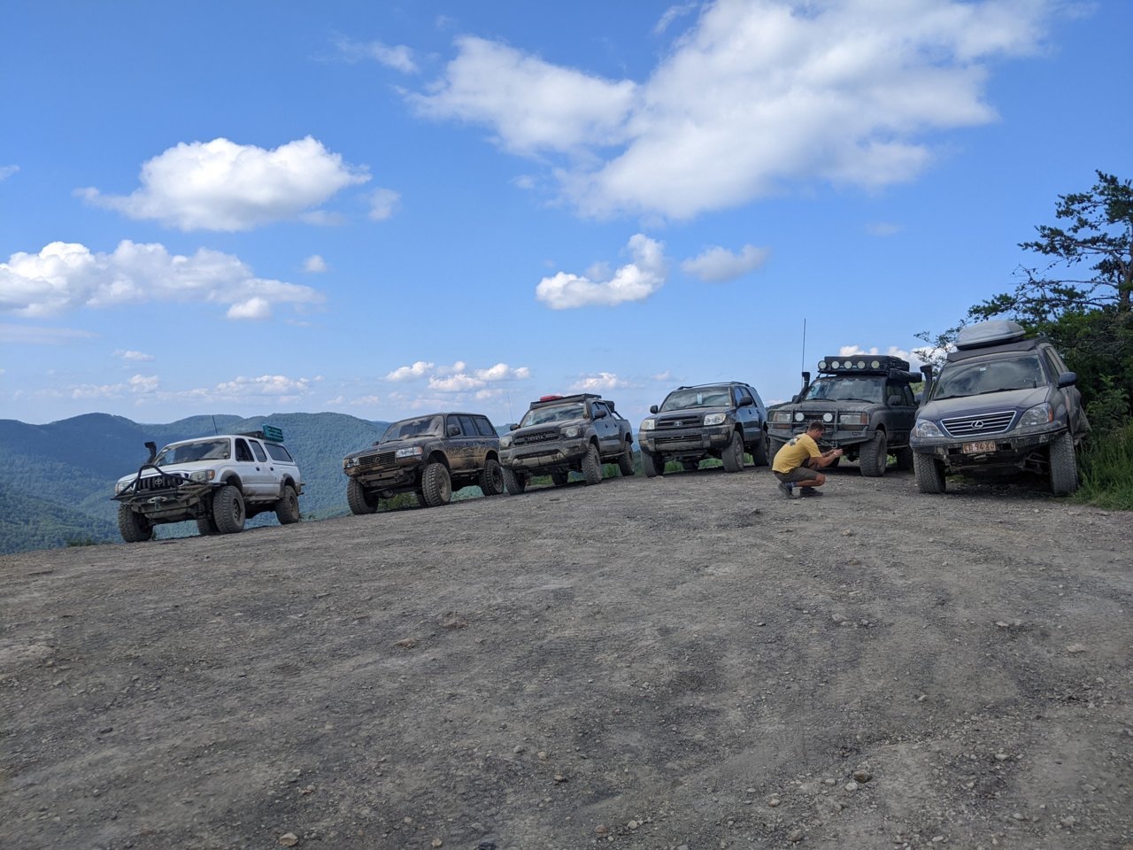

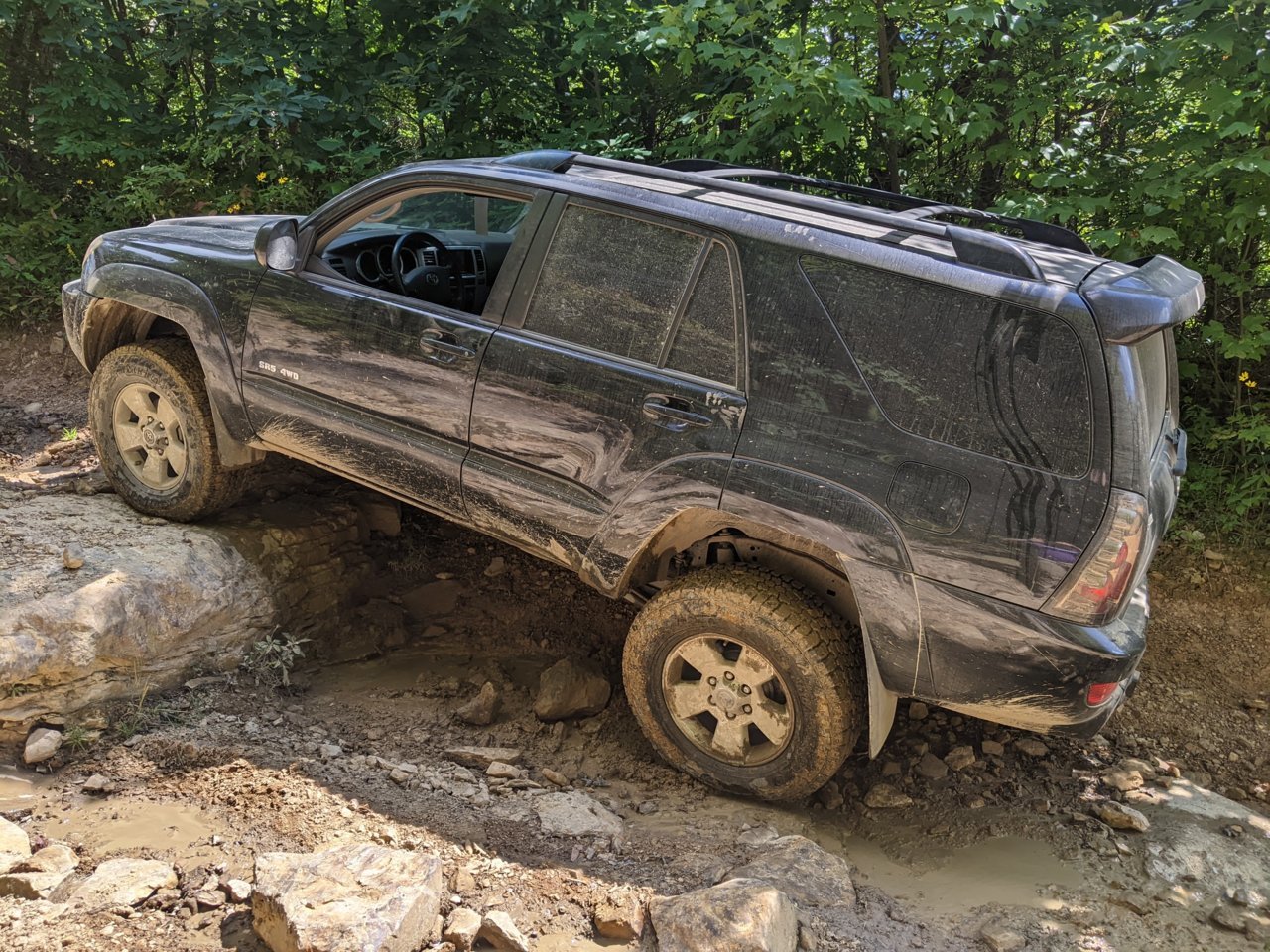

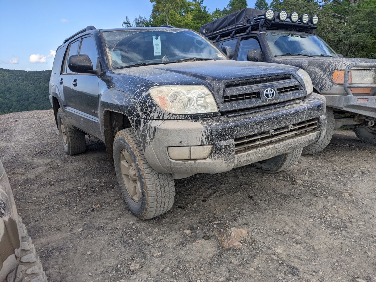

    Adventured to Windrock Park for ATR. Kept up with some built rigs on difficult blues and had a blast. After-action needs: CB and GMRS radios, rock sliders, skid plates, an air compressor and recovery points. Pictures:

    It was a lot of fun to take a 95% stock vehicle down those trails and be basically no worse for wear, and the kudos of wheeling a mild vehicle with wilder ones was nice.

    You're brave without sliders! We went down a bunch of blues and there were several spots I would've caved in my rockers if not for my sliders. I even drug my driver side one over a ledge at one point, rock chips flying!

    It was a gamble for sure, but this group had some seriously skilled spotters. I know I set the frame down at one point, but it was pretty simple driving otherwise due to them. I do need to replace my factory "skid" now as it's hanging by a single bolt, but that's no great loss.
