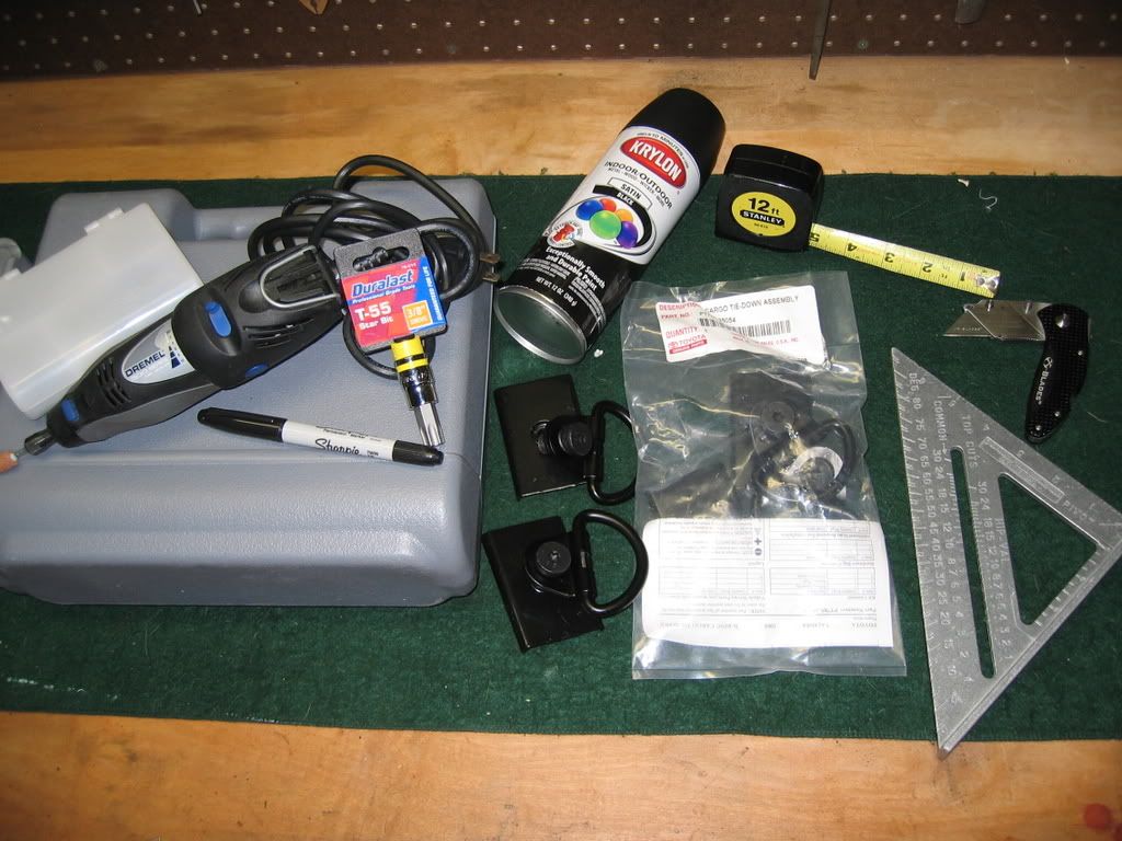

    In the picture it doesn't look like they will fit...

    Yes, they will fit but you will have to trim a bit off the washer on the bed bolts.

    A couple different ways to do it. I mounted mine by knocking the bed bolt out of the washers slide the d-ring on and then put the washer back on underneath the d-ring.

    That's where they are meant to be installed, the directions that come with the d rings tell you the exact measurements to take in order to install them in the sides. I just did this instead of using the bed bolt mod, pretty easy to do but much easier with a helper.
