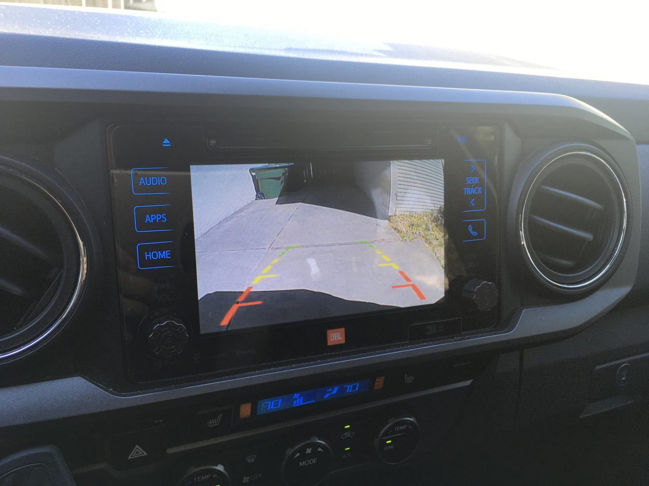

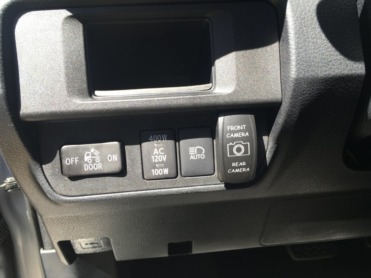

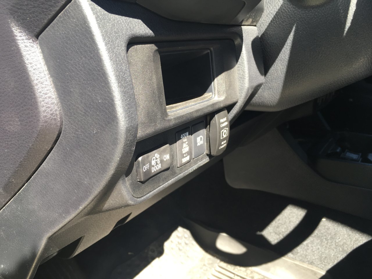

    I just installed the anytimebackupcamera.com system and it’s exactly like JJ’s. I added a front camera and the AOB dual rocker switch and it works perfectly. The switch sticks out more but as I had a blank spot there I leaves the cubby empty for switches later. It’s also so low I don’t easily see it yet it’s easy to find with my hand while driving. I had to dremel a little as the opening is the right size but the very back of the slot is a little narrow for the switch. The harnesses are all plug and play, the relay toggles back and forth so all you do is select front or back. Last photo is the front view and the guideline is 4 ft out

    I have the anytimebackupcamera.com system, not Hoangde. This system doesn’t require any cutting, and it’s one switch that’s ON-OFF-ON. So in the center the head unit operates normally and then switching up or down allows either the rear or front camera to display. I didn’t opt for the Nav Override. The radio plays, phone calls still work, it’s just the screen that changes so you don’t lose any functionality viewing a camera while driving
