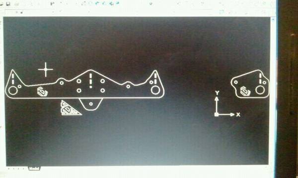

    With our rock sliders
    Designed in CAD and cut on a computer guided plasma table, the frame plates are what sets these sliders apart from the others.
    They are a 1/4" plate that is 100% bolt on! No drilling AT ALL! Using 5-7 factory frame holes, and tying into the transmission crossmember bolt on the bottom. Hardware is included, 9/16" grade 8.
    Tubing is 1.75" .120 wall HREW

    welds look great, i don't think those gussets are doing much tho, not much material there.
    sub'd

    ^X2. Looks good but a full gusset will work a lot better. Maybe weld those over the gusset so its like 3d?

    Something that might help the gussets while still looking good might be to add a diagonal tube on top of the gussets from frame plate down to the leg. It will add a lot of strength and still be able to keep the snazzy gussets.

    Gussets are being redesigned!
