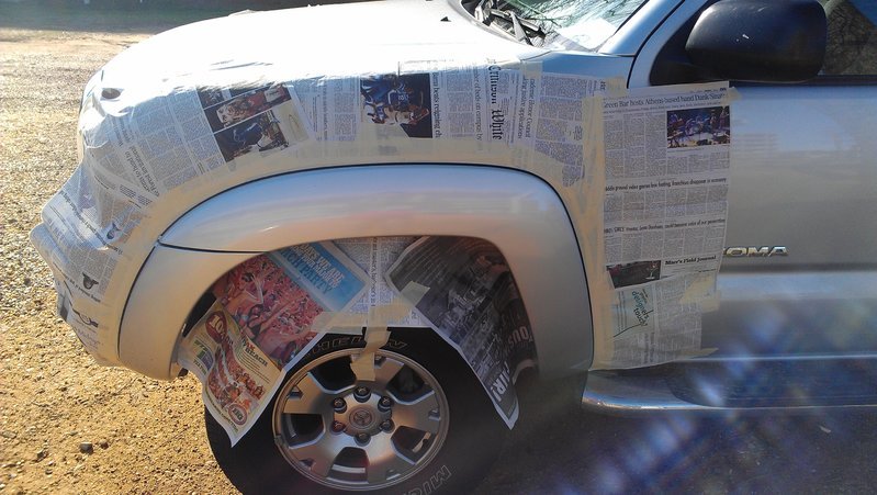

    The derp was super easy. Just make a newspaper/tape blanket everywhere else and spray away.
    Then either take it all off while it's still wet (if you're fast enough; I wasn't) or just lightly run an X-acto over the seam so it won't peel up when you take the masks off.
    I another thing about using derp instead of paint is that it's so easy to cleanup if you don't want to remove the flares. Got some overspray somewhere? No problem. Just rub a little WD40 and good as new.
    If I was to do it again, the only thing I'd change is make my layers a lot thicker.

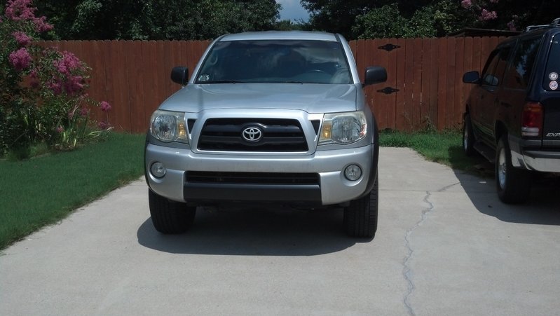

    Duplicolor color match for 1E7 has been really good for me. Used it on my grille. (Pic for reference)

    Yeah that does look really good. What was your process for prep. I've never really painted plastic professionally lol. Metal, no plastic
