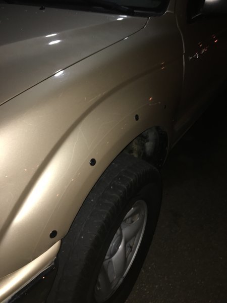

    I saw a thread from 2013 where someone took there flares off and put clips in place.. so I decided to give it a try on my 1st gen. I feel it turned out well, only thing that bothered me was the line in the paint from where the flares where, but I feel it came out well.
    IMG_0122.jpg IMG_0121.jpgI work at a dealership in the wash bay, so I might try and see if one of the guys who works with me can buff the line out sometime soon.

    Looks good! Can you share what clips you purchased and where? I bought some a few weeks ago and was planning to color match them only to find out that they're too small.

    I used all red clips, but you could use all blue if you wanted it's your preference. Here's the link to the clips (https://www.amazon.com/gp/product/B00BHN2JOO/ref=oh_aui_detailpage_o01_s00?ie=UTF8&psc=1)
    Also used (https://www.amazon.com/gp/product/B00FSY2C2C/ref=oh_aui_detailpage_o00_s00?ie=UTF8&psc=1) these are the washers I used for the project. The clips were a smooth surface after I dremeled them down, so I did not have to use bondo to fill in any holes.

    Thanks. For some reason I thought you used clips with flat tops already and not the actual fender flare clips that have to be shaved down. Guess I'll have to do it this way as well.
