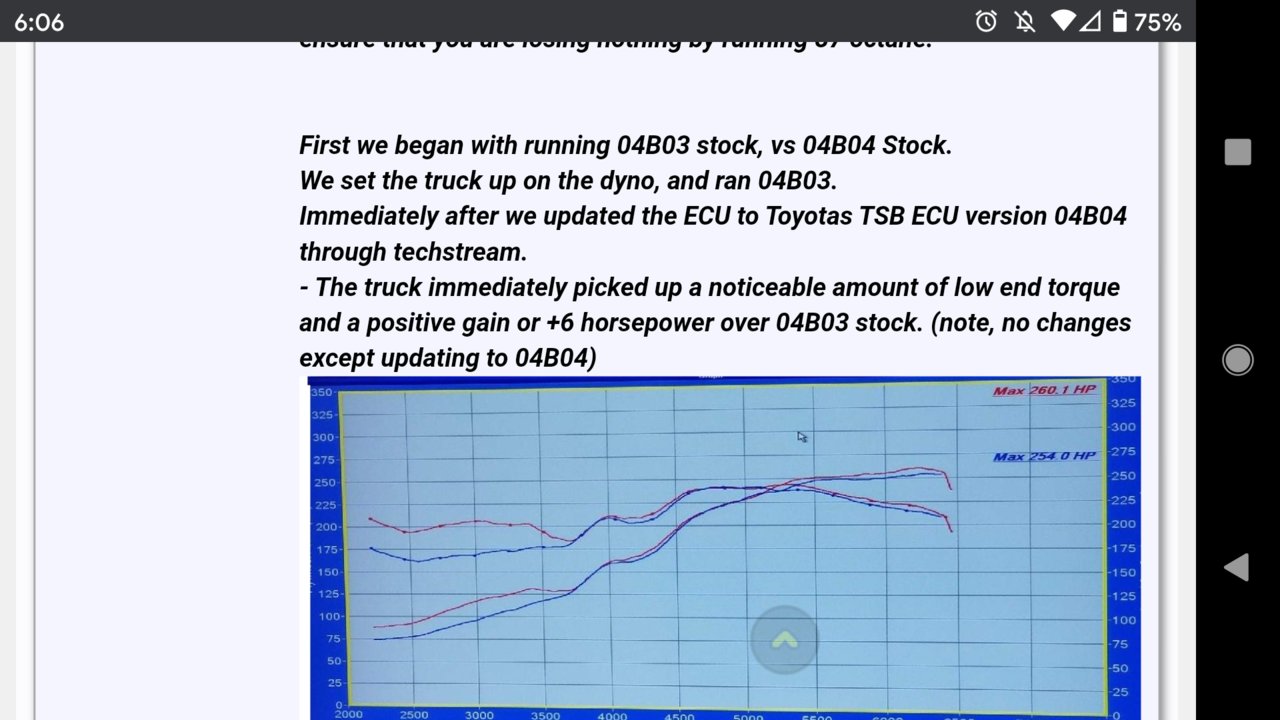

    I could be wrong in this but I thinkkkkk the update adds some mid range power. Let me see if I can find what I think I read.
    Found:
    https://www.tacomaworld.com/threads/2016-toyota-tacoma-ovtune-1-05-tune-development-thread.495735/
    CHenn23[QUOTED] likes this.
