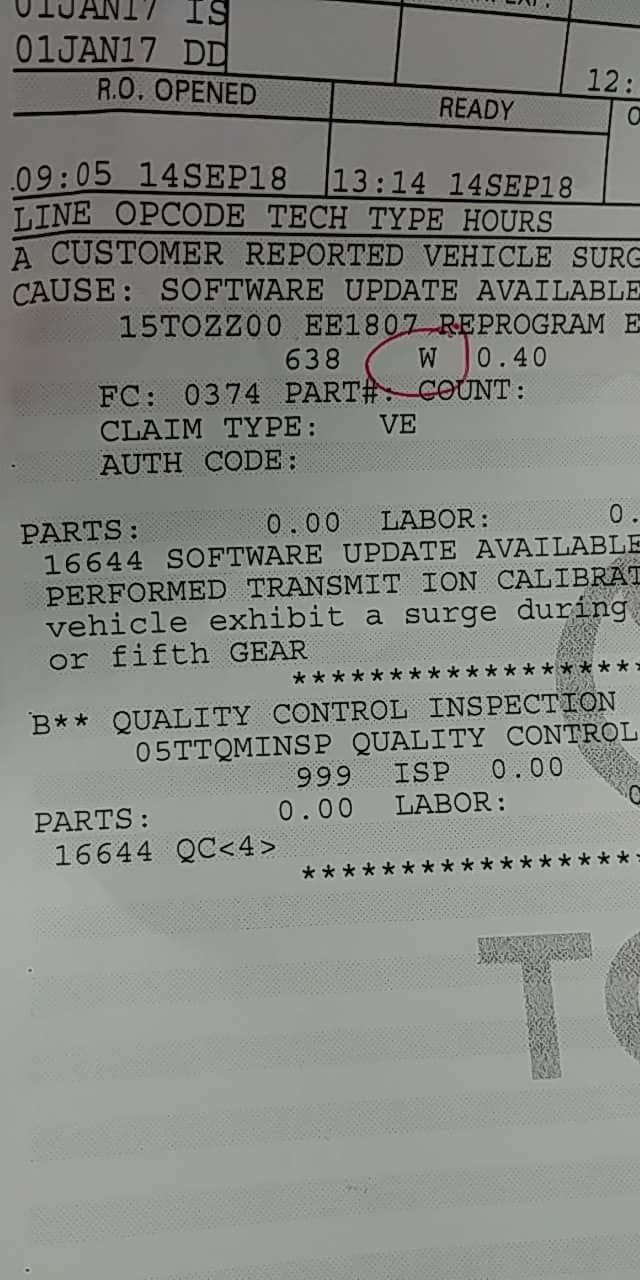

    AD2D49D5-4622-4BB7-86A4-D49746C96FDB.jpg I just got back from Beaman Toyota in Nashville trying to get TSB 0058-18 or 0062-18 done. They said that the master tech could not duplicate. How come everyone that rides in my truck asks what’s wrong with it, but the so called master tech couldn’t! They said use premium fuel and use ECT! What a joke these guys are! Any Nashville guys in here know who will do this? It’s really sad that I used to work there as a heavy engine repair guy! They also changed the wording on my original complaint, it used to read, stumble and hesitation from 40 to 50 mph! They stripped that part out of the document!
