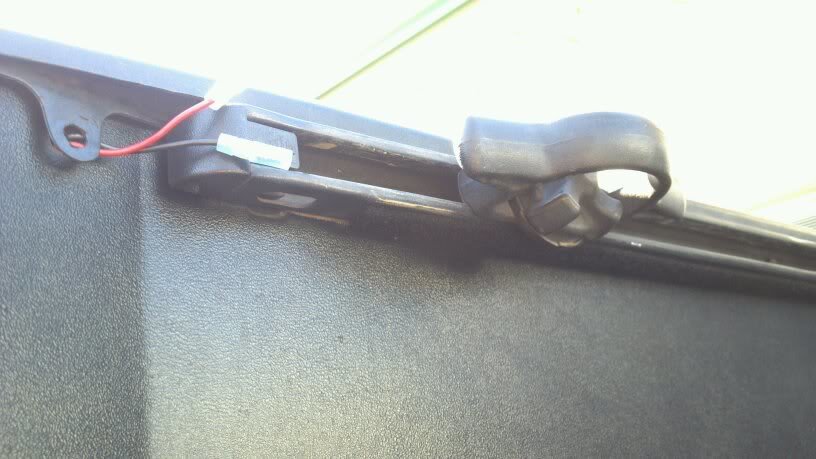

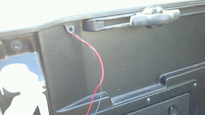

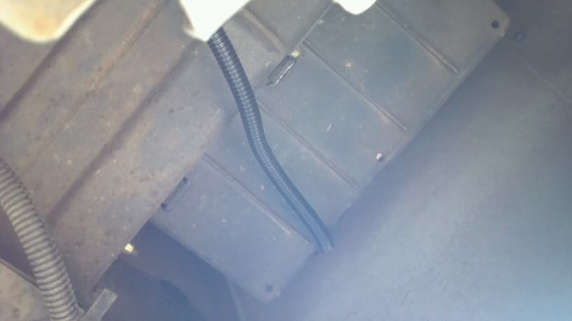

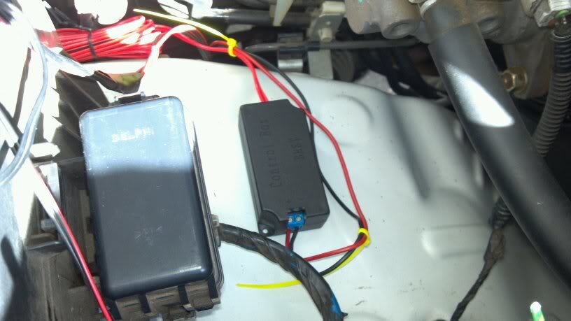

    I ran the wires from my remote control unit up by truck battery, ran wires from engine bay down thru my chassis and up thru rear fender well area and thru the hole at the end of our built in rails in the bed.

    And you used on full roll around the top of the bed? Or did you cut it?

    Cut about a foot off (iirc)
    So you wanna start at the wired end and wrap it around so when you get to end of bed you can snip it off at one of the "CUT" marks in the led strip.;)

    Any pics of where you went through the firewall?
