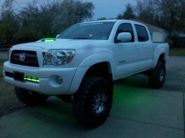

    I have lights under my truck to light the ground at night. Works great for camping and wandering towards it in the dark.

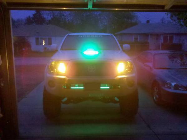

    Yeah. vminnovations on EBAY is a badass company...i've bought 4 kits from them. I had a white kit for the bed of my truck but decided to do the LED ribbon instead. i bought the remote control kit from them that i'm going to use for my bed lights.
    I also have an LED scanner I put in the scoop.

    I thought about a strip or two to light up my grill.
    My LED scanner in the scoop is for when I'm sittin somehwere, i dont light it up while driving but all the other shit is lit up at night while driving.:D

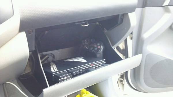

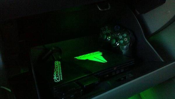

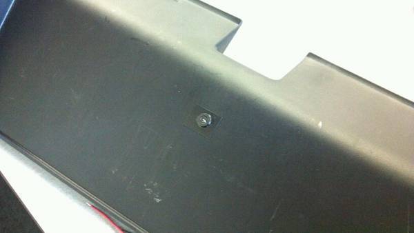

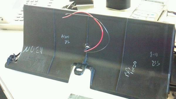

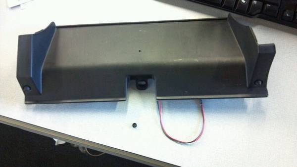

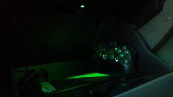

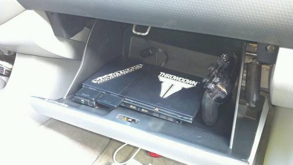

    Did the Glovebox just now. I only used 1 LED instead of 2 because its a small place and these are wide angle LED's. I'll look at it when it gets dark.
    Now I gotta figure out lighter area cubby!

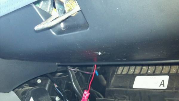

    I opened the glovebox and dropped it down, then unscrewed the 10MM bolt and popped out 2 clips and took out the upper thingy that is above glovebox.
    Drilled 1/4" hole (drill bit grabbed onto the thin plastic like crazy so the hole was a tad bit too big. I put a small piece of electricians tape over each side of hole, razor bladed a cross in the tape and put the LED holder in thru the front and put LED into holder from the back.
    Comes out almost flush....doesnt matter cause you will never see it (but still badass).
    Ran wires to underneath center console where all other LED's are hooked up and then hooked up this LED and put the upper part back in - popped two "clips" back in then screwed 10mm bolt back in
    Turned it on!!!!
    Hooked my Playstation back up -
    Put up sunshades to try to get some darkness -
    You get the idea ;)
