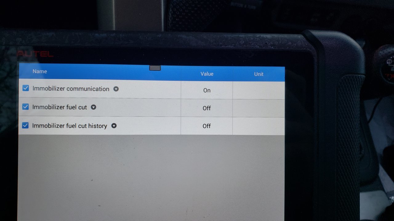

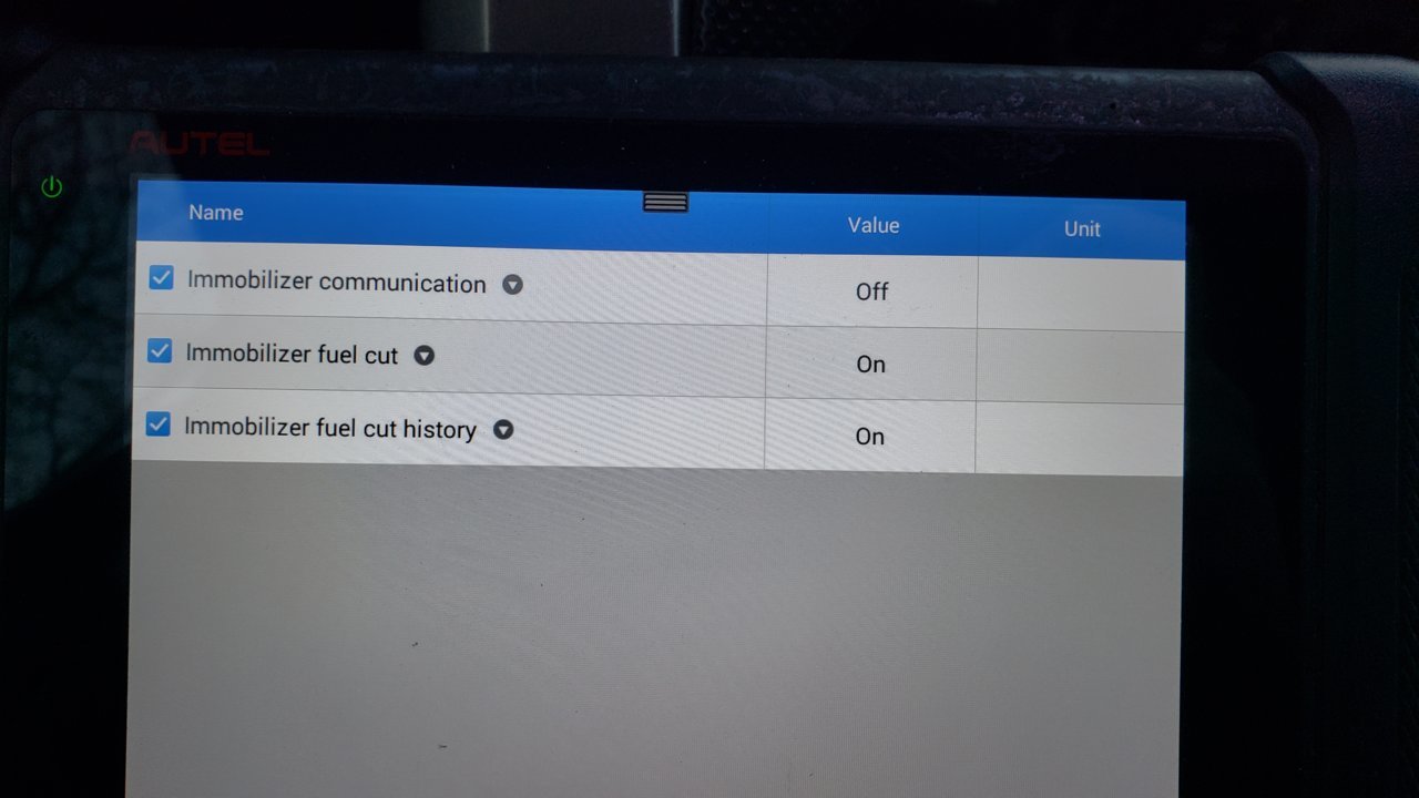

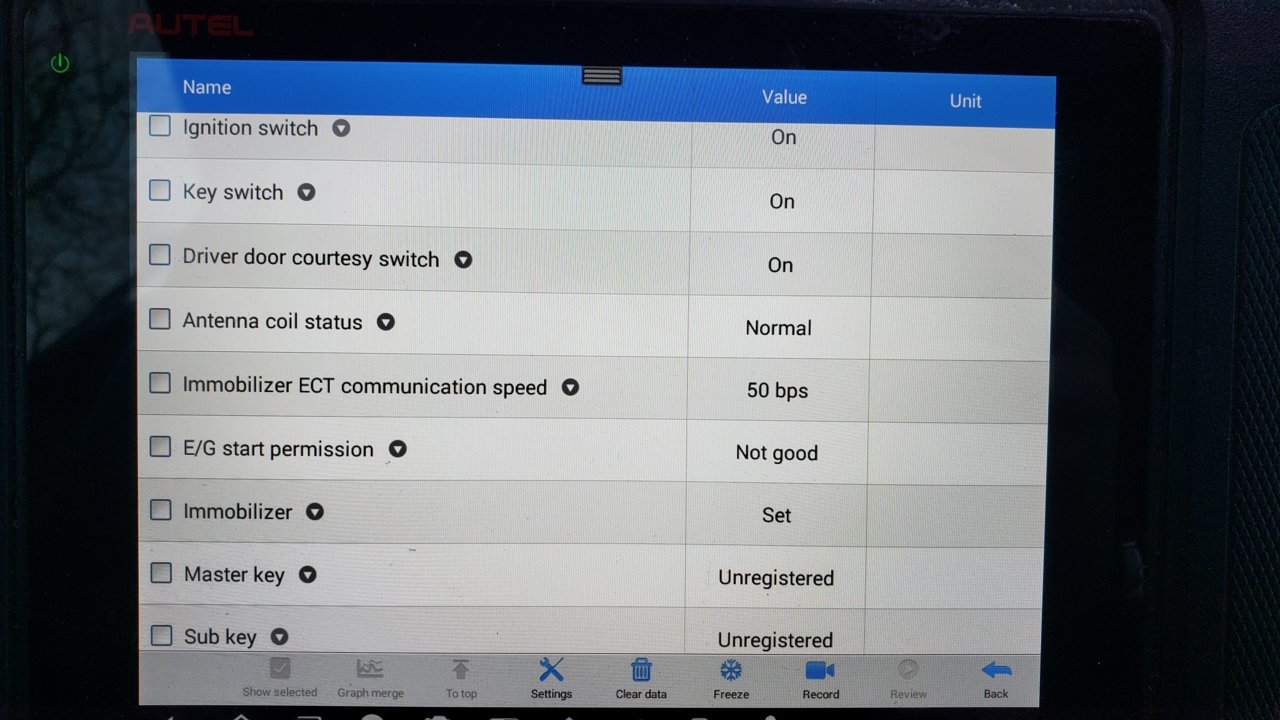

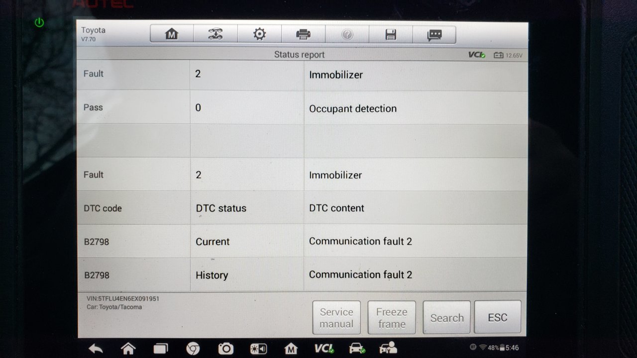

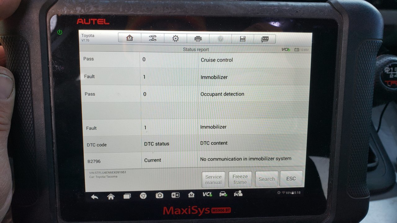

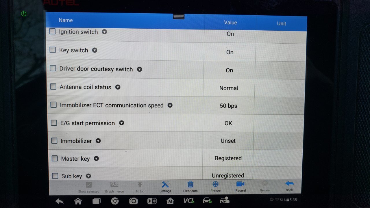

    Ok so I did a little experimenting on my truck by wrapping some foil around the head of the key so it couldn't be read (would be the same as having a unchipped or dead key).
    The truck will crank but not fire at all.
    It does not cut power to the EFI fuse.
    The security light continues to blink in all key positions at the same rate as when there is no key inserted.
    The ECM does not set any trouble codes.
    The immobilizer module sets a B2796 and/or B2798
    As soon as a valid key is inserted everything works normally.
    Below are screenshots of the relevant data PIDs from both the Immobilizer and the ECM.
    The codes.
    Immoblizer data with a bad key.
    Immobilizer data with a good key.
    ECM data Immobilizer PIDs bad key.
    ECM data Immobilizer PIDs good key.
    Torspd, PzTank, Jimmyh and 2 others like this.

    Nice. :thumbsup:
    So, would it be safe to say the ECM is not sending control to fire the injectors?
    Since the EFI fuse is powered?
  7. Jan 15, 2022 at 4:22 PM

    Never mind, all the pictures loaded for me.
    I see the ECM PIDs.
    Now we know. Thanks man:thumbsup:

    I would assume this is the case as that's how most immobilizer systems work, some disable the starter in addition to the injectors.

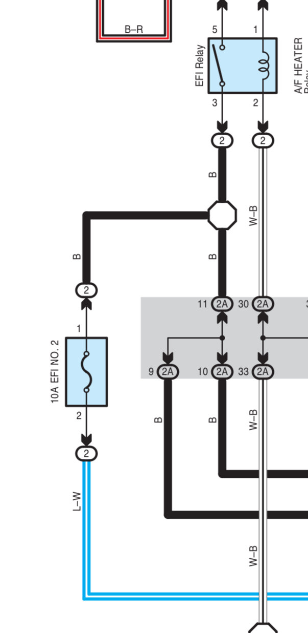

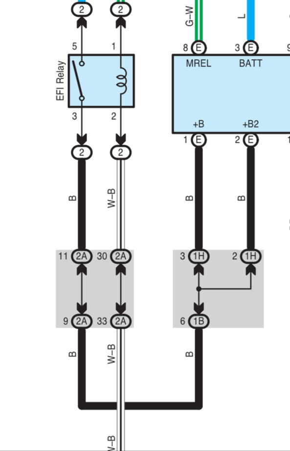

    @Dm93 did you check power on the 10A EFI No.2 fuse also.
    Or just the 20A EFI? 20A EFI is straight from battery?
    I’m still wondering why the diagram shows the EFI relay.
    Why would they include that if it didn’t do anything? Weird?
  11. Jan 15, 2022 at 4:39 PM
    #71
    TnShooter
    TnShooter The TacomaWorld Stray
    Sep 2, 2010
    #42625
    21,135
    Deogee
    07' TRD Off-Road, Auto
    STOCK
    Taking a better look, maybe it is because the EFI relay also powers the ECU?
    I don’t know?

    That fuse is labeled EFI on my 14, the EFI relay powers the COPN (fuel pump on/off) relay, various solenoids, part of the ECM, MAF sensor, and oxygen sensor heaters.
    As to why it shows up on the Immobilizer diagram who knows.

    Yeah, who know.
    I know under the 1GR control diagram is shows the No.2 fuse.
    But not on the immobiler?
