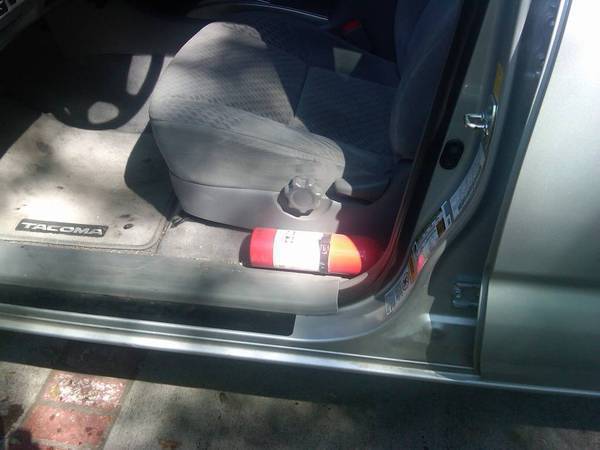

    mounted mine between the drivers door and the seat, it touches the door, but doesnt interfere with closing. I used the mounts that came with it, ^that is a lot of cutting.

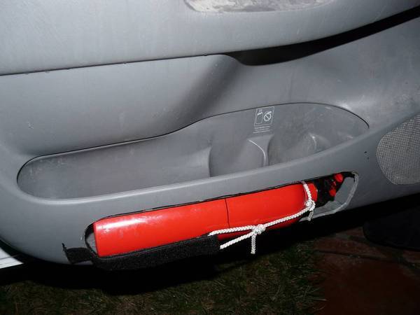

    Mount it to the access cab door with the bottom of the extinguisher inside the door pocket. Use mounting tape to attache the bracket to the door if you can, otherwise use a couple of self-tapping screws. Drill a slightly oversize neat hole in the plastic for each screw, and a small starter hole in the metal behind the panel.
    You'll have to look behind the plastic to make sure there's metal where the mount will be, of course.

    ^I added the pic to my post, no cutting, drilling, I have it near by and if it comes undone (which it hasn't on 2 tacos and 6 years) it wont be a hazard. Only downside is it leaves a line on the door, if that bothers you, you can pad the door or the FE.
