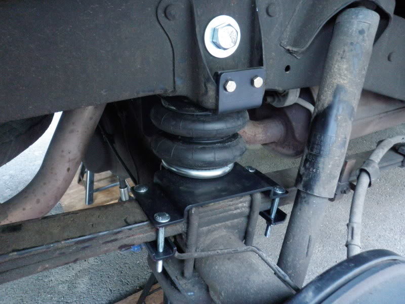

    If you read some of RCBS's link:
    "So I have been out playing a time or two and the bags do not limit travel at all... Its great."
    "Shocks still limit droop, and according to firestone there are no issues stretching them that way, I specifically asked."
    I have them installed on my truck. I've never been offroading with them, but I've hit some major pot holes. No problems yet, just really stiff on the big holes. I'm debating doing an AAL to get my rear height where I want it, that way I can run less PSI than I currently am. I'm not sure if it will be just as stiff with an AAL + airbags, or not. But I'll find out I guess.

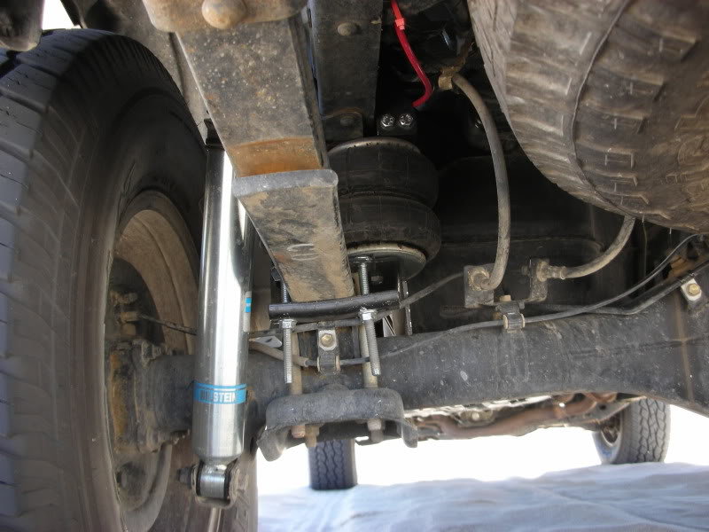

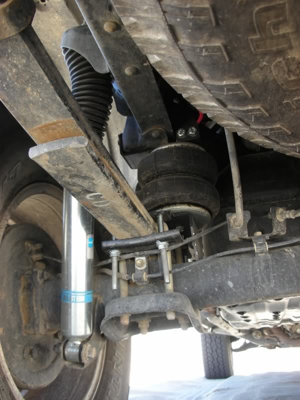

    You haven't read all of my posts on my '05 air bag installation, have you???
    I have posted photos and reviews... the Ride Rites were fantastic. Before the truck bottomed out (with a load in back or back seat passengers) over any bump or pot hole.
    I complained to my dealer... but nothing was offered... I wasn't on TW nor knew of a TSB. I asked friends for ideas. New springs, re-arched springs, add a leaf, Dever progressive springs, and air bags were all mentioned. So, I called some spring shops then I went to Off Road Warehouse in Escondido, CA.
    Spring mods all would make the truck ride firm all the time... and I only needed it with loads in back or 4 adults in front... The Ride Rites were the answer... I also upgraded to 5100 shocks (they were cheap) from the yellow Bilsteins in back.
    I took my truck to Ocotillo Wells to test it off road... It was great! I then took it to Baja, well loaded for camping... Never a harsh ride since!
    I traded my '05 for a '10... The dealer removed my air bags, in case I needed them on the 2010 DC... They are still in the box in my garage. Toyota fixed the problem... still three leaves, but the new truck doesn't bottom out under the same conditions.

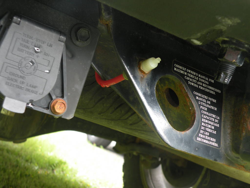

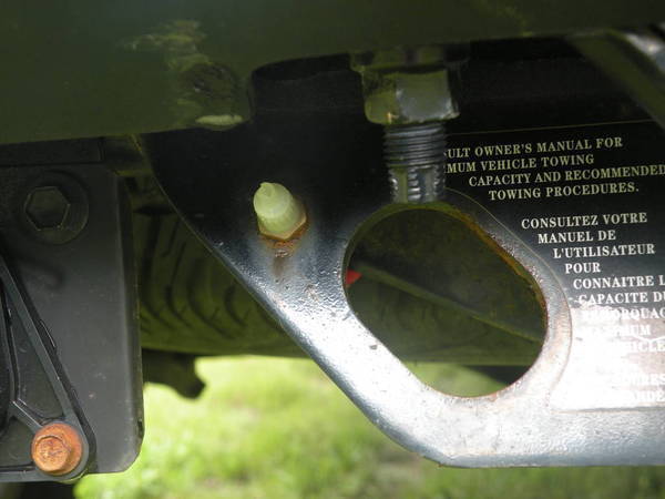

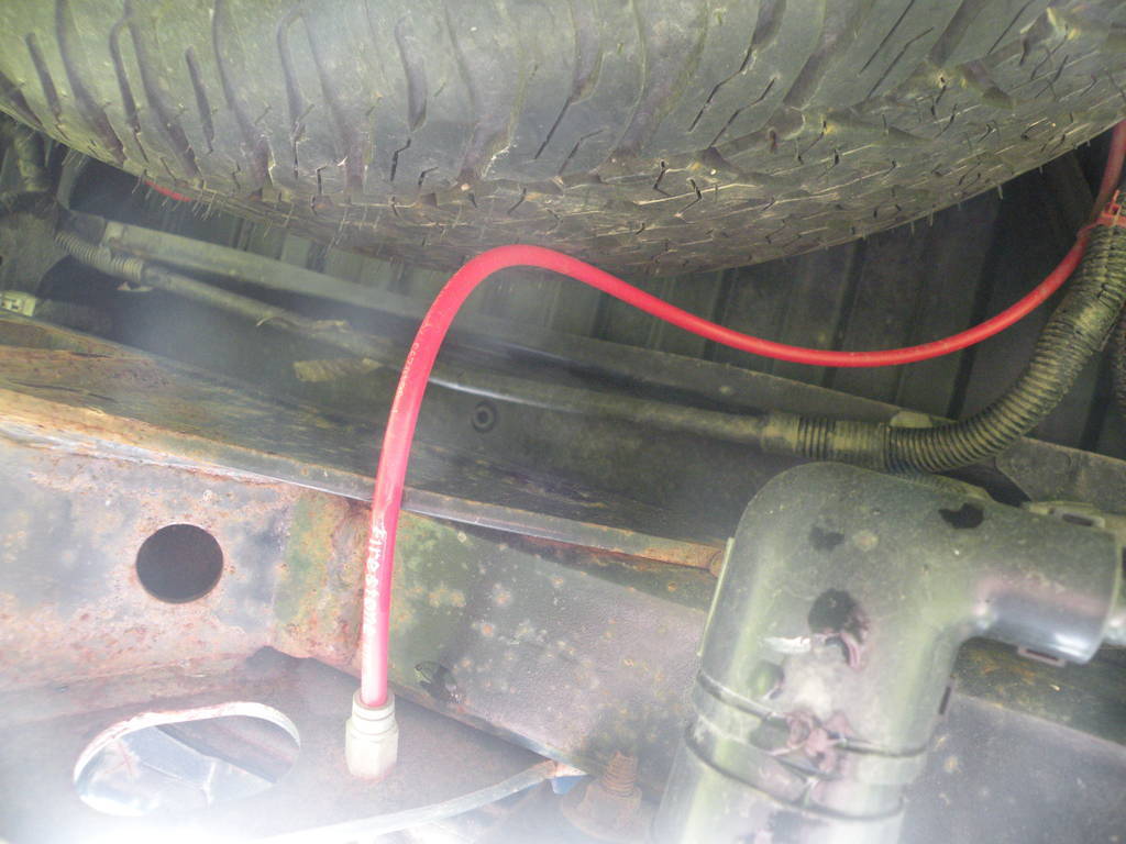

    Anyone got close-up pics of the air fittings in their final installation place?

    Yep, Just let me upload them real quick and I can post some

    View from the ground looking up under, into the spare tire location.

    Thanks!
    Nice job! I like what you did.

    I put the fill valves in the two compartments in the bed. It was a great way to hide them from everyday driving conditions and nobody would ever know they were there. I've seen people also put their valves/controls in there also.
