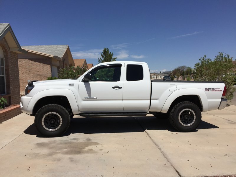

    I did a spacer lift on my 4cyl Prerunner. Ordered my kit locally from 4wheelparts. 2.5" spacer might be pushing it for the factory upper control arms. I went with Procomps 2.25" leveling kit in the front and an AAL for the rear (still haven't had time to install this one, the truck is sitting with a slight bro lean). Comparing the daystar spacers to the Procomp ones, the Procomp spacers are a simpler, higher quality install. Not saying the daystars are bad, but the Procomp ones might be one to look at. I also agree with an AAL over a leaf block.
    As far as quality, it rides the same. I've owned several Supra's and MR2's running simple spring and shock kits to full Coilovers; HKS, Stance, BC...so I'm used to variances in ride quality. With the spacer on the Tacoma I didn't notice much difference, if any in ride. However, I wouldn't trust it to do any adventurous off-roading, especially with the reduced travel in the front.
    Here's my Tacoma with just the 2.25" spacer in the front
