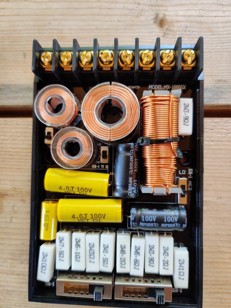

    CoastieRon [OP] Hammocking Fool
    Jan 1, 2018
    #239946
    2,431
    Ron
    Nashua
    Lil' Silver
    Too much.

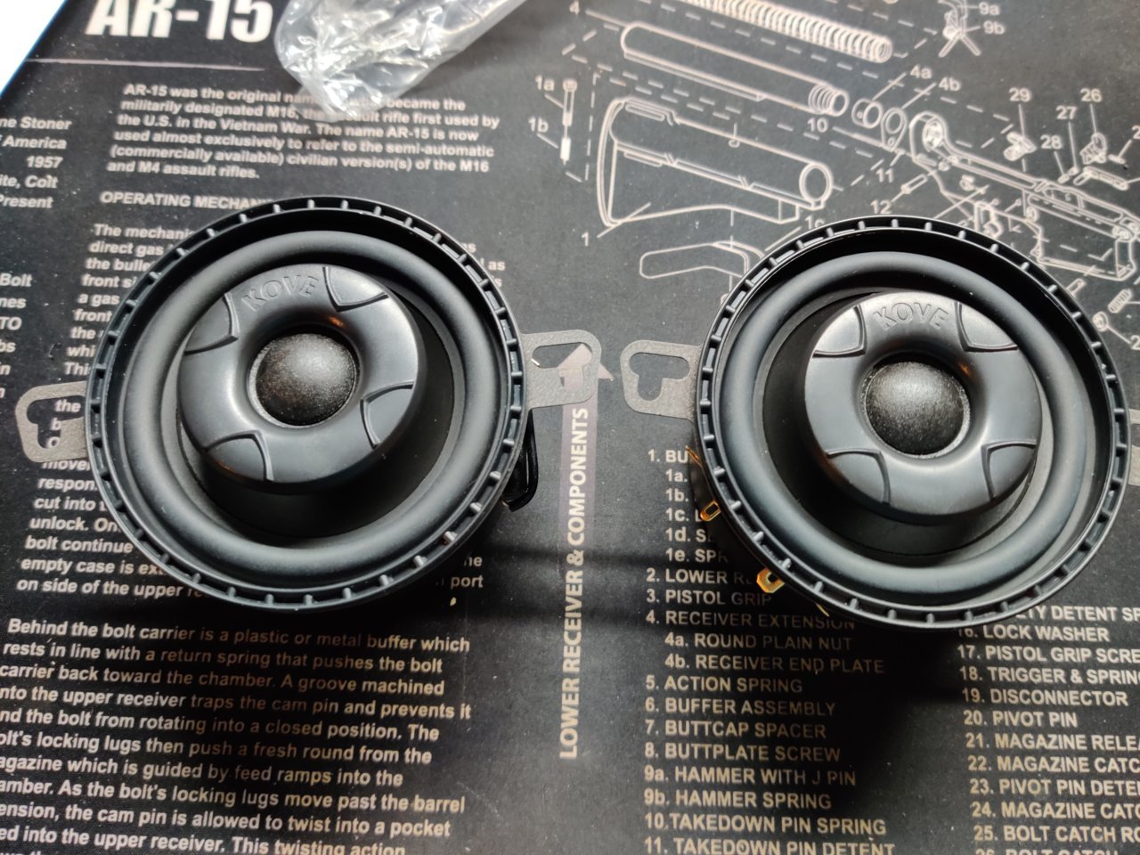

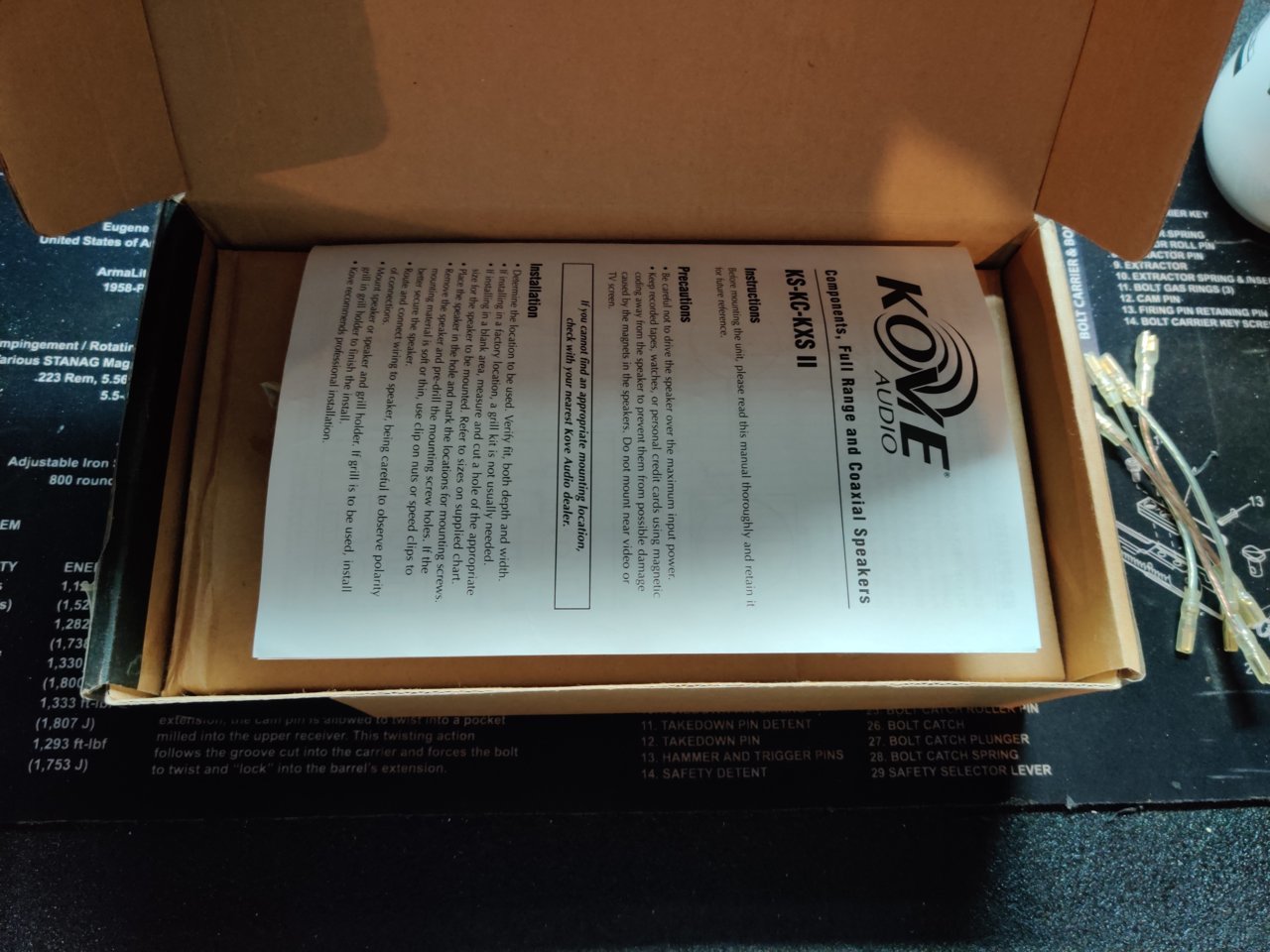

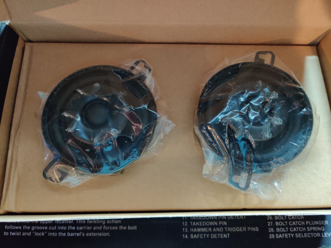

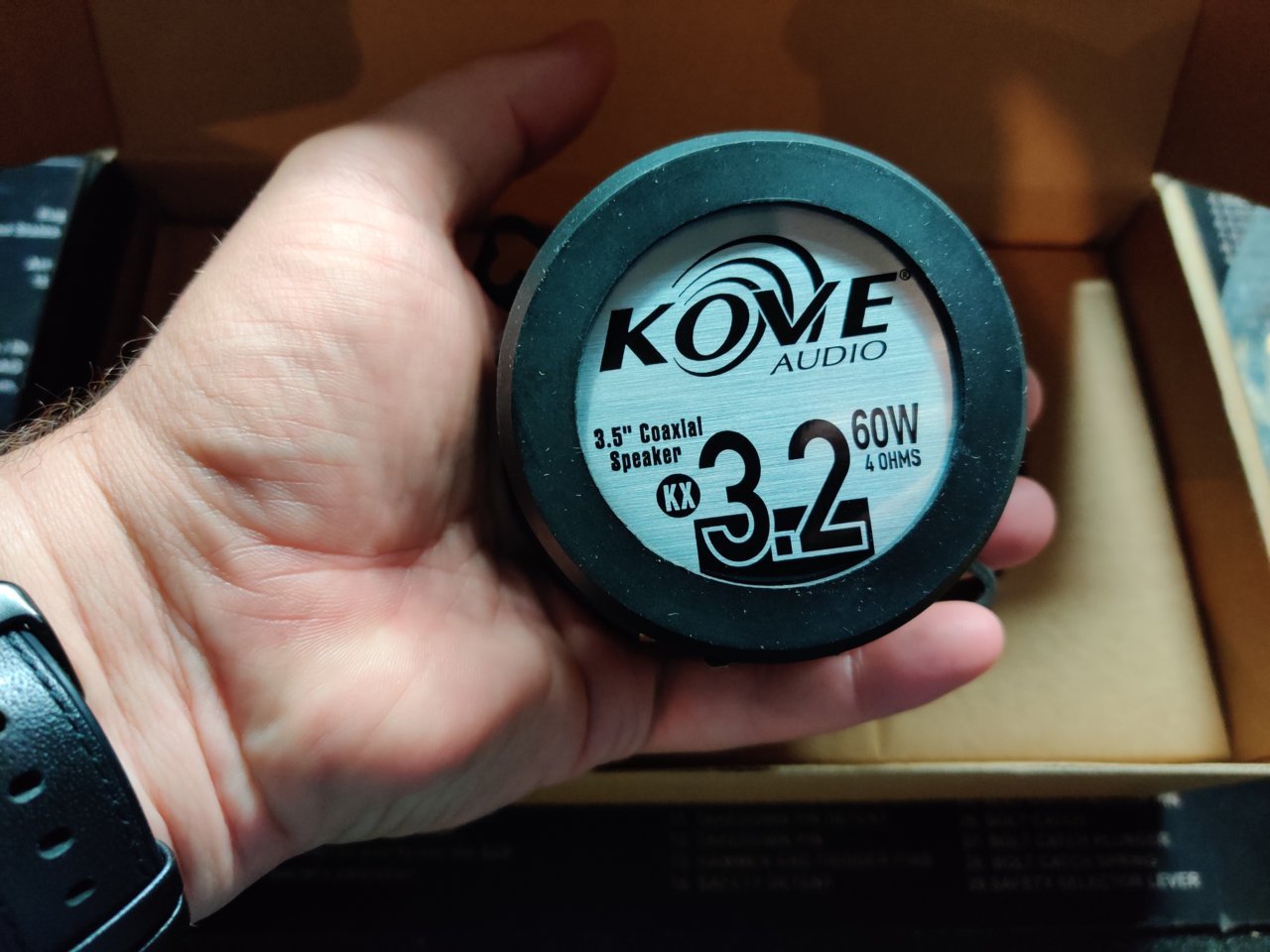

    On a side note, I was cruising through FB and saw an add on the Sound Quality Classifieds page with 2 sets of Kove KXS32s 3.5" coaxials.
    I bought both sets (because why not, they were dirt cheap with great specs). Gonna stuff them in the dash.IMG_20190821_193530.jpg IMG_20190821_193536.jpg IMG_20190821_193543.jpg IMG_20190821_193605.jpg IMG_20190821_193727.jpg

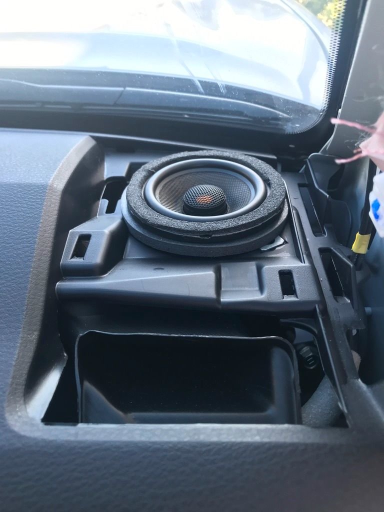

    Let's say yes, but no.
    They don't quite fit, there needs to be just a little bit of trimming done.
    They definitely need to be bi-amped, I'm working on that solution.
    I have a campout the next 2 weekends so it will be a little while.
    I'm still going to prepare for putting tweeters in sail panels though...

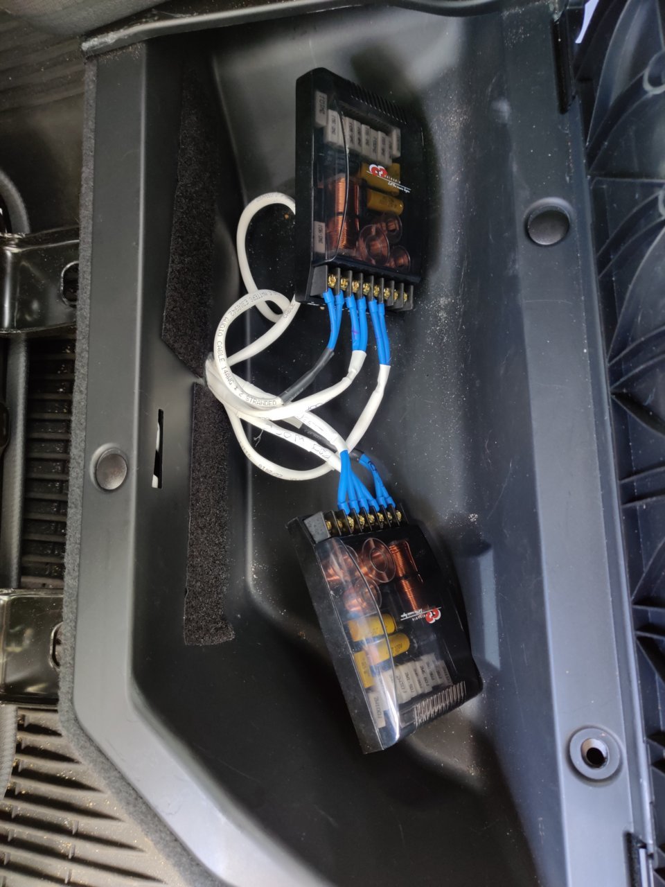

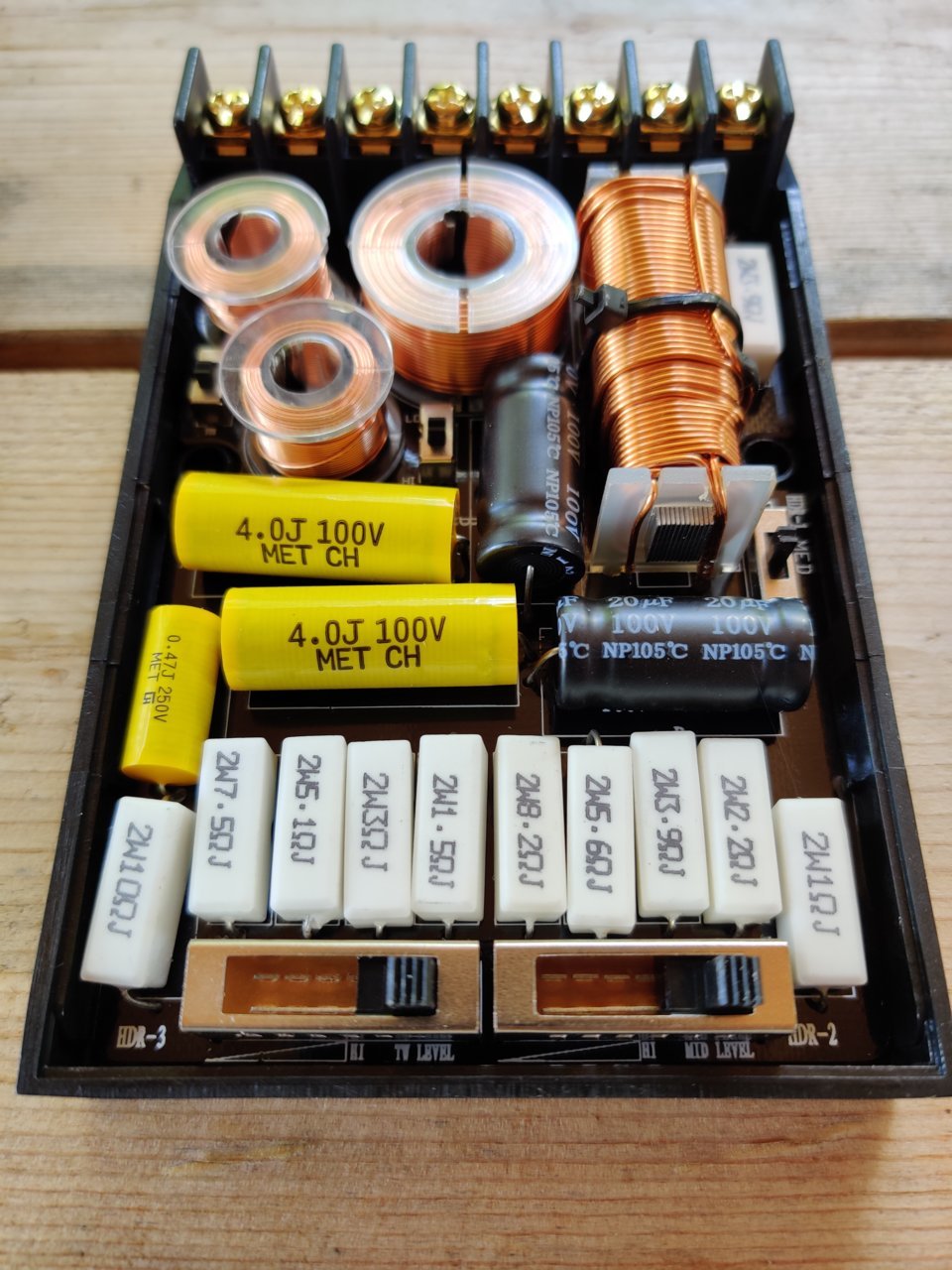

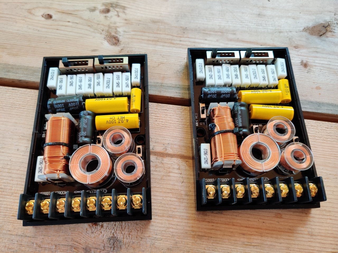

    I'm gonna run these as is right now. They completely opened up the 2-1/2" wide range drivers and it sounds great...
    So now I'm totally up in the air with what I am going to do with my dash.
    I set them up in 2-way mode, utilizing the mid-tweeter output, shutting off the tweeter output.
    I set the crossover like this:
    HDR1 - (woofer) Medium
    HDR2 - (mid) setting second from highest
    HDR3 - (tweeter) lowest setting
    HDR4 - Low
    HDR5 - 2nd order
    The Morel CCWR264s have life! Holy crap. We compared the morel crossovers to the CDT and there is really a HUGE difference in the front stage. Much more crisp and full while staying warm.
    I'm going to roll like this for a while before deciding whether or not to go forward with the coaxials on the dash or tweeters in the sail panels.
