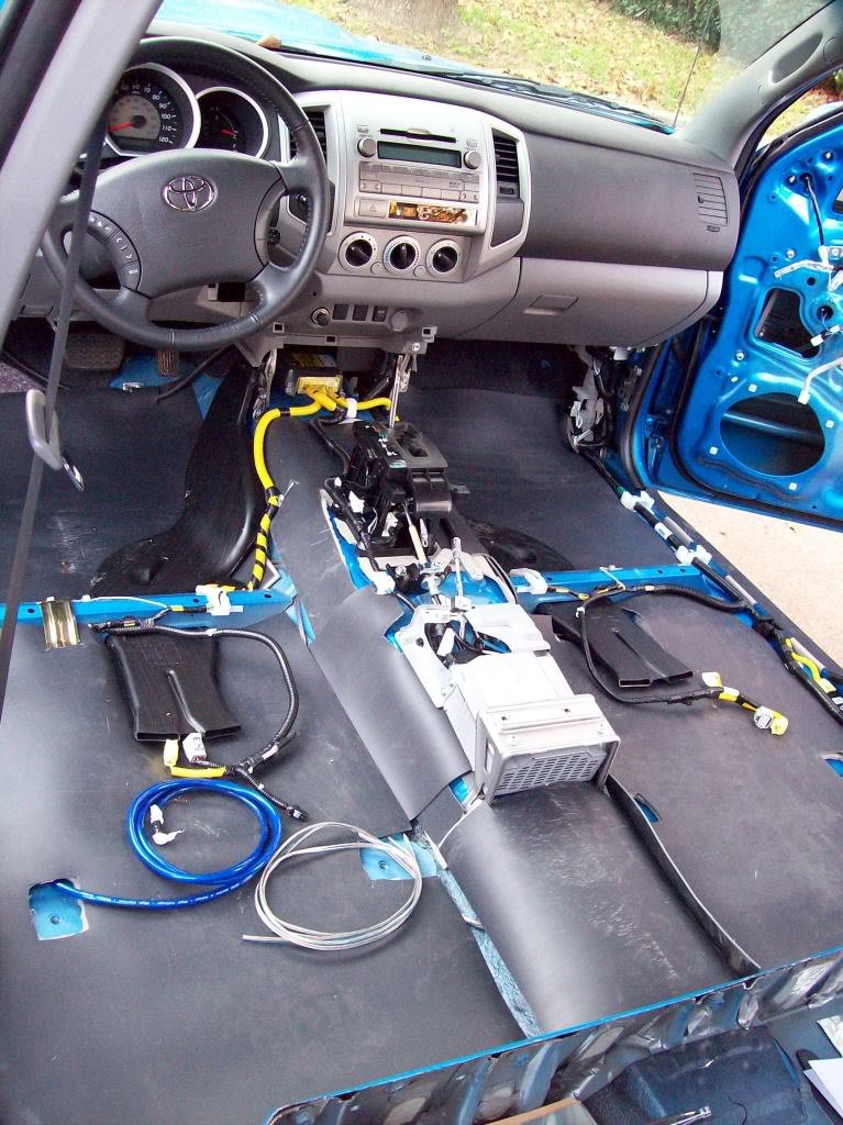

    The mat style deadener won't gain you much on the floor since those areas are quite thick and structured. The proper use case scenario for mat style deadener like Raammat is areas of thin unstructured metal like the doors that are prone to resonance. The goal of a mat deadener is to kill the resonance; not block sound. It does block some sound but it's not the proper tool for the job.
    If you want to block sound you need a decoupled noise barrier. Mass loaded vinyl (MLV) is the best tool for that job. You float it over the surface with closed cell foam. For the floors, this would look like a layer of 1/4" foam with pieces of MLV cut to fit the floor. Then you'd put the carpet back in on top of that stack.
    Check the thread I posted a while back doing exactly what you want to do. Lots of pictures in there too.

    I'm getting what you're saying. I noticed a good improvement when I did the doors, roof, and rear wall - stock TRD Sport and tires. However, I did look at all the stock deadener that was in ItalynStylion's photos and the ridges in the floor pan. It leads me to believe that metal resonance is of low concern.
