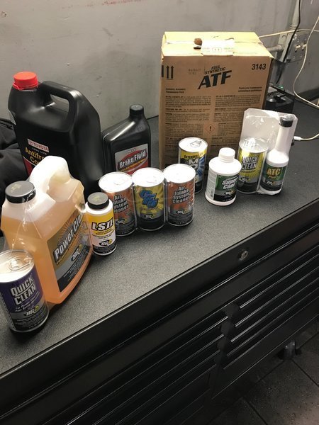

    IMHO if you like the best synthetic fluids Toyota Dealer carries the BG PRODUCTS....
    https://www.bgprod.com/
    I saw and read every single presentation video and technique of each product and service, did all of them at Toyota of Plano , all kind of fluids and flushes in a 4wd truck including brakes, power steering , etc All at once
    they worked fine for me :oldglory: , once again matter of opinion and budget but I like a lot the smoothness and good service. Planning on returning on the 30,000 miles intervals for doing all of them whenever time comes, ( I don't DIY anything besides coffee :smash::smack:
