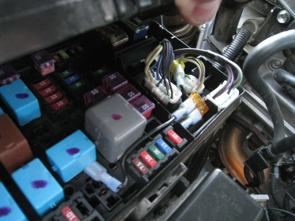

    Below is the picture of how I did my fog light mod. You can't see exactly where I tapped in, but if you follow the light blue wire running from the relay you can almost see where it joins in with the light green wire coming from the smaller plug in the center. The light green is the one you want to tap. I pushed out the pin for that wire in the harness, tied the blue wire into it, and pushed the pin back in.

    It sounds like you pulled out the relay, wrapped the wire, then reinserted the relay without bending the tab out... is this what you did?? If so then that is the problem. You MUST bend the tab out, otherwise the signal your sending in the fog light relay is backfeeding into the truck and also triggering the headlights (from what it sounds like atleast).
    Also, wrapping wire around the prong is not exactly um..... Standard Procedure, if you will :notsure: Might I recommend going to walmart, autozone, etc, and purchasing a couple insulated female spade terminals to properly connect your wire to the relay. It will be much safer than having a loose copper wire floating around in your fuse block :eek:
    Here is mine:
