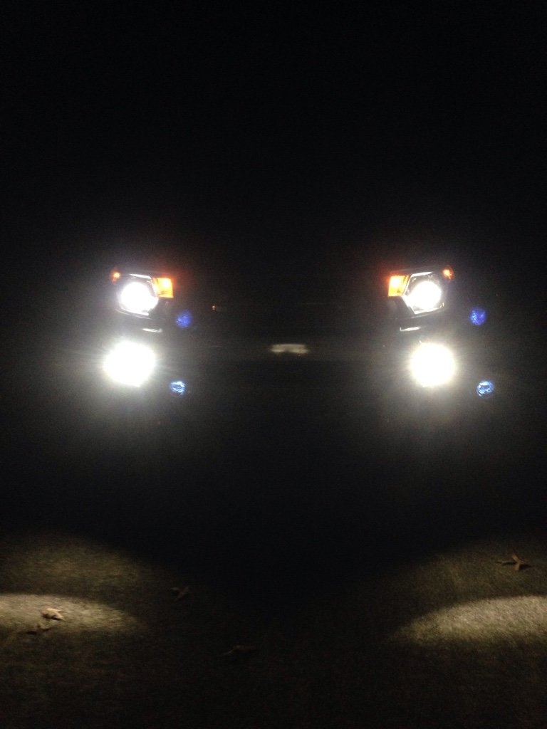

    I did as I described above and everything is working perfectly.
    I also installed my Christmas present to myself, XB LED Fogs from The Retrofit Source!!
    Pics are coming. Thanks to the OP and everyone who contributed to this thread.
