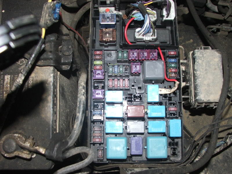

    Is this the best way? It trips me out a little when the person stated the fog lights would just come on after 4 hours (other methods).
    I want them to come on when:
    (a) the ingnition has to be in the on position
    (b) a person physically has to depress the button to make the lights come on/off

    sorry for the stupid question...but i want to do this once and i want to do it right.
    here is the question:
    numbers 5&6...do I pull the relay completley out the bend the terminal to the side? is the relay not flat against the board anymore?
    thanks. i hope this will be my last question. I will try it when I get home tonight.

    use this female instead of a male connector...correct?

    Yes. Bend the male end (on the relay) 90*, and connect with a female end.

    I am changing my unlighted factory FOG LIGHT switch to a Toyota lighted switch.
    The lighted replacement switch has three prongs.... I am assuming (from information I have reviewed on this site....that the top prong is the Ground, The middle one is the Power, and bottom one goes to the relay....)
    Here is the problem.... I just removed the OEM Factory plug from my DASH and it has Four Wires.... One is white.... I traced it and it is the Ground, The Green with the stripe, is the power.... There are two other, one stripped green and another almost green.....but a total of FOUR wires.....
    How do I wire the four wires into the three prong switch...
