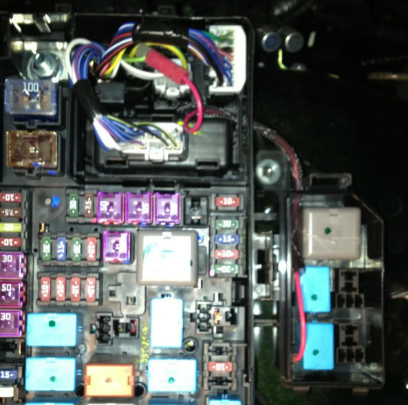

  14. Nov 16, 2012 at 5:24 PM
    #254
    jjhitchen
    jjhitchen Relentless
    Sep 4, 2012
    #86272
    1,002
    Joel
    Arroyo Grande, CA
    2012 4x4 V6
    100% stock Tacoma
    I did this exact thing, my headlights came on when I advanced my key to the on position even though the headlight rrocker switch was in the off position. Then when I turned the headlights on nothing changed and then when I tried to turn my high beams on a buzzing sound came from the engine compartment and no lights turned on... Sketchy :confused: :pout:

    I just did the OP's mod on my '13 and ran from the small box with the fog relay to the big box with the green wire and used a Posi-tap connector at the green wire. I drilled a hole into each box and ran the wire through some 3/16" sheathed conduit.
    Thanks to all the tech pioneers of this subject for doing the research.

    Tom, can you post a pic of the green wire you tapped in the big box, i think its at the big plug, but i just want to make sure.
    those of us without seat heat pre-wire, i think this is the best option.
    (there was post from a guy using the tail/towing spot who reported brake problems when he had the trailer hooked up)

    Okay heres the info from Toms 2013, we discussed over email. here's his photo and some description. this is the route im going to go. instead of a tap im just going to use a blade connector into the terminal but, same thing...
