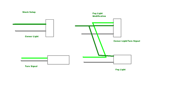

  11. Mar 13, 2010 at 5:23 PM
    FightFire48
    FightFire48 Taco Monster
    Dec 11, 2008
    #11476
    218
    Will
    Spokane, WA
    04 Taco dbl cab
    3" Toytec lift AEM BruteForce CAI Gibson exhaust 2 - Rockford Fosgate 8's
    I know this isnt the best detail but you should get the picture. Is this the correct way that you are talking about? And also it made my "new" turn signals dim but the "newfogs" are nice and bright. let me know if something isnt correct thanks
  12. Mar 13, 2010 at 6:03 PM
    SunDevilTacoma
    SunDevilTacoma Well-Known Member
    Dec 15, 2009
    #27588
    386
    Doug
    Gilbert, AZ
    04 Wht Double Cab PreRunner
    Turn signal relocation, built in fog light conversion, 4" deck plate
    That's close to what I did. See below, I kept the power (green wire) that originally went to the parking light going to it but tapped into that line and ran it down to the fogs. Is that how you did it? If not it may be why your parking lights are dim. Honestly I don't think mine are as bright as they were. This help?
