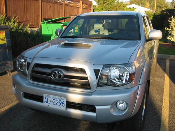

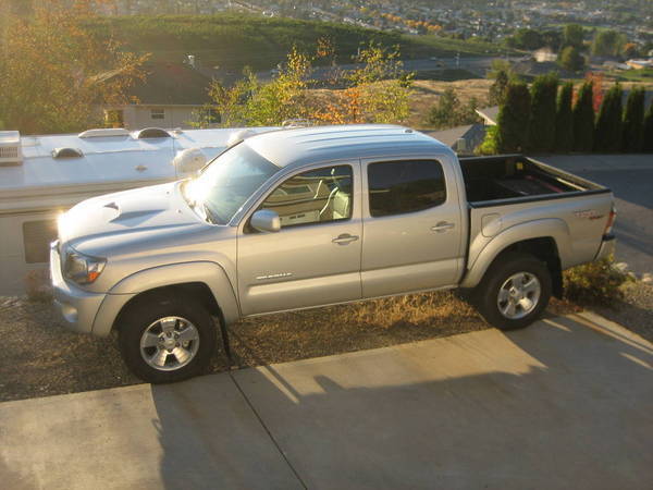

    Well, this is she...
    The day I brought her home.

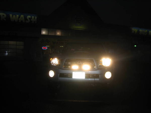

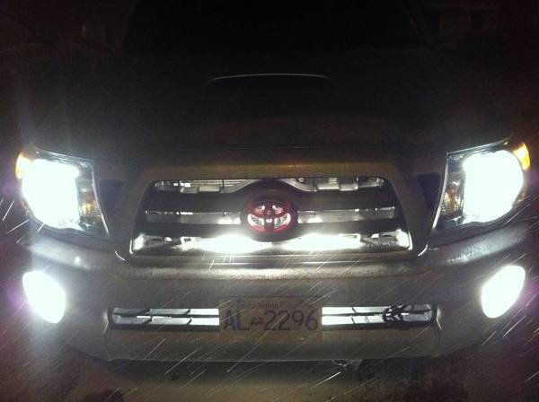

    Lights .... I love lights!

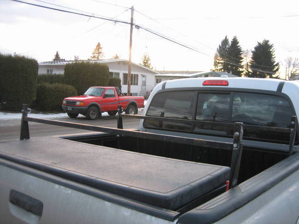

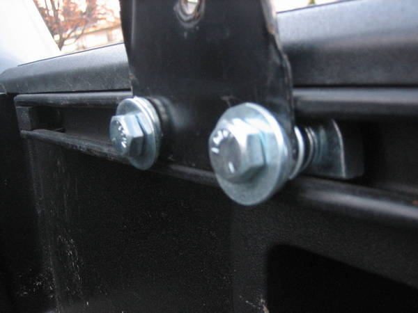

    Next was some storage and a custom bed rail rack for skis/other stuff

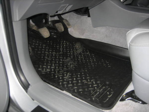

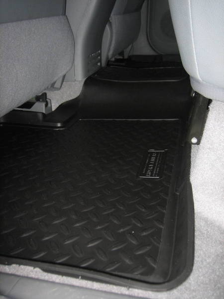

    Husky Liners all Around

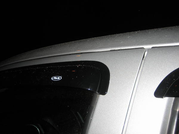

    Now to keep the rain out whilst on the coast

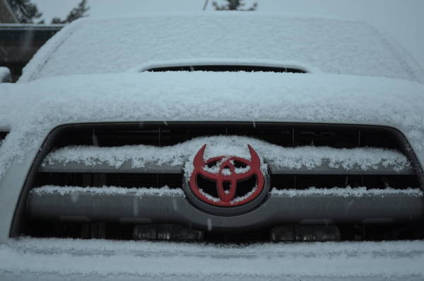

    DEVIL HORNS: By Andres http://www.tacomaworld.com/forum/buy-sell-trade/182262-october-2011-devil-horns-batch.html

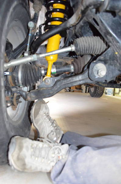

    CV right after lift

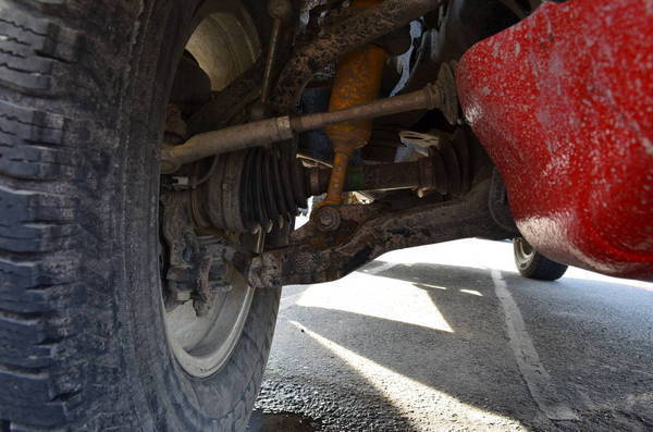

    CV after two days of off roading
    Oh yeah, got stuck whilst in 2wd - Rookie move
    A post lift picture

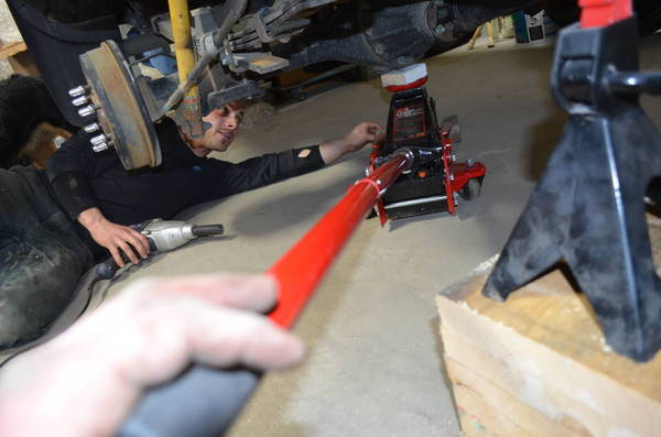

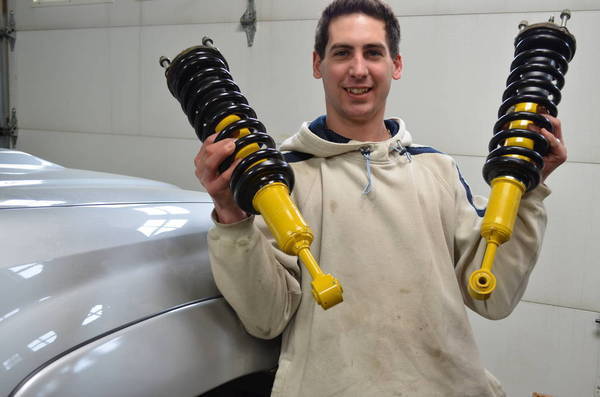

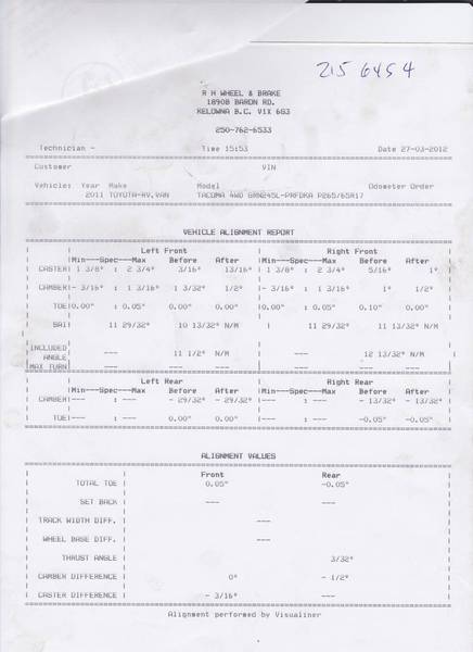

    Hey there! For those of you who are thinking of getting an OME lift and may think the ride is too stiff, <I am running 885's Nitrocharger shocks and an AAL> THE RIDE IS AMAZING! Over stock bilsteins, the nitrochargers soak up the bumps. I have about 150 pounds of crap in my box, as normal, and she took the washboard and big potholes on the de-activated roads like a champ. I also have top plates for the full 3", and I could not be happier. I have gotten the truck aligned, and as expected, the caster is not to spec, but I cannot detect any difference. between before lift and after. She tracks straight and wheel centers no problem. I still have a rear driveshaft harmonic vibe from 30-60 kph, but even with 2.5 degree shims, I can't seem to get rid of it. The price you pay for changing a stock driveline.
    Here are my alignment specs post lift [​IMG]

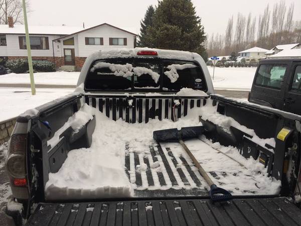

    I also built a sliding toolbox and something to put a small mattress in if I ever have to sleep in the back of my truck.

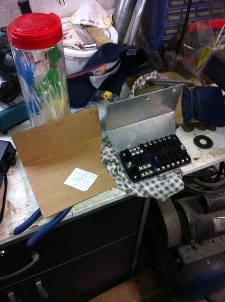

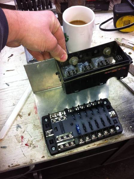

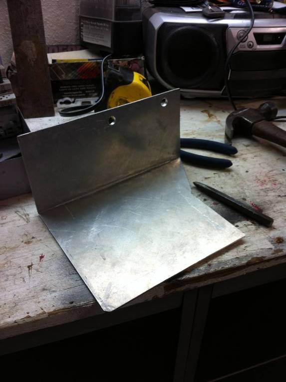

    I am currently re wiring all of my aftermarket lights, so I dont have an octopus of wires coming off of my battery terminals. I have a Blue Sea Systems 5026 fuse block,
    and I will be making a bracket to hold it, and three relays for lights and my compressor.

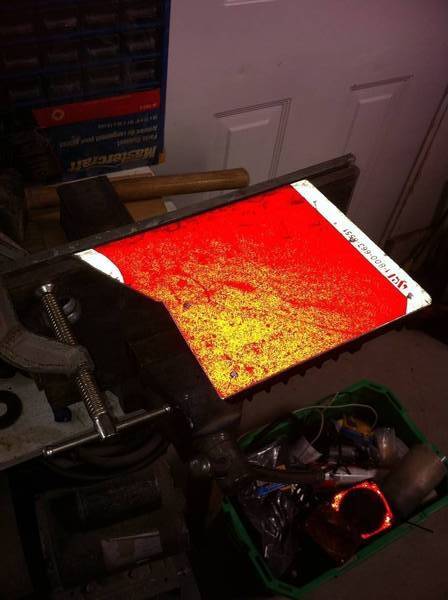

    And here it is!
    Template
    Bending it
    Finished product

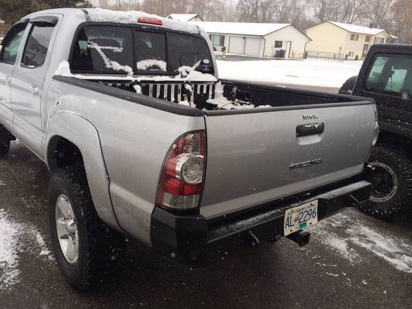

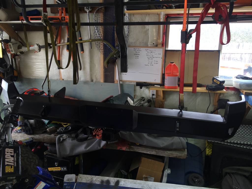

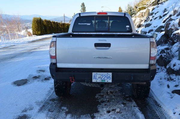

    I just pulled the trigger on an ARB Deluxe Bull Bar and a 4X Innovations Rear bumper
    The Front.
    Paint:
    The morning we decided to put it on!
    I am very happy with the 4X bumper. Although shipping took longer than expected due to weather, and a miscommunication with 4X... All is well, and it in my opinion is OVERBUILT! If i ever get in to a serious accident, the bumper will be fine, my frame, will probably look like something that just got hit by a train.

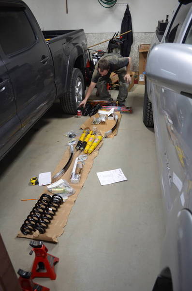

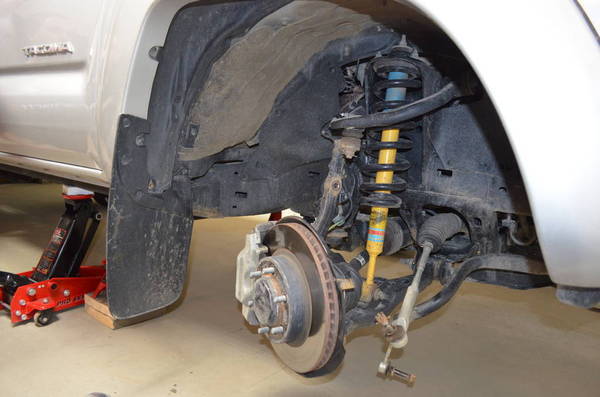

    Bingo! I drove to oroville to pick up my lift and a buddies lift. Removed the struts and did the rears last night. Was up till 1:30. Then this morning we had the springs compressed, and coilovers assembled. Installed by noon! Found some mud, got stuck twice :) I am super happy with the lift, and rides awesome!
