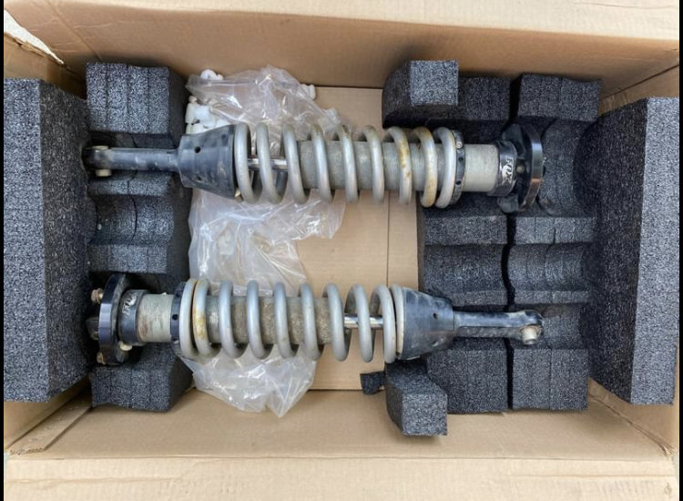

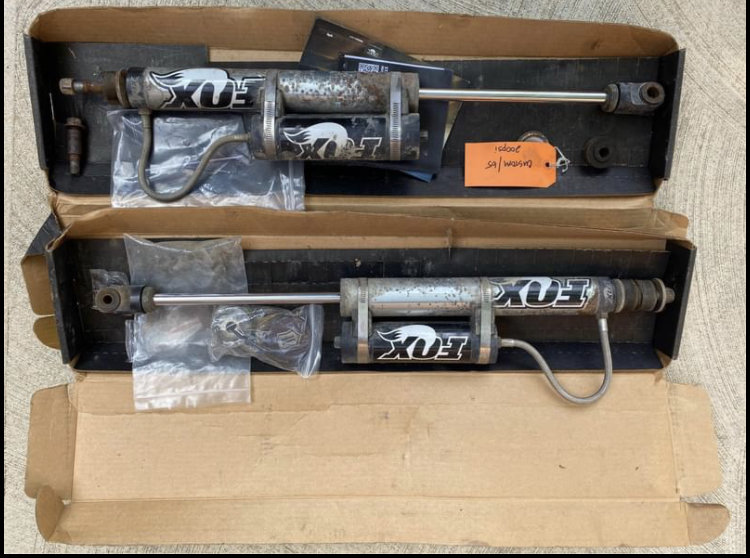

    FCB311CE-7199-43D0-B120-D69B2FA07CD9.jpg BFB65103-1AF0-4455-A761-4AF4F4E3BF12.jpg
    Looking for advice on what would be a fair price to offer for these. 40k miles so I’d likely rebuild them before install.
    I was thinking $700. Even if I pay to have them rebuilt I’m at $1200 for what would be a $3000 setup. Am I getting a deal or am I kidding myself?

    That’s actually an $1800 purchase brand new. They look terrible. Buy once cry once dude.

    thanks dude. I think I just wanted it to be a good deal so bad I was looking past that. You pulled my head out of my ass lol

    Yeah, those need some work and at 40k you’re into them at least a rebuild and likely some replacement parts. If you can do the work yourself you could possibly make it worth your time but I wouldn’t buy them and slap them on your truck.

    @RangerComa is correct. I have the same setup and I think I paid just under $1800 brand new including ICON AAL and shipping to Hawai’i.
