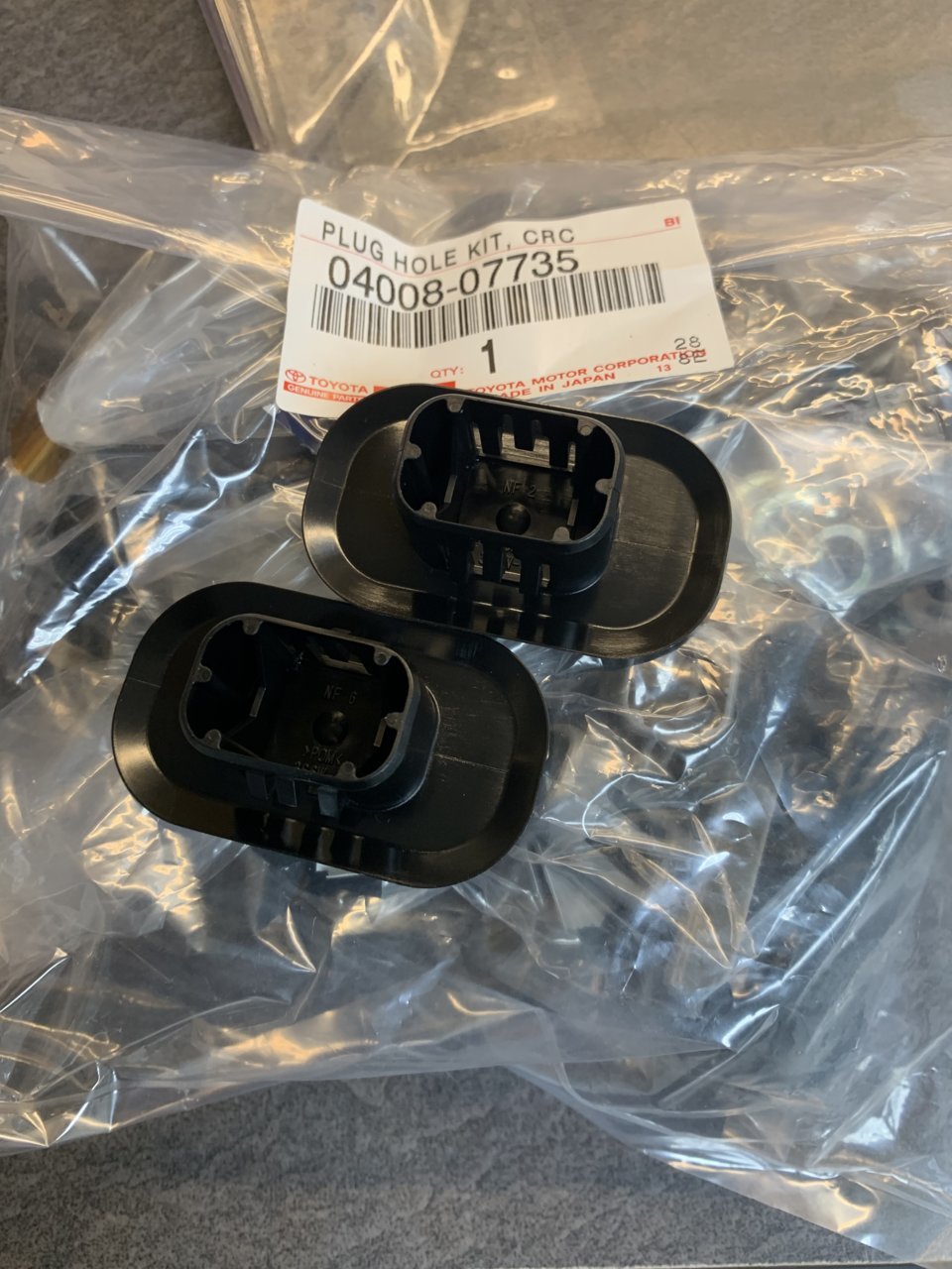

    Bought a complete set from Toyota last week and had my 2013 plugged by the dealer’s mechanic who specifically works on coating, plugging and replacing Toyota frames.
    I was told this was everything they used when doing the frame servicing for those who qualified under the extended warranty program. The two isolated pieces on top of the bag I’m sure have their own part numbers, the parts guy told me this is how they all came, and that this was the complete set. The plugs ran me $82.00 I believe.
    The plugging job done by Toyota was $210.00F1D8EBE0-384D-454F-9365-F00439979242.jpgF2EDE2CC-1E4F-4A19-8916-F6B55B6D0812.jpg

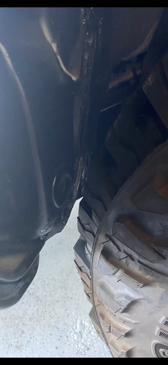

    I lost my driver side plug in the wheel well, not sure it’s a frame plug though. Anyone have any ideas? The picture is the passengers side.

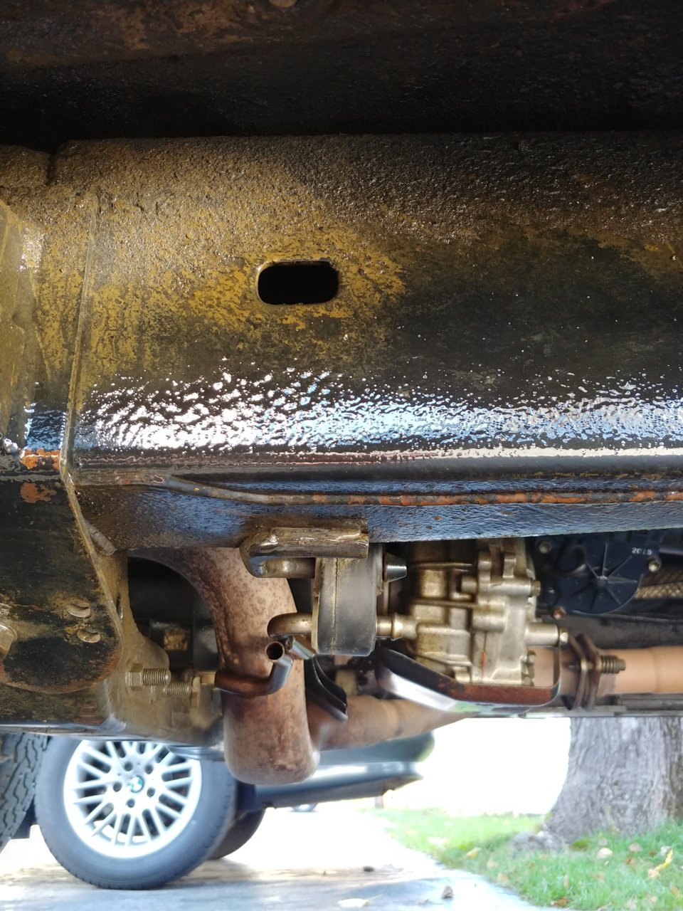

    Anyone happen to know if plug #4 will fit this hole next to the T-case?

    I had my annual frame inspection done this week. It was inspected, treated with the CRC.
    The frame was inspected and given a thumbs-up/no trouble found. Note: Re-application/touch ups of the CRC is/are not included as part of this inspection. I checked their work today and noted the oblong seal on the inner passenger side of the boxed section of the frame was missing. Drivers' side in place. I'm assuming there should one on both sides, and I have a call in asking them to confirm. I found this thread today looking for that info. Noting that all the seal part number and kits numbers here (Thank You!) I decided to check the service invoice from last year to check if there were any part numbers on it: There are. Thought it might help someone some day. I don't believe they match anything already here. I entered these parts numbers on the Boch South parts website and they all came up as valid. Here they are:
    1 04008-07735 Plug hole kit, CRC A
    1 04008-21104 Plug hole kit, CRC AP
    2 90950-01987 Plug, hole
    I'll figure out if all of them are in place using the pics in here while I'm doing my fall Fluid-Film and paint touch ups and I'll just order them myselfM I'm also going to address the cab mount holes.

    As it turns out that plug does not fit that hole. The corners are a little too rounded

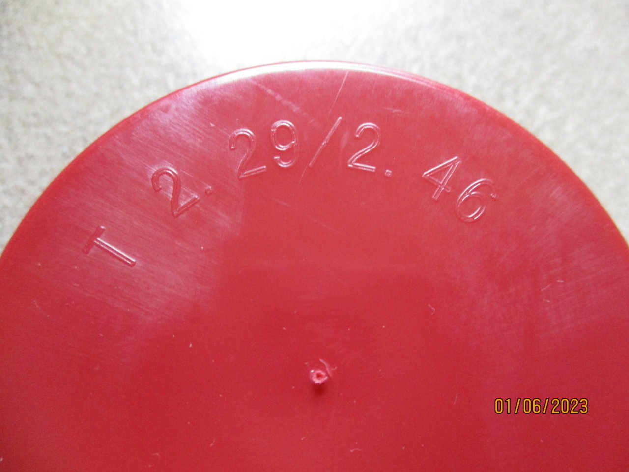

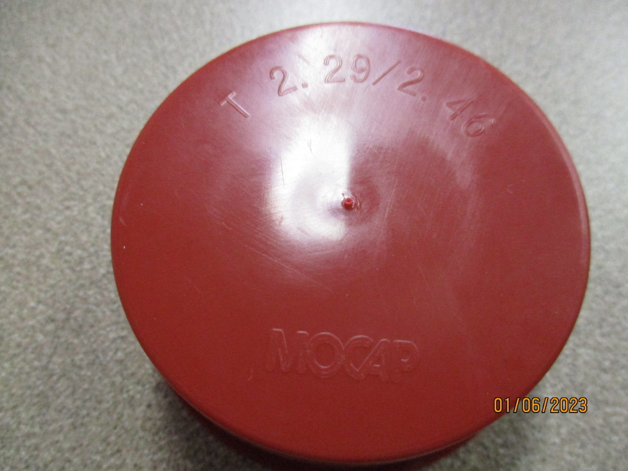

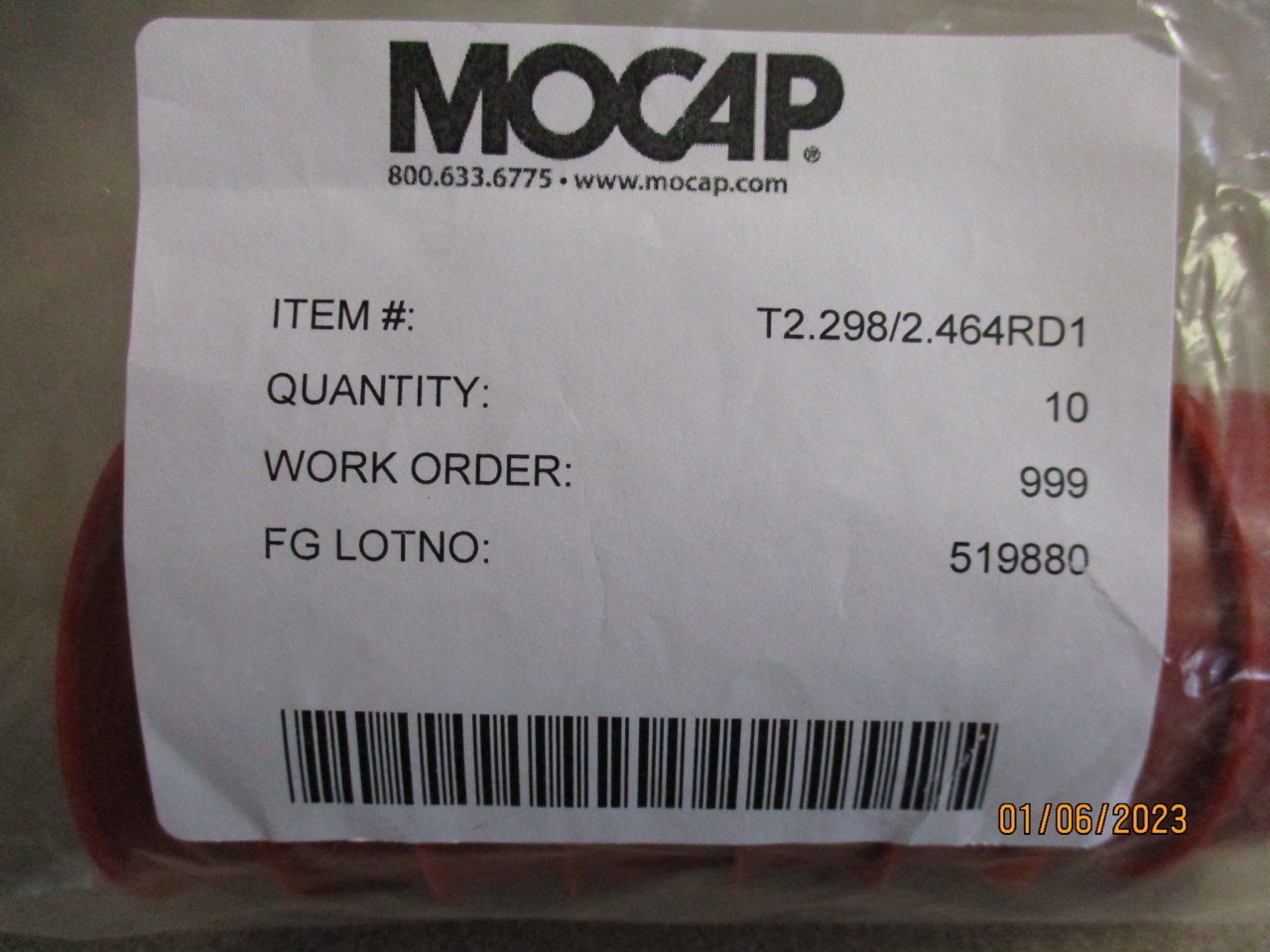

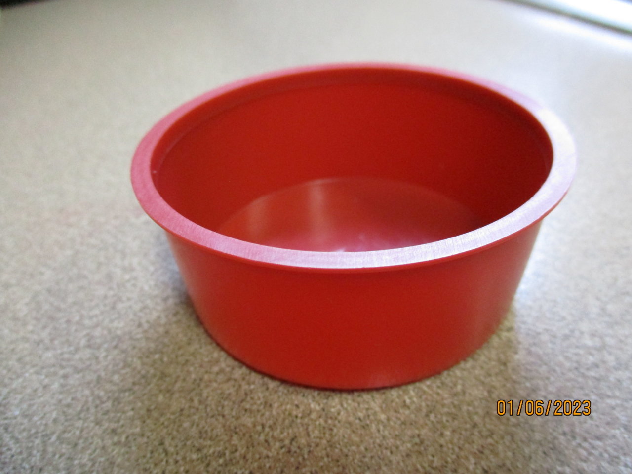

    I know this thread is older, but no one has come up with a plug for the cab mount frame hole that I know of.
    This is what I used on my 2015 ac sport.
    Been in place for several years.
    TPR (mocap.com)
    Williston and 10thMTNgrunt like this.
  17. Jan 6, 2023 at 12:43 PM
    #37
    JdevTac
    JdevTac Well-Known Member
    Jan 8, 2012
    #70234
    6,312
    Josh
    MD/GA
    2nd gen
    buzzkill911 and Williston like this.
  18. Jan 6, 2023 at 1:02 PM
    #38
    Rambofirstblood
    Rambofirstblood Active Member
    Oct 26, 2018
    #270645
    36
    2015 TRD Sport
    I remember seeing that thread you linked, but searched and couldn't find it.
    Also seen you had trouble with the plug the op used.
    This plug is tapered so might fit some holes better.
    Just another option, thanks for the heads up!
    Williston and SR-71A like this.
  19. Jan 6, 2023 at 3:13 PM
    #39
    JdevTac
    Jan 8, 2012
    #70234
    6,312
    Josh
    MD/GA
    2nd gen
    Yes was a bit of a pain given the tight space!
