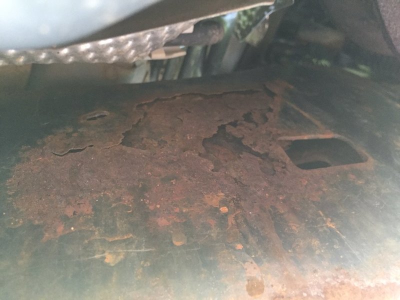

    Update:
    I have owned 4 Toyotas spanning almost twenty years. I have been saving to purchase the new Tacoma next year after the first year bugs. No longer.
    My frame somehow passed inspection even though you could see straight though it. (At a certain angle)
    I called Toyota Corporate the day it happened. (Also due to airbag light still being on after the spiral cable replacement) after my inspection.
    They said that I must return to the same dealer for reinspection.
    https://www.tacomaworld.com/threads/frame-rust-recall.263311/page-60
    Upon reinspection-with me present-my frame failed. There was a light coat of surface rust flakes, and I picked off with my fingers to allow a better viewing angle of the hole. (DO THIS BEFORE YOU TAKE IT IN). Whatever you do...don't be honest like me. If the hole had been more visable the tech wouldn't have missed it.
    Now after a two-month phone tag with corporate call center folks, I am left with a rotten frame that they won't cover due to it "passing" inspection the first time.
    Implying that somehow my mighty finger strength distroyed their frame.
    Not the rust that covers it from the inside out..
    I've enjoyed this forum even though I've been a lurker. If I can save someone from getting mistreated by Toyota, with this post I can contribute back to a community that has (unknowingly) given me and others so much.
    MAKE SURE YOU HAVE A VERY VISIBLE HOLE BEFORE TAKING IT IN!

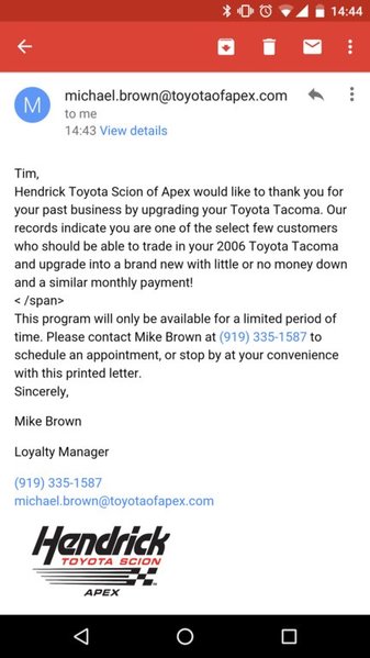

    Anyone else have their dealership offer a "complementary appraisal"?

    Oh this may be why lol. They funny if they think I'm gonna sell.

    wait... you are being denied a new frame .... if so, email the north america ceo and include a copy of the pic
    Old School likes this.
