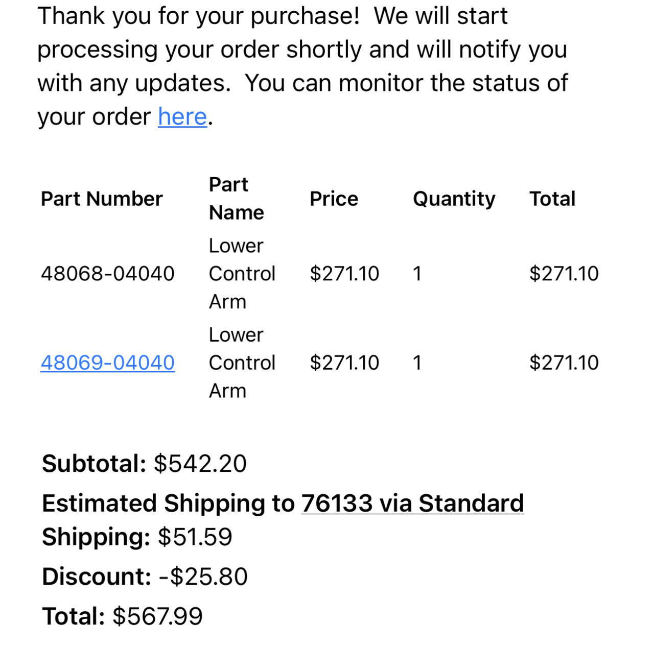

    I’m guessing they said you need LCA’s replaced because the bolts are seized.
    $850 is high though. I just did mine this weekend.
    You need to add the bolts, but here’s what I paid for new LCA’s. This includes the bushings and lower ball joint.
    edit: but if you’re only keeping the truck for another year or two, Moog LCA’s will be fine and much much cheaper.
