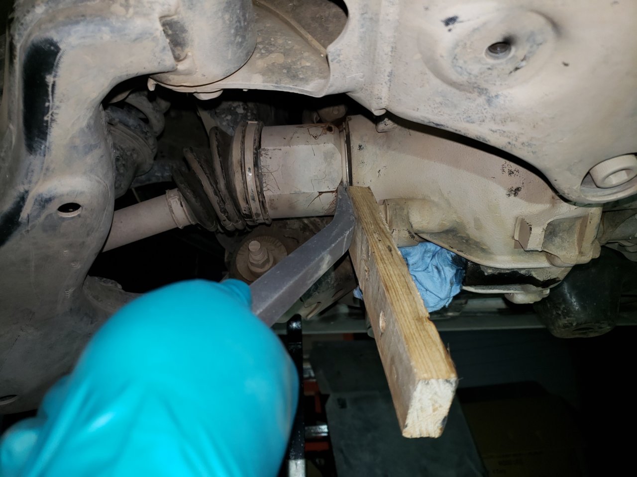

    How the heck do I remove the front axles from the diff housing?
    I think I have a bad needle bearing. I'm trying to replace it with the bushing. I have all the parts and the removal tool; I already removed the hub and knuckle, and I just need to pull the axle half-shaft assembly from the front diff.
    First I tried yanking it out with a slide hammer, pulling against one of the inboard shoulder lobes. Then I tried hammering it forward with a prybar, first against another of the inboard lobes, then against a more pronounced (but apparently flimsy) outboard shoulder where the boot attaches. Then I tried prying it out, levering against the remaining non-marred inner lobe shoulder with a 36" pry bar. A 1x2 pine spacer provided a perfect 3" fulcrum point, bearing against one of the factory diff bolts:
    When I threw my weight against it, the 1x2 split in half, then my prybar cammed out. Now all three axle lobes are dull, the inboard boot and axle seals are both completely fuc&ed, and I wish the goddamn sun would just explode.
    I have easily applied over 1000 lbs of axial force to this axle, and my blood pressure is probably off the charts. What the heck does it take to remove this axle???

    These are hard to get out because of the style of clip Toyota uses. If you read the threads, there is supposedly a "magic" clip position- rotate the axle if it doesn't come out and try again. I tried this and didn't have any luck. I used a piece of steel stock, .25 x 1 x ~12" long and had to beat the crap out of the inner CV using it and a hammer. I had no luck with a pry bar.

    if you rotate it a little and pry rotate and pry it will get to the sweet spot and pop right out. Like you I used to beat snatch and pull until i figured it out. Made me feel foolish.

    You guys were right. There is a sweet spot for the axle where it will pop out with a regular hammer. I went into 2WD and jacked up the opposite tire to be able to rotate the axle (pretty sure either works but I did both), then tried several more times.
    I did beat the living hell out of that axle though, so now I feel foolish for how easily it finally popped out. Hopefully I can just reboot it and replace the seals.

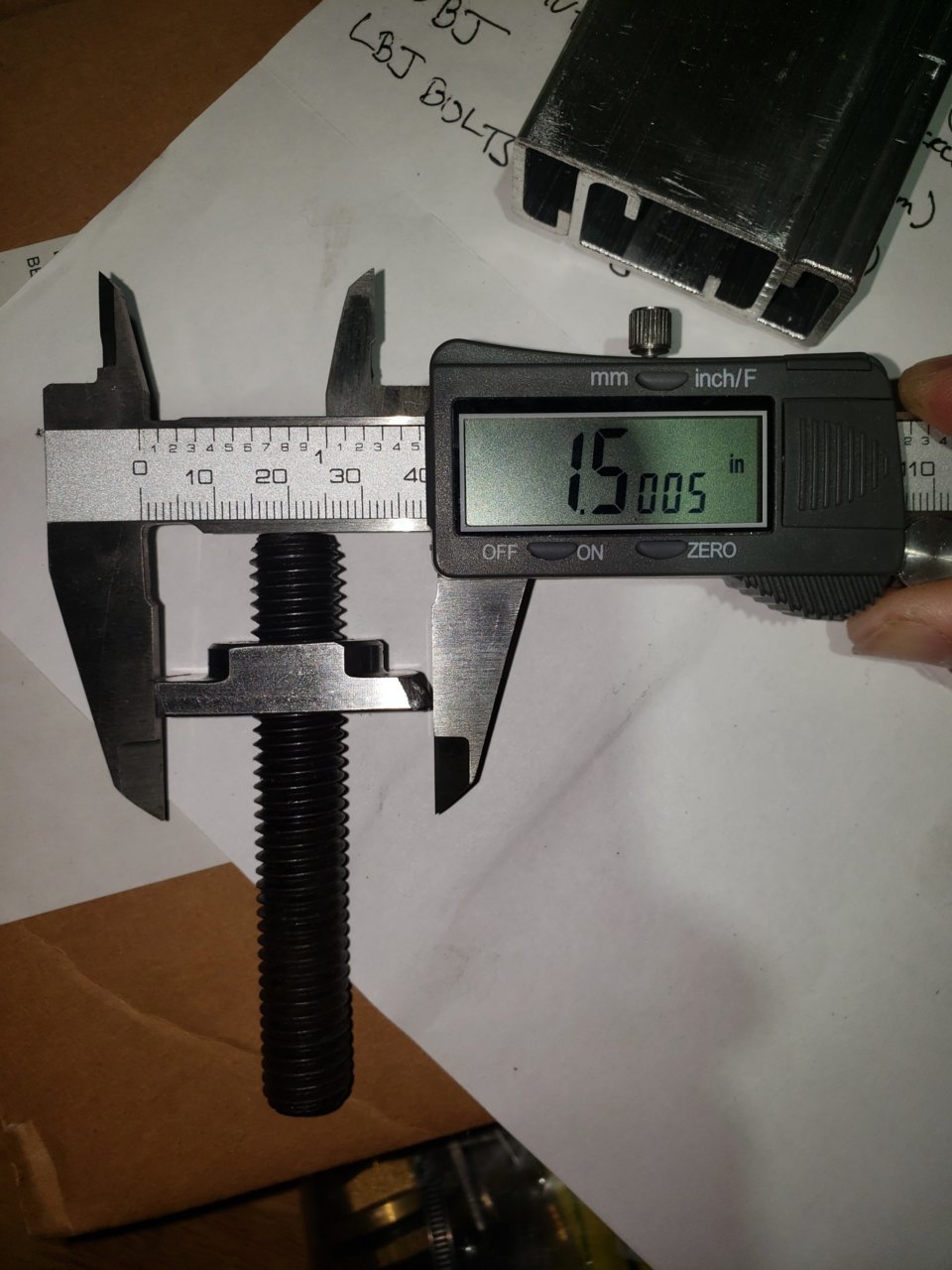

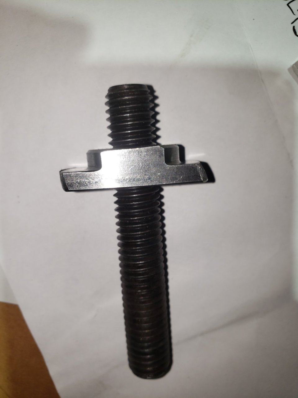

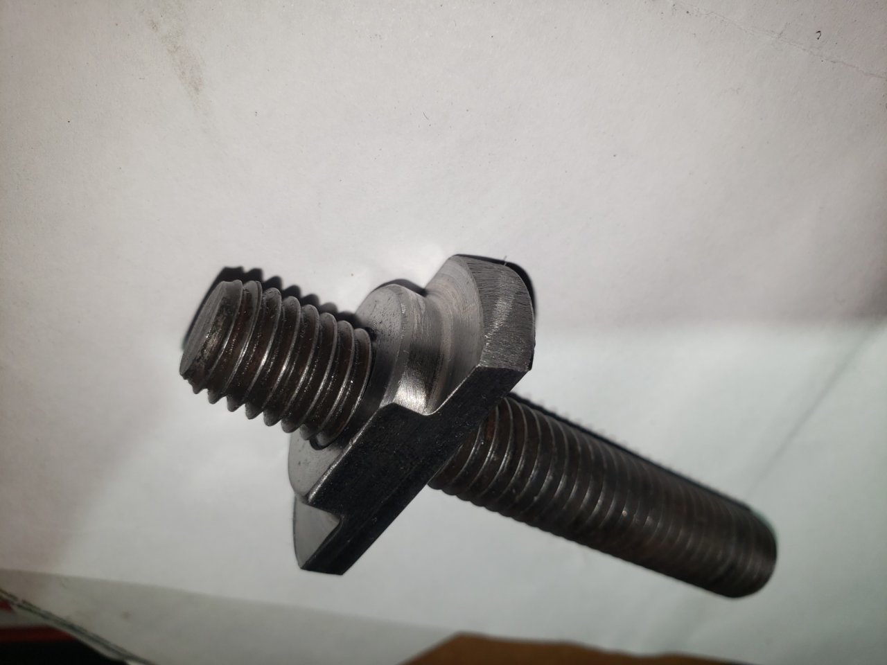

    Also, as a follow up rant:
    The ECGS tool completely sucks. Do not give them money for this bullshit tool.
    I just wasted another hour of my life grinding my brand-new ECGS tool, just to get it to work.
    This was not a minor touch-up adjustment. I easily removed over 1/8" from the OD of this tool, and still had to beat the shit out of it to fit it behind the needle bearing. Now it's too late to hammer in the new bushing and get this truck back on the road for tomorrow. Another day lost, this time due to an insanely overpriced single-use tool that is inexplicably, utterly incapable of performing its sole purpose.

    I'm not sure, but I think so. There just isn't much to grab onto behind the bearing. The slide hammer I rented had a 3-jaw puller assembly that could fit in there, but I would probably have needed to sharpen the jaws to really dig into the back lip of the bearing. However, I don't think you could ever hammer it out, it's really snug. So you would need a way to crank on it with a threaded rod against the diff housing. (I only used the slide hammer to pull the oil seal.)
    Honestly if you have basic tools in your garage I would suggest making your own puller vs. buying ECGS. Get a piece of maybe 1/4" x 3/4" steel, cut it to just over 1.5" long, drill and tap the middle, then grind it until it just slides past the bearing. You don't need the shoulder in the middle. ECGS uses a wider rod, but 3/8 threaded rod should do the job if you oil the threads. You can use a flat 3-hole unistrut bracket for the outer piece, nothing special there, and just a nut and washer on the outside. I have used 3/8" rod and unistrut stuff to press at least a dozen control arm bushings over the years.
    So yes, if you have a tap and drill, a hacksaw, and a grinder, then you can make your own tool for $10 worth of hardware store parts, or if you're like me, just from stuff already cluttering your garage. And it won't take you any more time than buying the ECGS tool, since that needs to be ground to size anyway!
