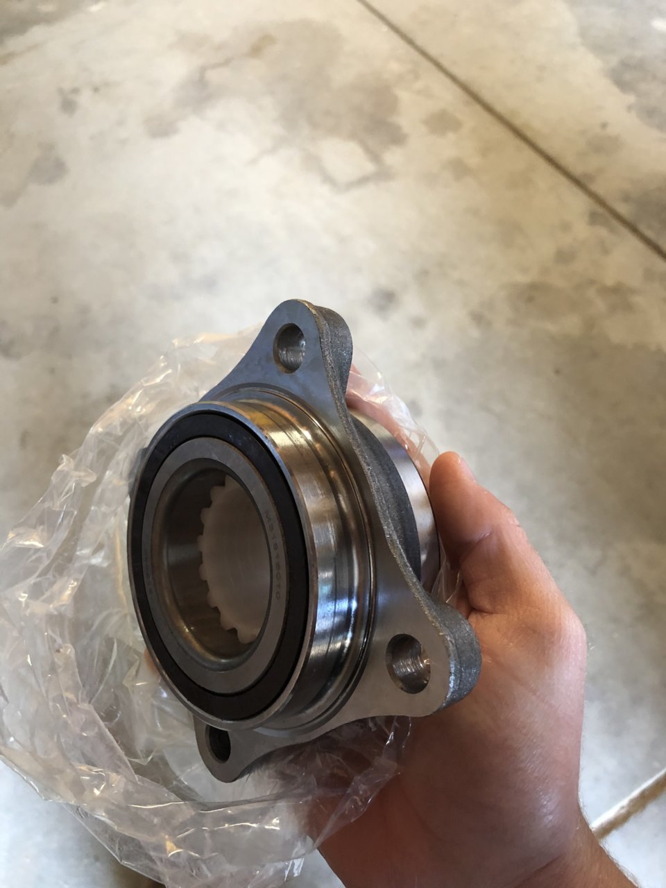

    85K miles, vibration in the pedal sometimes,rumble strip sort of noise when turning and just randomly off and on. Pretty sure it’s wheel bearing. I’ve seen a bunch of write ups and think I have the just of it and can turn a wrench pretty decent, I understand they need pressed off and new ones pressed on, but lost to which seals I need?? So far all I have are the bearings pictured. A how to simple rundown a dumb country boy could understand would be awesome!
    Thanks,
    Wyatt

    There’s no o ring or dust seal that goes with what I have? I guess I could tear it apart and find out,just trying to have minimal down time

    There are 3 seals(2 inners and 1 outer) and 1 O ring per side of the truck.

    I can’t right now, but 1 goes on the CV joint. 1 presses into the inside of the knuckle and 1 goes into the outside of the bearing.

    yes...i bought mine from toyota and the front seal behind the hub was already installed,maybe yours isnt...i cant see the front..the o ring around the bearing i just took off the old one and put it back together

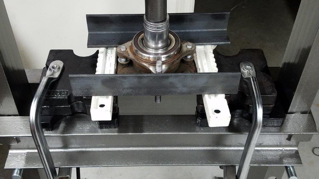

    There is an o-ring (dealer part) on the inside that seals to the knuckle and a seal (available aftermarket) that presses on the outside of the bearing assembly that seals to the hub. There is a seal inside the knuckle that seals to the CV/axle that you don't necessarily have to change- I don't unless I remove the axle or knuckle.
    It is a PITA to press off the hub- you'll need some 2x2x1/4 thick steel angle to fit under the bearing. The problem is that most cheap presses, like the HF models, don't have enough bed width for the hub to fit thru so you'll have to space the assembly above the bed. If you have a Napa, or similar nearby, maybe bring it to them to press apart. Pressing it back together is easy.
    Here is a pic that should explain the issue. You can see the o-ring and seal here if you look close.
