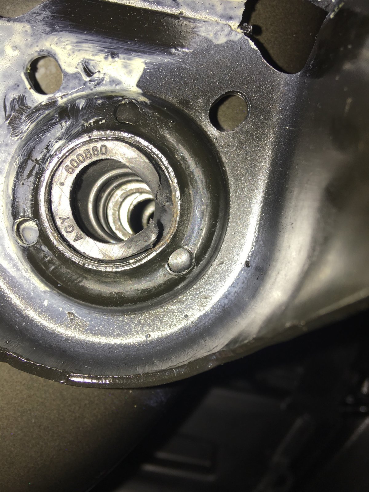

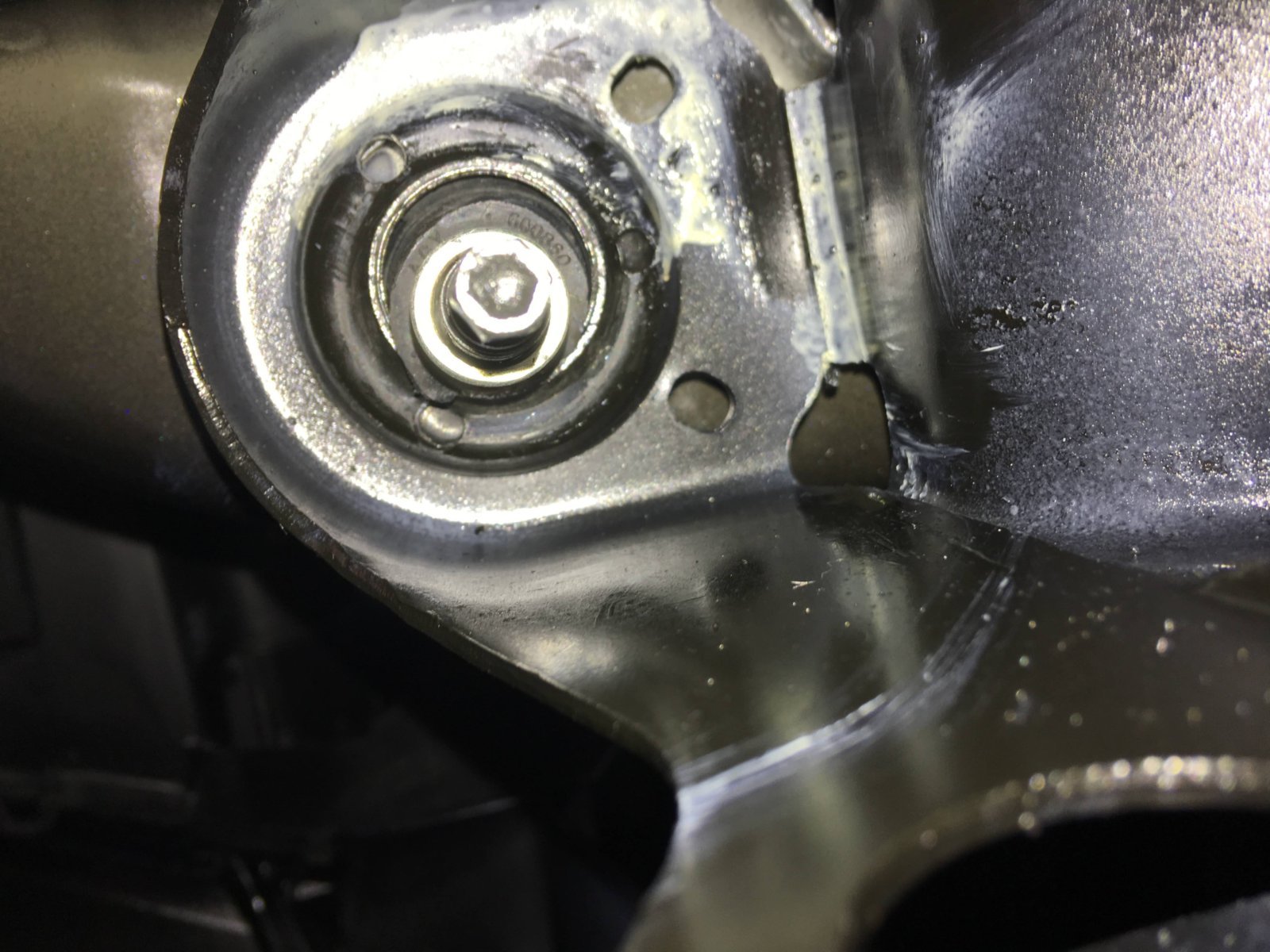

    Same exact issue. However the frame to body mount hole was not even close ligning up. I used a reamer to open the holes so that the bolt could be centered and not re tear the bushing.26662AC6-BE32-4272-8B9B-43EFE0754824.jpg 443E962C-D0A2-44BD-A9A7-253EE53AC464.jpg 26662AC6-BE32-4272-8B9B-43EFE0754824.jpg

    WTF!!! Mine is NOT noticeably misaligned but it squeaks / pops

    Yeah the creak was annoying which led me to the issue

    My photo doesnt really show how off the hole is. I had to ream the metal off towards the center of the vehicle to make things line up.
    If not it will wear out again. I thought about the other mounts and removing tension on them all to re allign things but i didnt want to change the body gaps. So removing the off part of material in the offending hole seemed less intrusive
