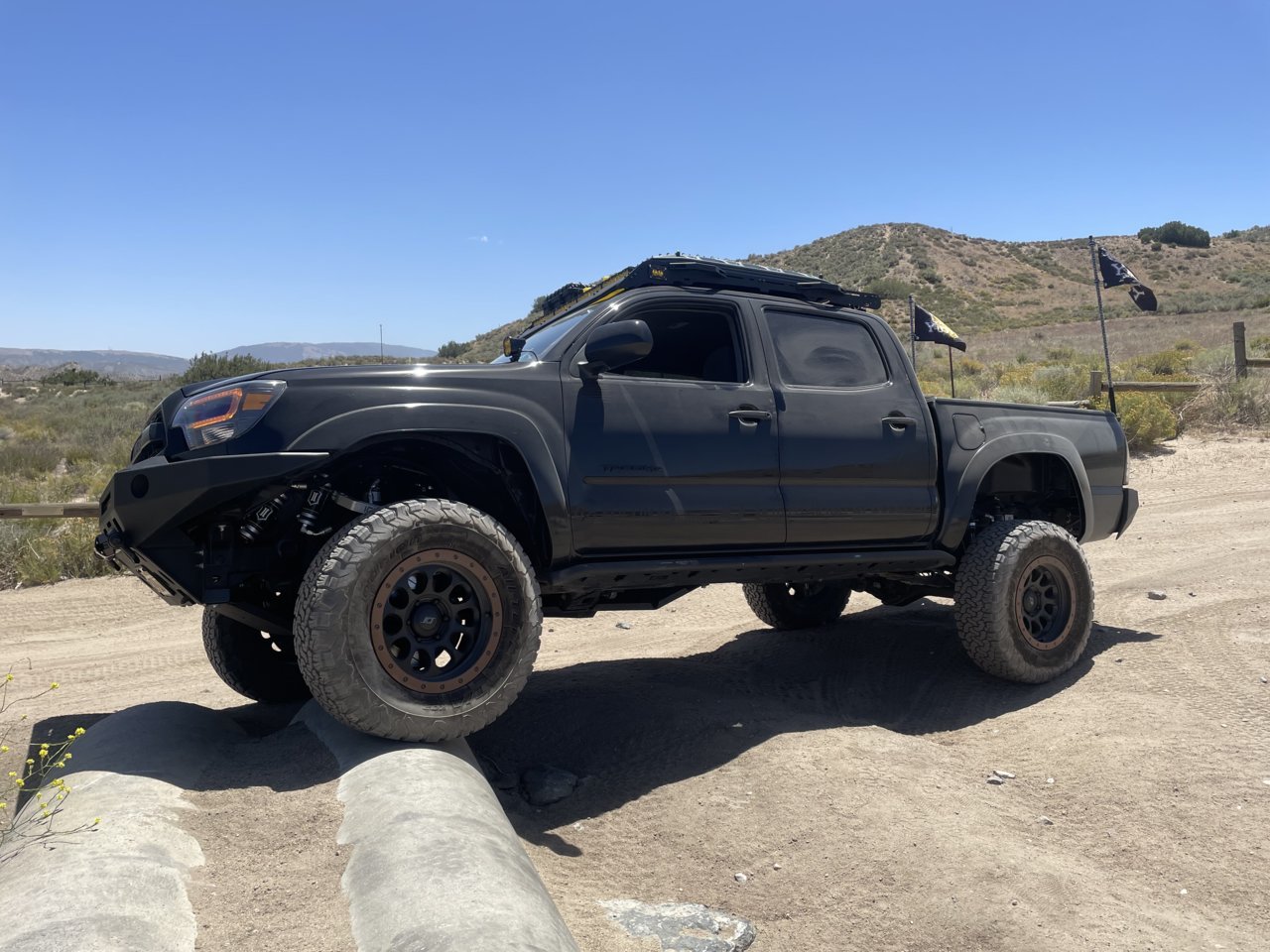

    I have been experiencing my front brakes locking up while off-roading. Yesterday I was at Hungry Valley OHV in Ca, for an amazing day of trail riding. I kept having my front brakes intermittently lock up while on the trail. For One or two seconds, they would literally lock and tires would slide. I know this is definitely not normal. It could be dangerous if this happened at just the wrong time. Anyone have any ideas what’s up with this?? I’d like to figure it out and obviously stop it from happening. Pics for attention

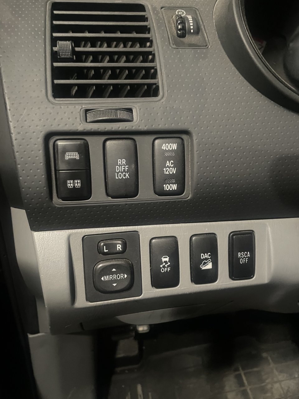

    Ok, curveball. My truck is a 2013 Baja edition. No VSC button. Now what??.

    You sure? Take a photo of the buttons to the bottom left of the steering wheel

    I think I got it now. The button that says off with the burnout tracks

    Yup that's it, give it a shot next time and let us know how it goes. Hopefully that's the cause as it's a simple fix

    I'm willing to bet large amounts of money that's what it was.
