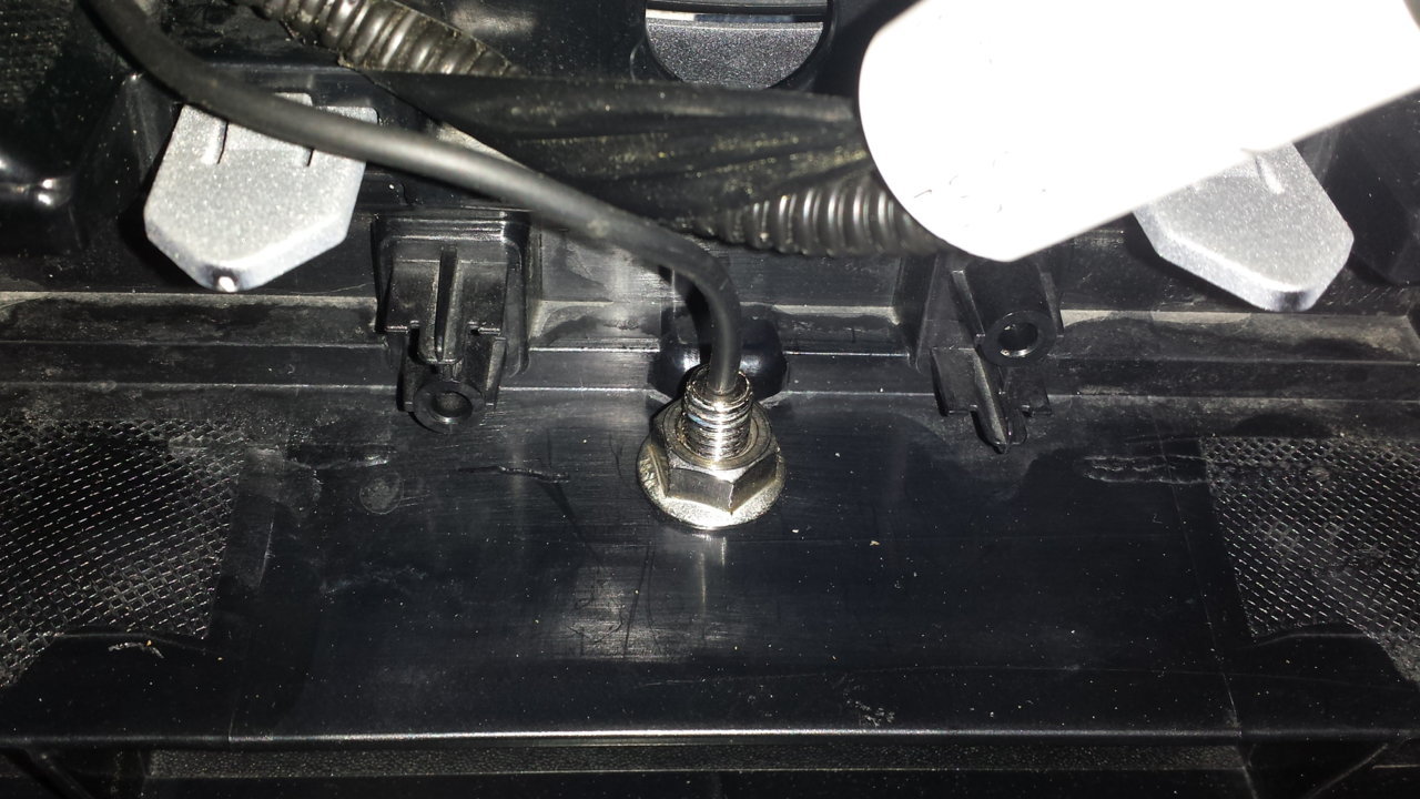

    I found a camera on Amazon that fits in the open space below the Emblem and centered on the grille. My OCD just would not let me mount it off center so I engineered a support plate and a back place to mount the camera on. I finished the anytime camera mod today and it turned out great.

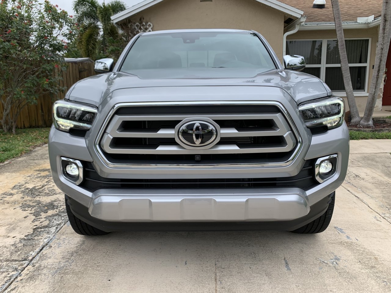

    This is a 2020 Limited grill. Notice where the camera is mounted.
    I have a 2020 SR grill that I have painted to color match my truck. My camera will then be mounted under the Toyota emblem, similar to the Limited above. Waiting for decent weather to complete.

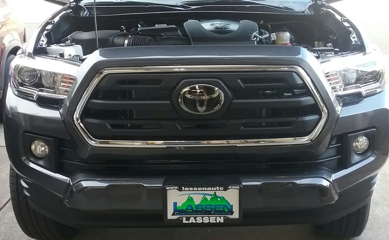

    I forgot to post a picture of the finished product.
    Edit: I mistakenly called my new grill an SR5. It is actually a SR grill. The difference is that the SR has a black bezel, and the SR5 has a chrome bezel.
    It's covered in pollen, but whadaya do?
    The camera is mounted below the Toyota logo.
