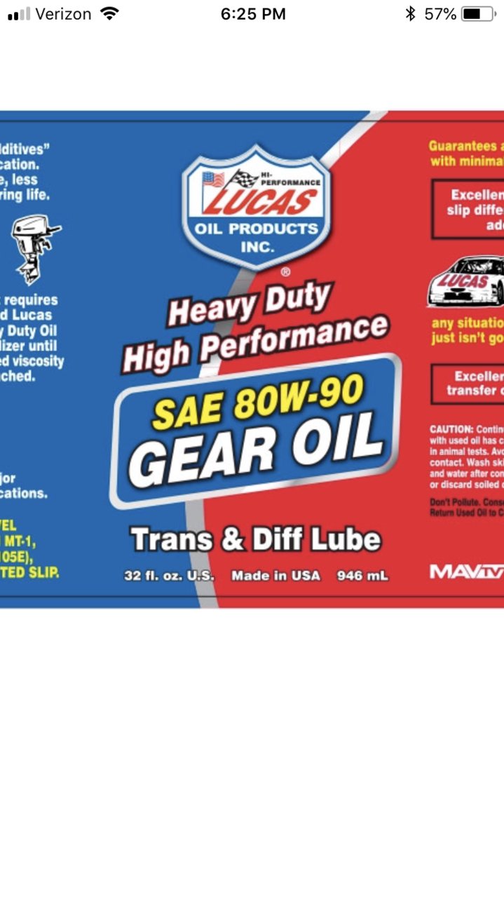

    I put the Lucas Oil one for like $13.99 a quart... Kinda worried I shoulda put LSD additive now, but can't find an answer on that...

    Read the bottle carefully, it might already have it

    Is this what you used by any chance?

    nah I put 75-90 but looks similar...

    Synthetics a waste in diffs.
    I answered your question earlier. No, you don't need it. Go get some Lucas dino 85w-140 and fill it up. Done.
