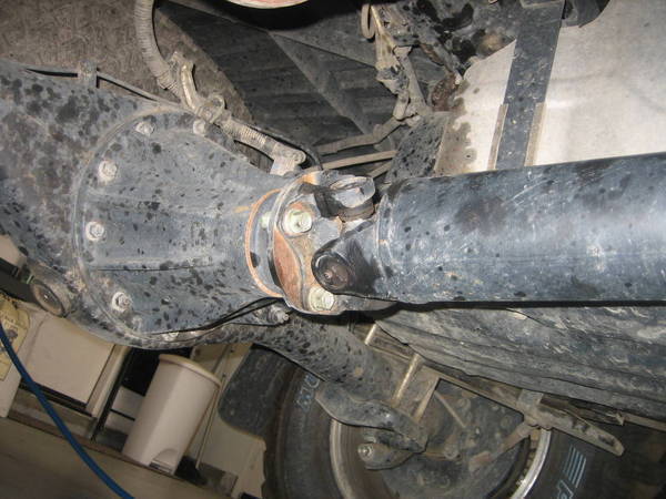

    If you have a chance would you mind crawling under and snapping a few pics of the location of the zerks? I want to finish this up http://www.tacomaworld.com/forum/4-cylinder/37648-complete-30k-maintenance.html

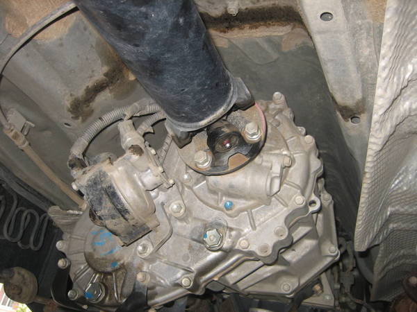

    Here are the pictures.
    Note the grease spray on the under side of the cab.
    This u-joint required 3 pumps of grease. You can see from the grease marks that most of the grease has come out and it is in need of grease.

    what type of grease are you using for the u joints? Are there 3 zerks?

    I used the Mobil 1 Synthetic (pink color). Yes are are zerks.
