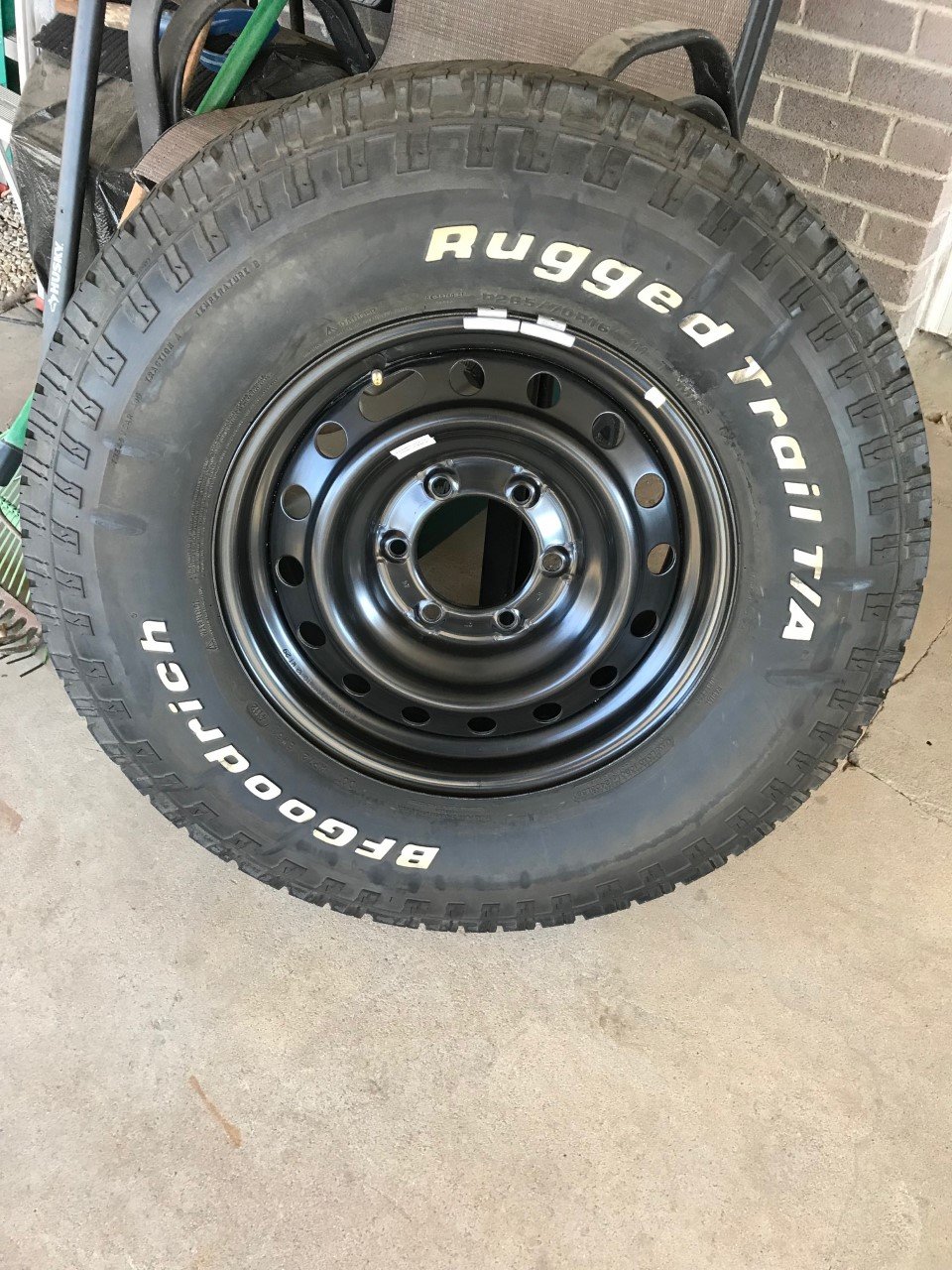

    I recently upgraded my 3rd gen from stock to 285/75/17’s ( BFG KO2’s). But I only purchased the 4 tires. I’m realizing now I should have a full size to get get off a trail and drive on while I replace my tire. Is there a cheap donut type option for this or do I need to purchase another KO2?

    Tacospike
    Nov 19, 2018
    #273198
    14,418
    512
    Two Trucks

    just get a 16in wild p that is the same height as the 17in tire

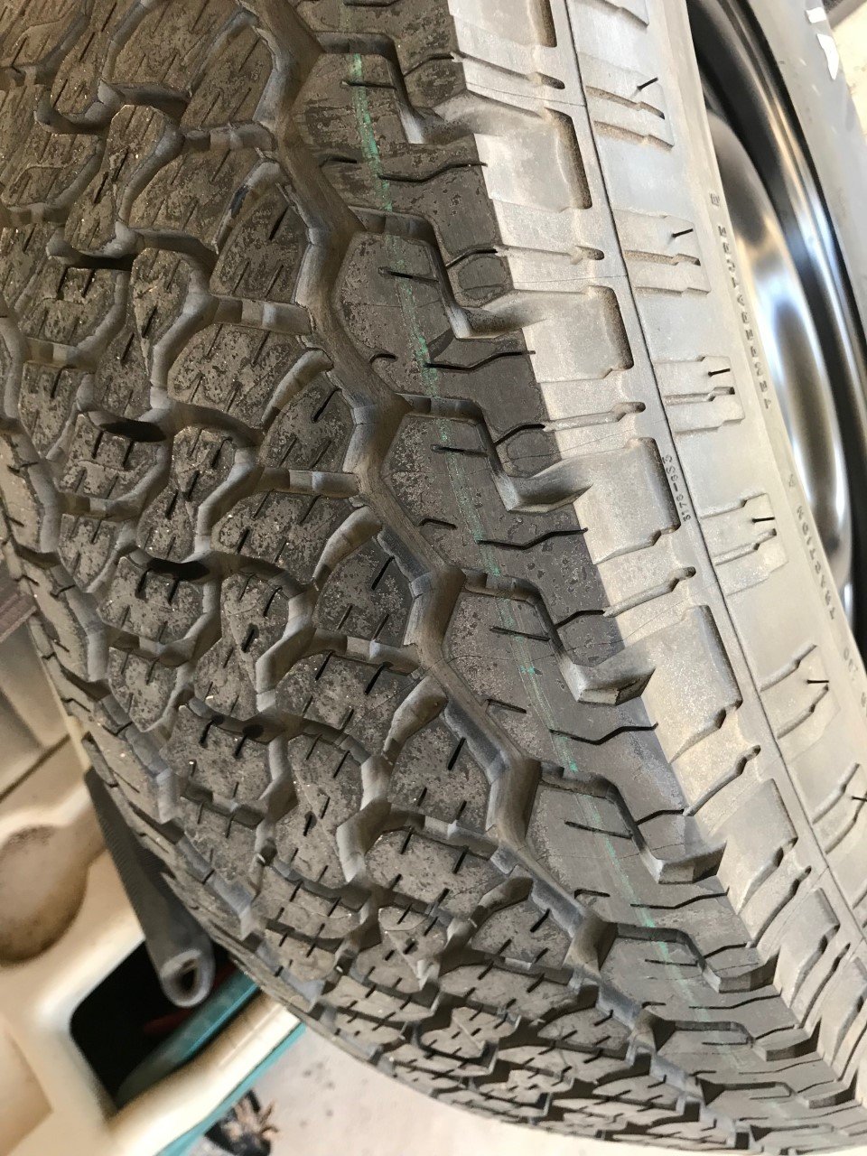

    a fb marketplace find for 40$
    I just throw it in the back if going offroad

    Yeah, funny to worry about the wheel size for a spare. Like you said height and diameter is what matters most. I'd get an AT tire as well if you're off-roading a lot. Don't want to try and get out of some rugged remote area with a freeway spare on, even if it's the right diameter.
