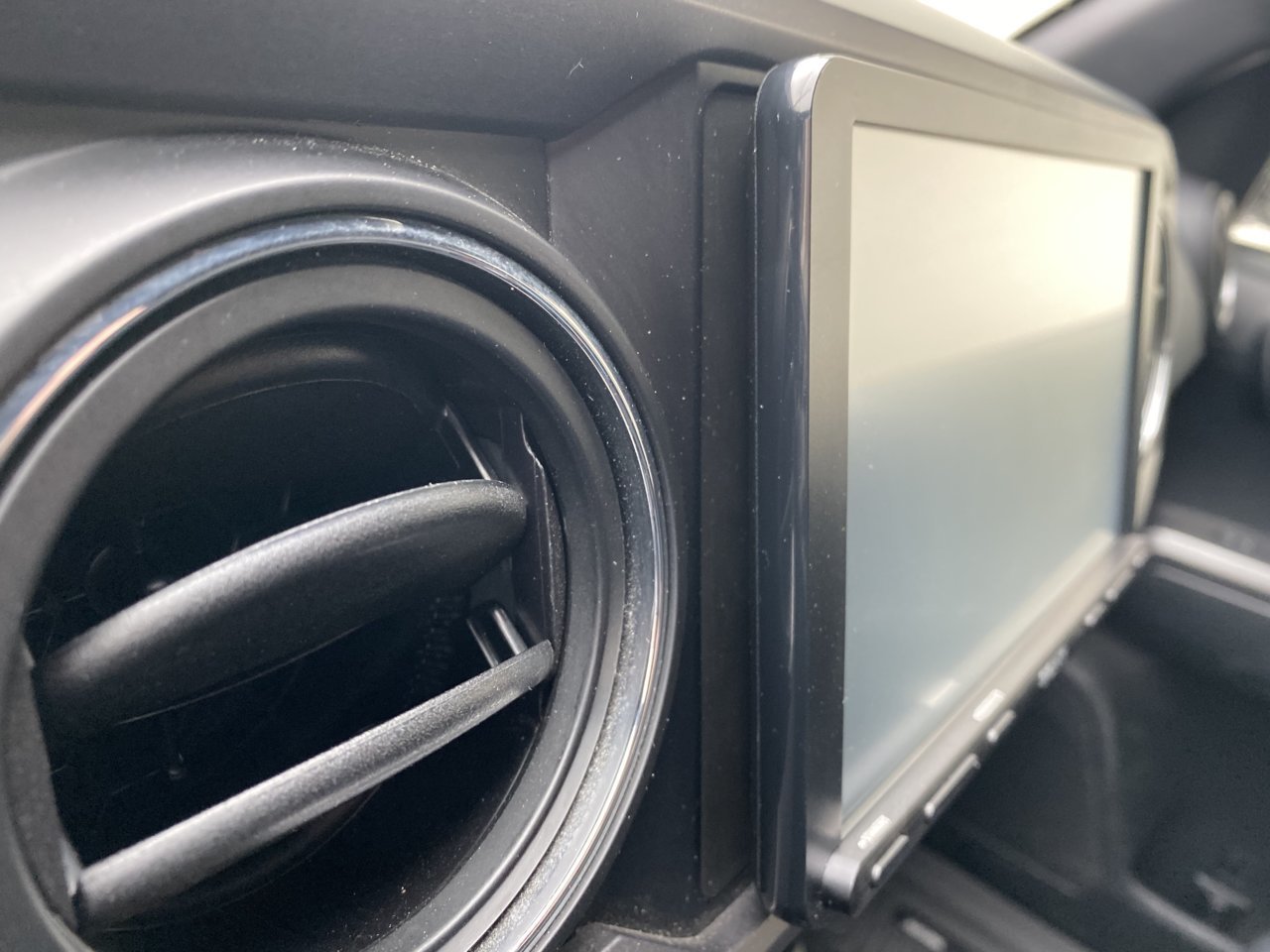

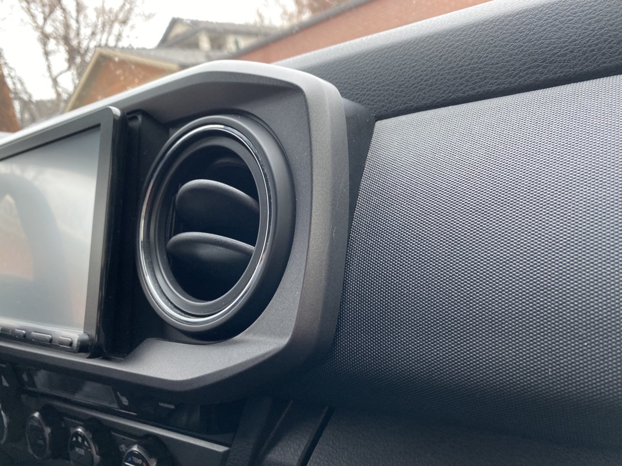

    Picked up the $599 Sony AX8000 with hopes it would fit and look a little nicer than the Alpine Halo9... Good news is size/shape of the Sony is nearly identical in size to the factory radio opening. With some minor work (drilling 2 small holes, cutting metra dash kit) it fits nice and flat against the dash. Potentially could be flush mounted like the factory unit with more custom work done to the radio bezel... depth would be the question.
    Steering wheel controls and OEM backup camera work just fine with the Maestro RR installed.

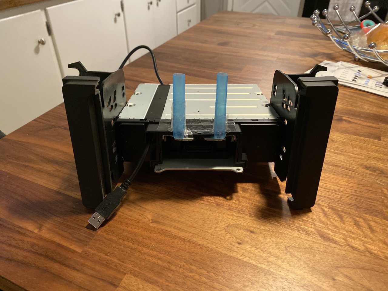

    If you want the AX8000 to sit flat against the dash- you will have to do a little bit of work...
    Using the regular Metra dash kit- I cut the left and right sides off and notched where necessary to clear the rear of screen enclosure. These side pieces only serve to fill in the small gap behind the unit on the left and right sides and are in no way structural to the screen/unit mount.
    I have mounted the single din control/brain unit as far back as possible in the dash, drilling new holes in the metra mount where needed.

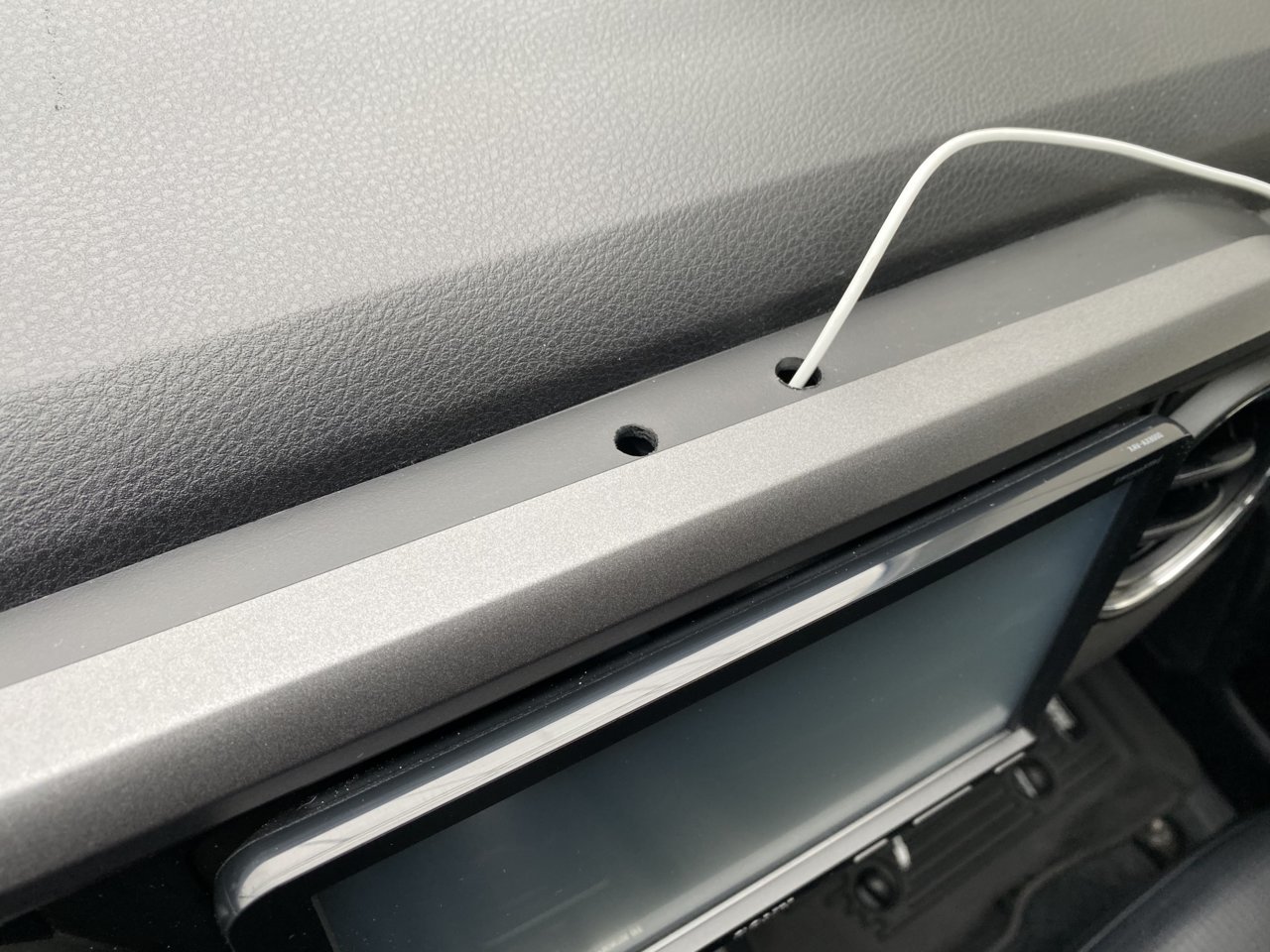

    The challenge now is how to access the 2 screws that secure the screen to the control unit. I taped 2 large straws to the control units top screw openings and drilled 2 small holes on top of the radio trim bezel/panel. Its ugly- but it works. This helps keep the screws from being lost when installing or removing. I will be picking up small rubber grommets/plugs to clean up the holes, and one hole will serve as access for my iPhone cable to my Taco Garage DSM phone mount.

    Man that looks like its SOOOOOO close to fitting inside the bezel with minor trimming.

    Its very very close. Minor trimming/sanding and some fill on the left/right side and it would fit in the opening, but dash depth might be an issue. I think with some work it could fit nicely, might need a right angle on the backup camera plug and definitely have to remove to white plastic wire protector behind the dash. The Sony has multiple height options for mounting the screen vs brain, so I think it can be done flush with dash.
    I'm tempted to custom fit it eventually... but its working well and not bugging me... yet.

    Im routing it out the top of the dash bezel and over a few inches to a Taco Garage DSM single ball mount
