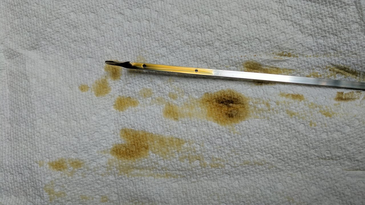

    Pennzoil Ultra Platinum was second, I used it in my previous Tacoma, a 2008 V6 DC Auto 6FT bed. It ran great even with cold startups with 278,000 km on the clock.
    Pennzoil claims it cleans out you engine, so I did the first oil change to Pennzoil Ultra Platinum, the oil was clear and hard to see on the dipstick, however I was surprised when the dipstick looked like this after only 1000km, so there might be some truth in it
    For MT gear oil I still recommend Redline MT-90

    maybe thats why my oil is pitch black at only 5k

    With Ultra Platinum I heard the difference on cold mornings when the valve noise went away sooner, and it removes the varnish from the inside
