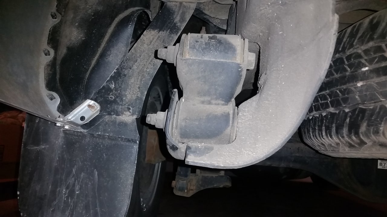

    I was going to install Roadmaster Active Suspension helper springs (model MK4 - XEDSAT) since we have a topper on the back and will be hauling around 4-600 additional lbs most of the time. (freaking loading a couple dogs in the bed I feel the tail end sag down for cryin out loud, so unassisted leafs is def a no-go).
    All my research says these are the best and are used in commercial/fleet applications.

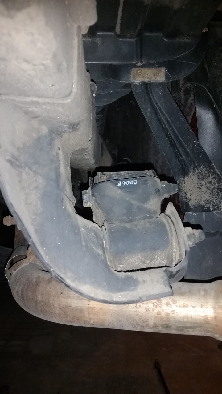

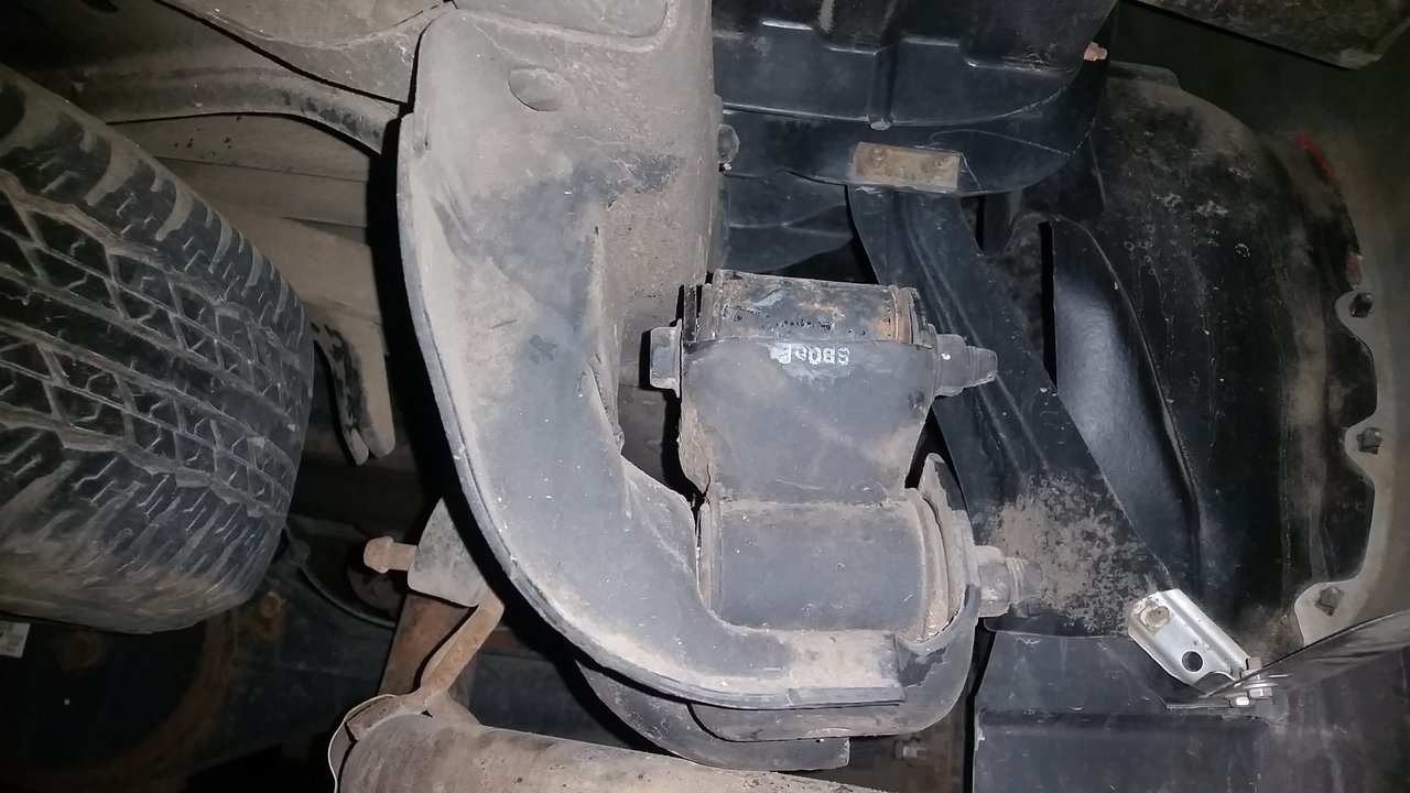

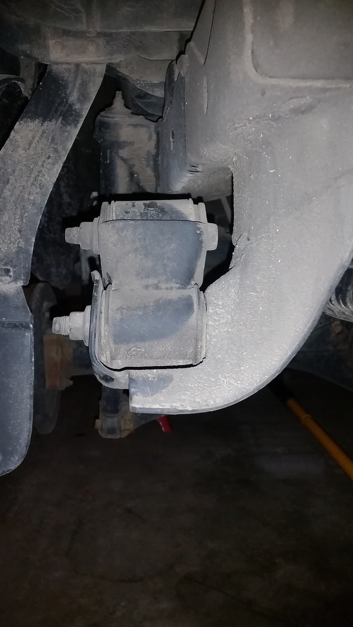

    So im starting to tension these down and something just isnt right. I start taking a look at the rear leaf spring mount (Where the shackle mounts to the frame) and it looks bent as a mofo !
    I took the helper kit off and driving it around stock atm.
    Right side appears to be much worse than the left
    Attaching some pics (plain stock w/o any helper springs/aftermarket stuff) to see what yall think, and what can be done!?!

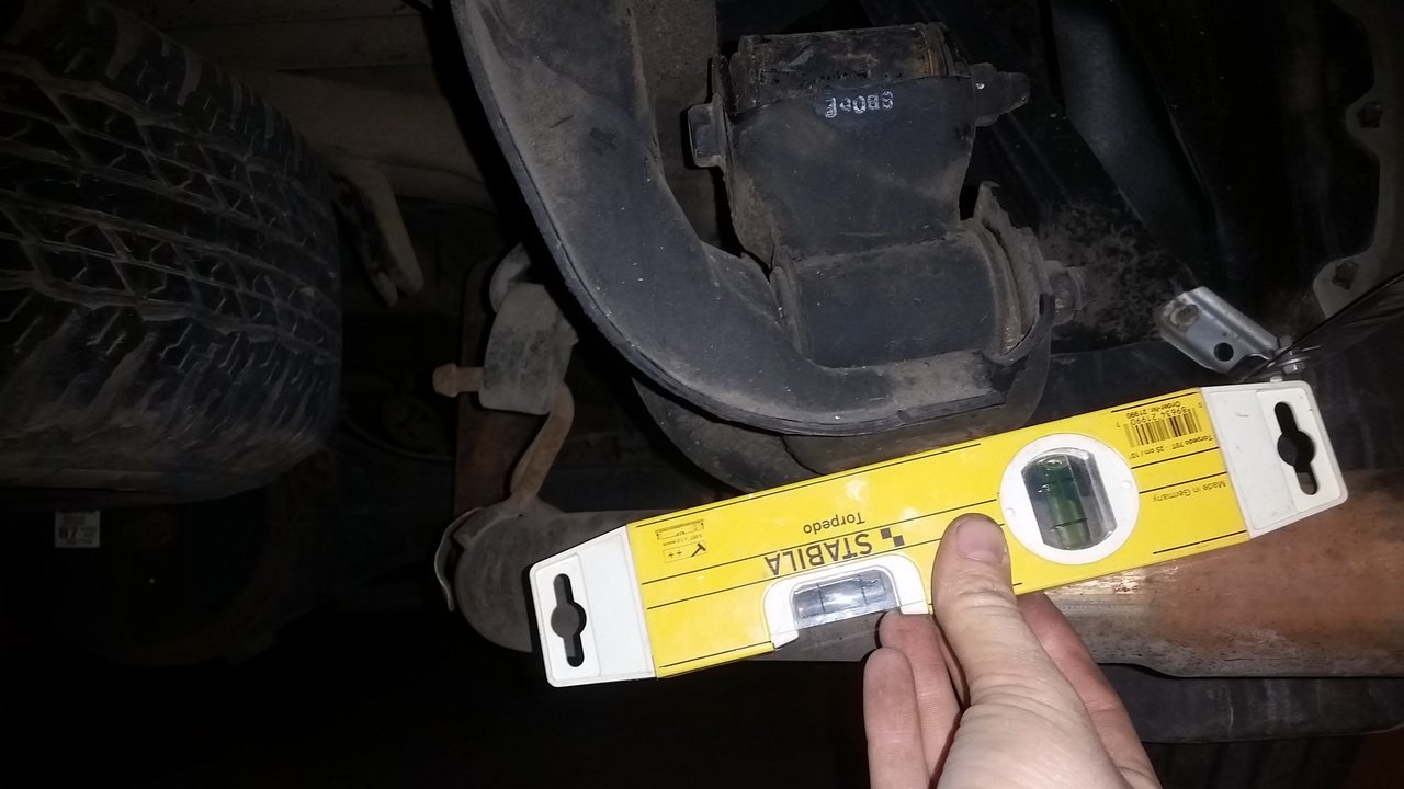

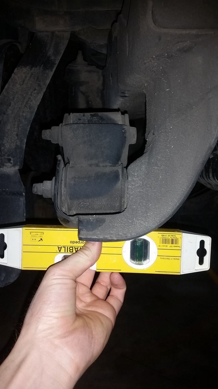

    note- the leaf wants to sit level, the mount appears to be bent crooked, and the shackle/bushing seem to be accounting for the massive angle difference
    left 01.jpg left 02.jpg left level.jpg right 01.jpg right 02.jpg right level.jpg
    That last pic with the level really tells the tale.

    I don't know if the level is the right tool unless you zero it so that the frame really is level, but I get what you're trying to show. It's not unheard of to bend the shackle hanger but I think it's usually from dragging it over rocks.
    But if yours are bent from perhaps just the constant load beating them up, BAMF and @JLee have your solution.
    https://www.tacomaworld.com/threads/hd-shackle-hangers.496200/

    does not appear to have struck anything from below.
    rear bumper is also bent down, so suspecting the prior owner put WAY TO MUCH weight on it an one point and effed it up.
    the level was all I had, and yeah not super effective, but more for just eyeballing how bent it was, and comparing to the other side.
    man, they don't give them away do they?
    I will research these further. Thanks!
    anyone install these? level of difficulty?
    Important question: WILL THESE (BAMF hangers) WORK FOR THE 5 LUG FRAME? (non prerunner non 4x4) I would like it to be as close to stock as possible...
