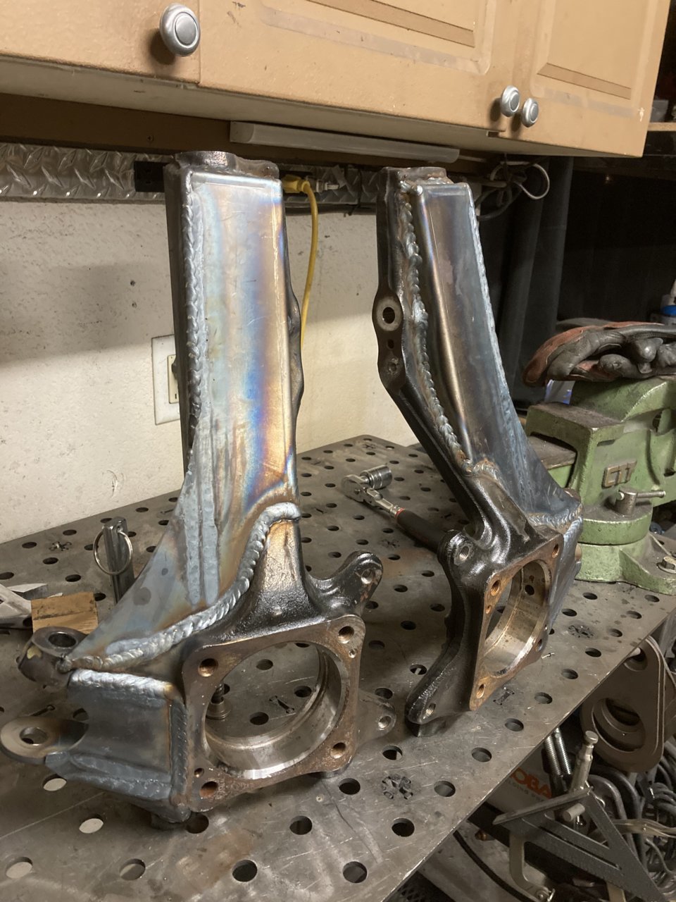

    Figure I'd post in here for fun. Over the years building wheelers I have always just used my fathers or works welders. Finally bought my first welder, and actually went the cheap route with the Harbor Freight titanium 140. Got it for $325 with a warranty, and can definitely tell the difference between it and a top of the line production welder like I used to use. But, it works pretty dang good for the money. Fine for most things I'm doing on my truck, as the max I'm usually welding is 1/4". So far I've ran this thing cranked to the max, and it hasnt skipped a beat. Gun feels a little flimsy though, so if it ever breaks/wears out, I'll just warranty the beotch :rofl:
    Figured I'd just throw it out there for the people on a budget, since its half price of the same Miller/Lincoln.
    Spindle guessets the other day:

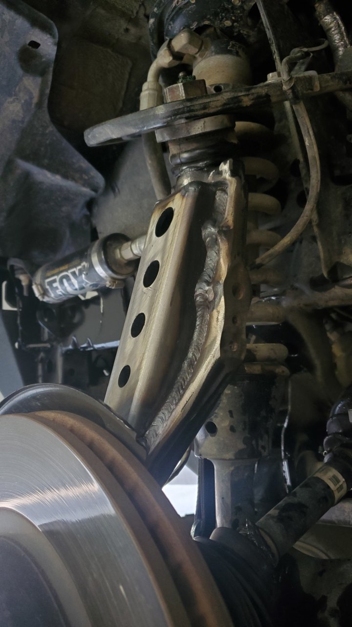

    Looking good. Next time check out the JD Fab spindle gussets. Best fitting and best design gussets I’ve done of the few mfg’s I’ve tried. Had the heat a little high for the open corner welds but meh, these babies are solid

    Yeah I looked into those but a buddy had the Tc ones laying around! Still need to add a guesset to the tie rod like the Jd fabs so I dont get the infamous crack near the wheel bearing

    Hard to justify when he already had them laying around. But easy enough to ad a piece to gussets the tie rod. This is the second set of theirs I’ve done, first set was for me, and they’ve got the design dialed. And my truck has taken a ton of abuse since freshening up the front end last year and still straight and holding strong

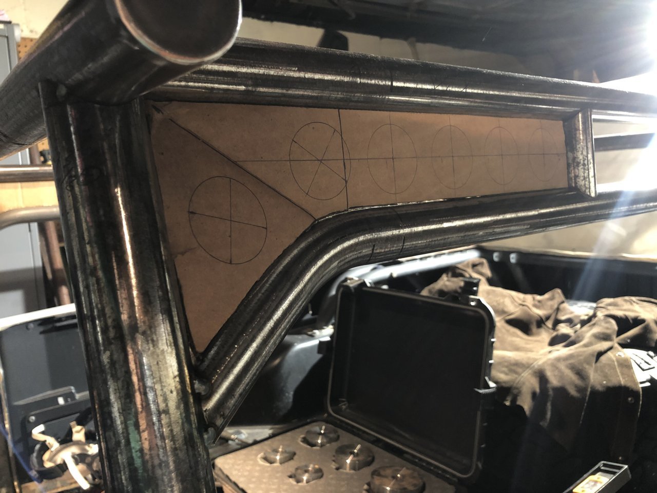

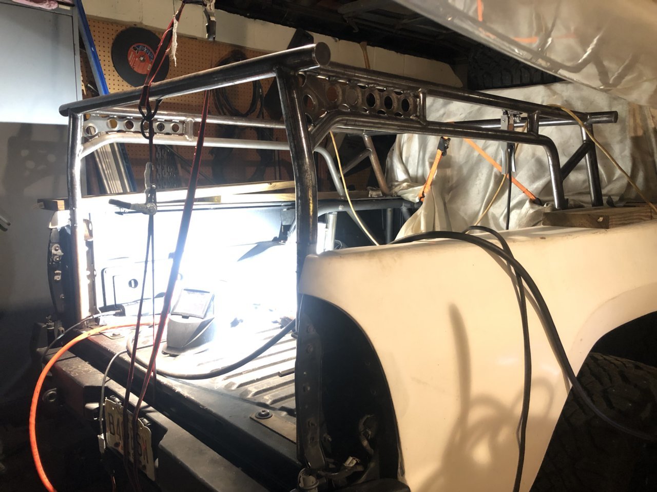

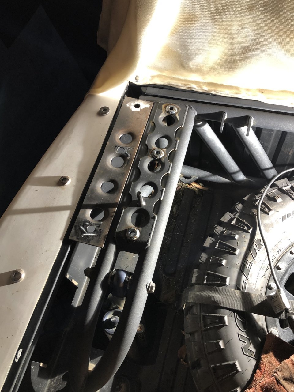

    Fun project. Wanted a removable bed rack for a Superlite. I started contemplating this concept when I was building the bed cage. Uses the bed cage and bedside stiffeners as a base.
    Very pleased that my couplings slide together perfectly after welding everything and that I didn’t accidentally weld them together :thumbsup:
    A tire carrier is in the works, but has to take the back seat to supercharger install…
