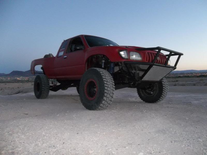

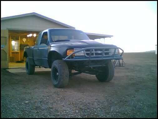

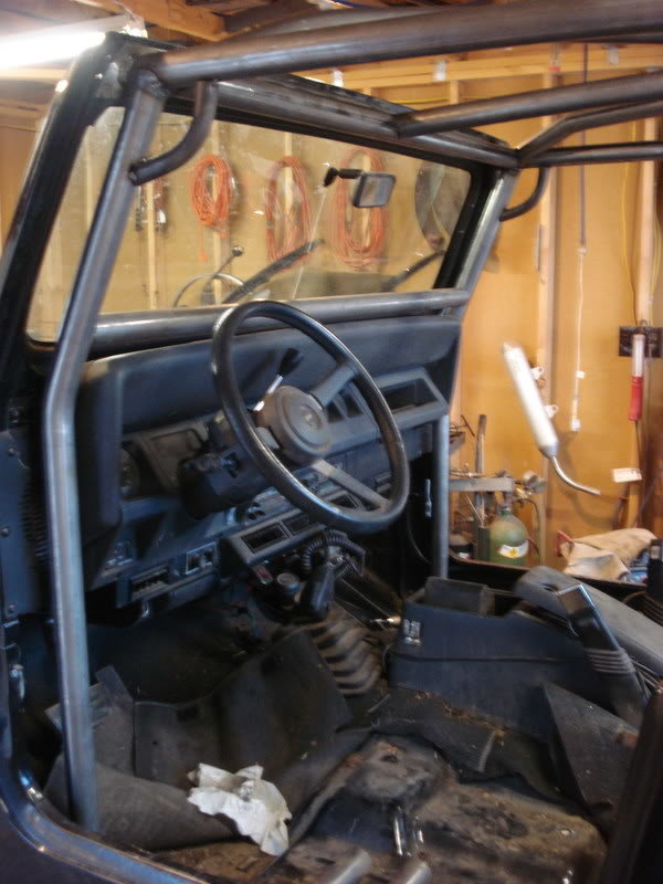

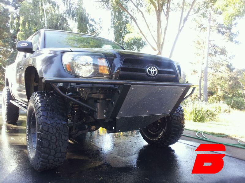

    I've got the JD2 bender also... I've done a bit of work with it over the years all pulling on it by hand. Summer is the best when you have to wear welding gloves to use it cause it's 110+ degrees outside and I'm working in the sun.

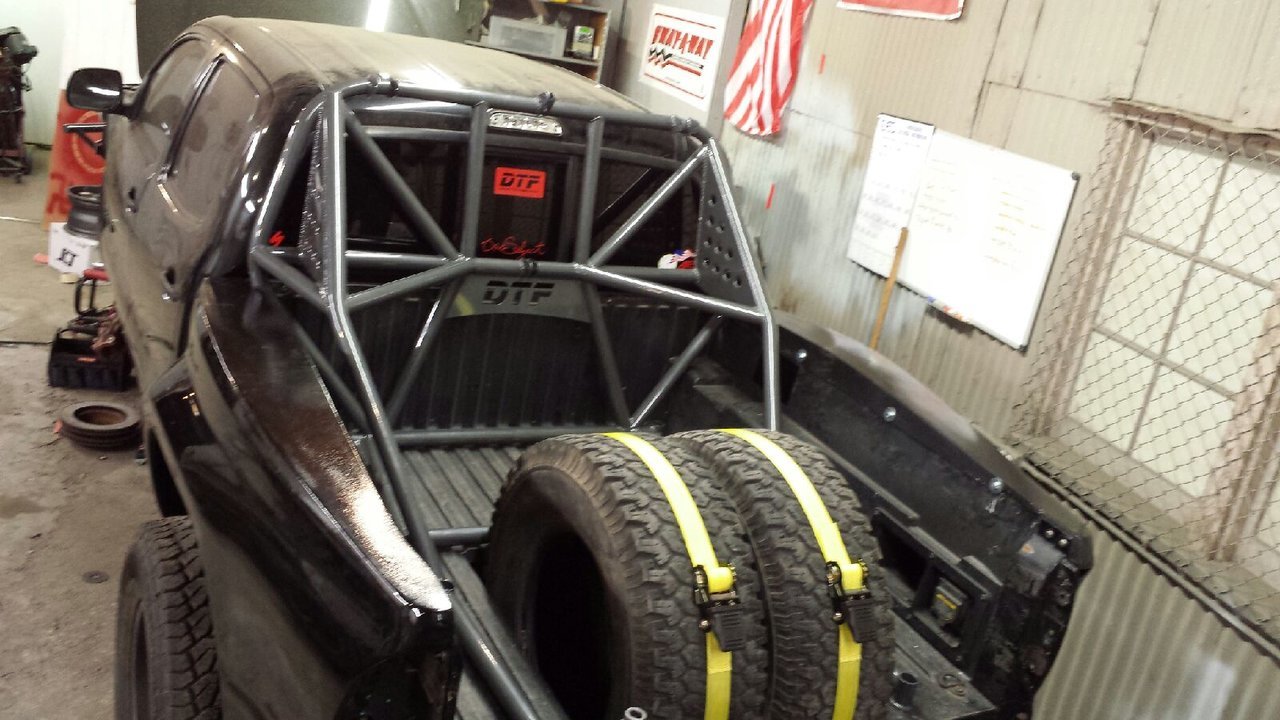

    Couple of small bumper to bumper builds...

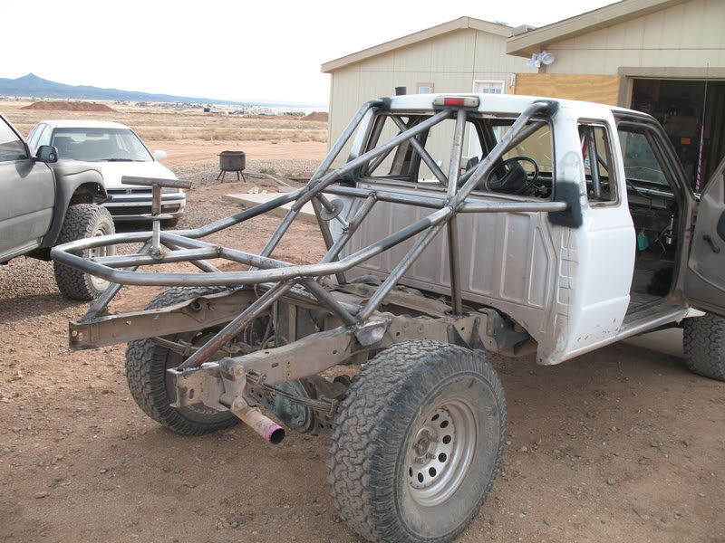

    One of the lesser known trucks I built... (not finished in this picture but you get the idea...)

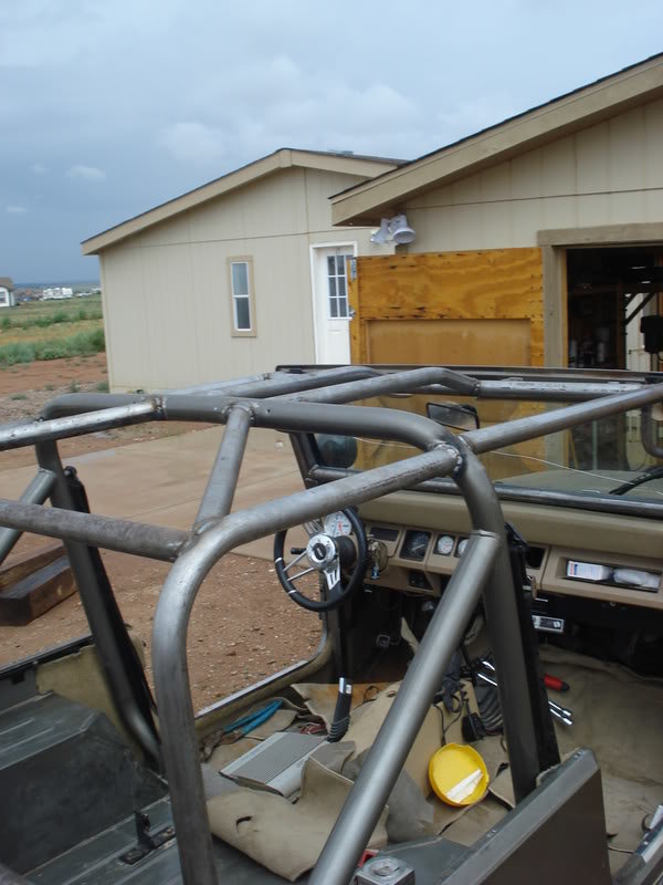

    Jeep stuff

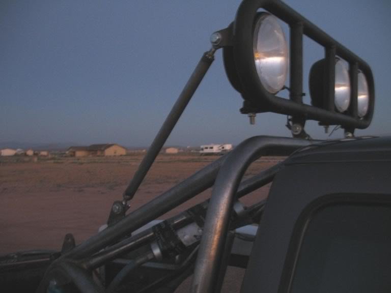

    Fugly bumper but I built it exactly as the kid wanted!!! I don't always like everything I've built but I try to build exactly what the friend or owner wants, not what I want...
    Point being, manual benders work great, you just gotta earn it on occasion! Those 180 degree bends kinda suck! LOL
